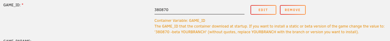

Project Zomboid Docker by ich777 update to b41 beta
Hi, I am trying to update the server to 41.61 (the new b41 beta) but I am having trouble doing so. I think the easiest way is to copy the game files from my steam directory on my personal pc to the server directory but I dont know where the files are and where to copy them to.
I have tried to do it via steamCMD but I cannot even log into steamCMD from the docker menu with anonymous, it fails on username.
Any help would be appreciated!
Thanks
Edited by CaptainTrap
Please start from scratch so you don't have to validate the files, you also don't have to put in Steam credentials just enter this in at the GAME_ID:
380870 -beta b41multiplayer
Also mentioned here (description):
If you switch over from the default game you have to turn on validation:
No this is not easier and could lead to various other issues.
Please don't put Steam credentials in for ProjectZomboid, they are not needed and this could also lead to various issues if you put them in.
Please don't do this, you will most likely mess up the whole installation.

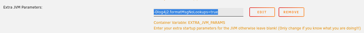

Any security concerns regarding log4j and your Minecraft Container?
If you are not already on 1.18.1 no, otherwise yes, see here: Click
If you need to enter special JVM parameters do it in the template like so:
@ich777
Apache released l4j 2.16 as the special env var does not work and yesterday they released 2.17 because of another DoS hole. So the information on the official minecraft website is outdated. Only an update to the most recent version helps.
As I'm using a custom paper server I downloaded the most recent version from here, which contains the most recent l4j:
But I'm still waiting a few days until my server gets public access again.
Technically that's not the whole story in terms for Minecraft, it is working but also depends on the Minecraft version you are on because they use their own "proprietary" libraries (find them in your minecraft folder in you appdata directory in libraries).
Exactly if you are running the latest available version from the game it should not be exploitable.
