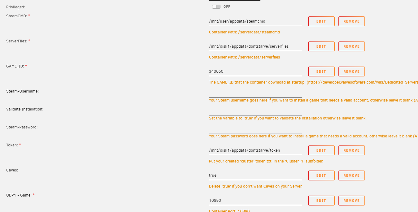

Anyone Know how to setup the DST Server, i have followed the instructions but it just loops in the logs with a error unable to find main.lua. and some other errors.
I can't reproduce this error: DST.log.txt
The dedicated server starts just fine on my server, haven't created a token but it starts fine anyways and this shouldn't be necessary.
Do you have a Cache drive installed? If not make sure that your server doesn't split the game files across multiple disks.
If you have a Cache drive installed make sure to set the appdata share in terms of "Use Cache" in the Share settings to "Only" or "Prefer".

mmmm, i dont have a cache drive how can i tell if its splitting it over multiple disks. if it helps is is the settings used.
Usually it should not when set to disk1.
You can go to the main tab and see if you appdata folder is spread across multiple disks.
You could also define that your appdata share is only used by disk1 or whatever but keep in mind that you have to change the path im the template depending where the files are.
Some games have huge issues if you define /mnt/user/... instead of the real path.

okay ill try setting steamCMD to Disk1 as well iv just removed all files and redownloading it. hopefully  this will work.
Yes my appdata is so by adding disk1 should this resolve the problem?
