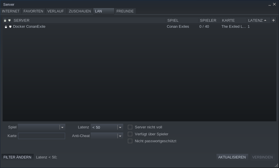

I can't reproduce this on my server, here is the log from a fresh pulled container from the CA App: conanexiles.log
And here a screenshot form the Steam Server Browser where you can see that the container is running and reachable:

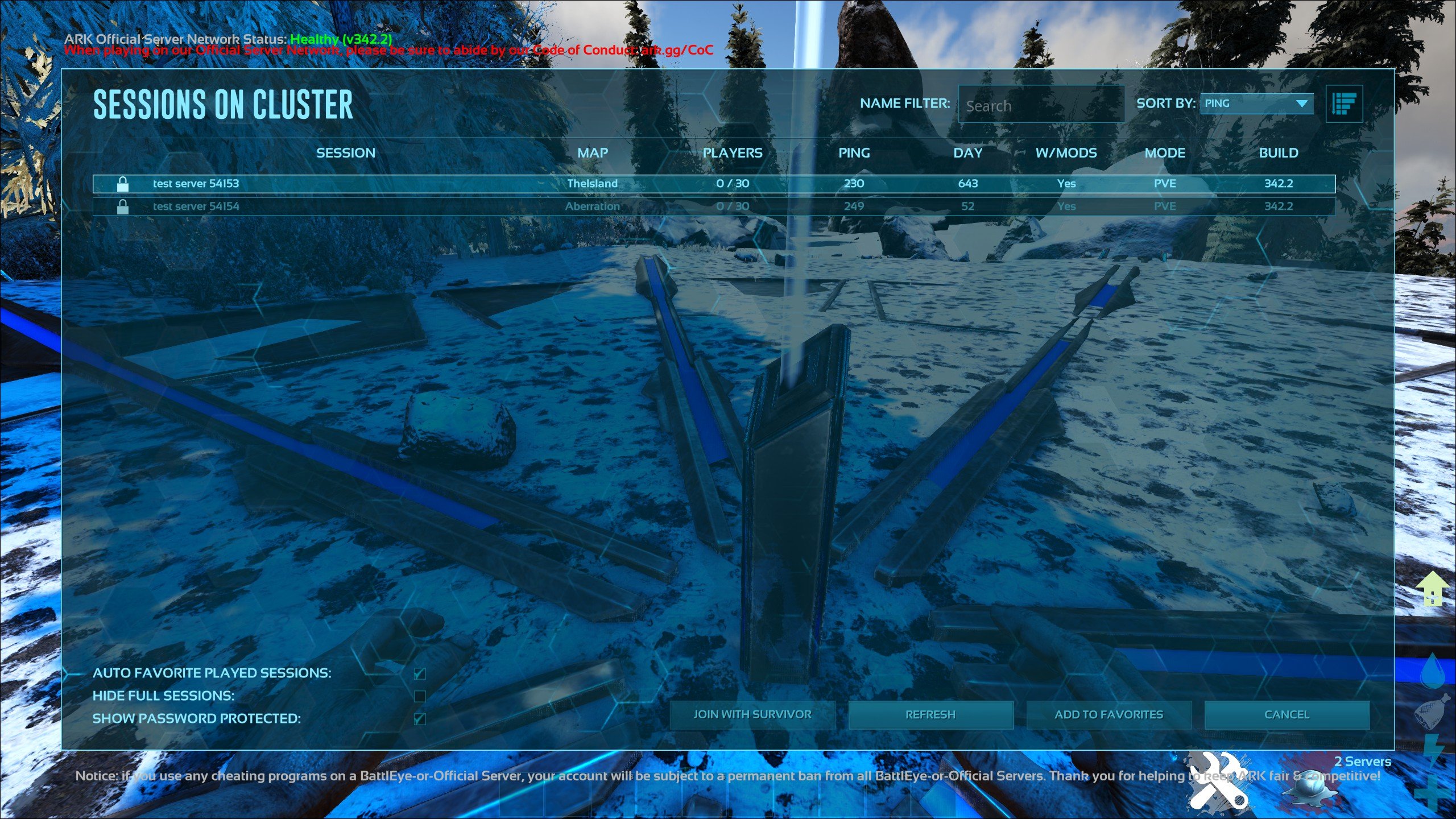

I have been working on reading through the forums for quite a bit here and can't seem to find the answer.  Can someone point me in the right direction for a single Ark server.  I see the stickied Cluster info.
I can see my server and connect to it locally no problem but my friend cannot connect externally.
1.   What are the specific ports to be forwarded and connection type?
2.  How should a friend be trying to connect to my game from steam?
3.  Can i test my own connect-ability by adding my external IP address and a port to my server list on steam (clicking view, then servers, then adding it by my external ip and port? 7777? 27015?
The ports i have forwarded at this time after reading the forums are 7777,7778,27015 UDP only, and 27020 TCIP.  But i did leave in 27016 UDP only.
Why is IppoKun talking about 26900?  in the post above, did i completely miss that port?
Thanks in advance and sorry if this is clearly spelled out in this thread already?
The ports that you see in the template otherwise the container won't work in your local network (the RCON port is optional):
Either trough your public IP, domain name or on the server list (keep in mind if you try to connect through the in game server list all check boxes and options have to be checked correctly, otherwise your server won't be displayed in the list).
Yes with an if...
If your NAT reflection is working properly you can do that, otherwise you won't be able to connect internally to your public IP.
It would be better to create a hotspot with your mobile phone connect a laptop or another computer to that and try if you can get a connection through the Steam Server Browser (if you try it through the Steam Server browser your should use YOURpublicIP:27015).

14 minutes ago, FrozenGamer said:
Edit: it doesn't show up on the serverbrowser with myip:27015
Are you sure that your ISP is not blocking any ports or you are behind a NAT from your ISP?
Do you have other services exposed to the internet?

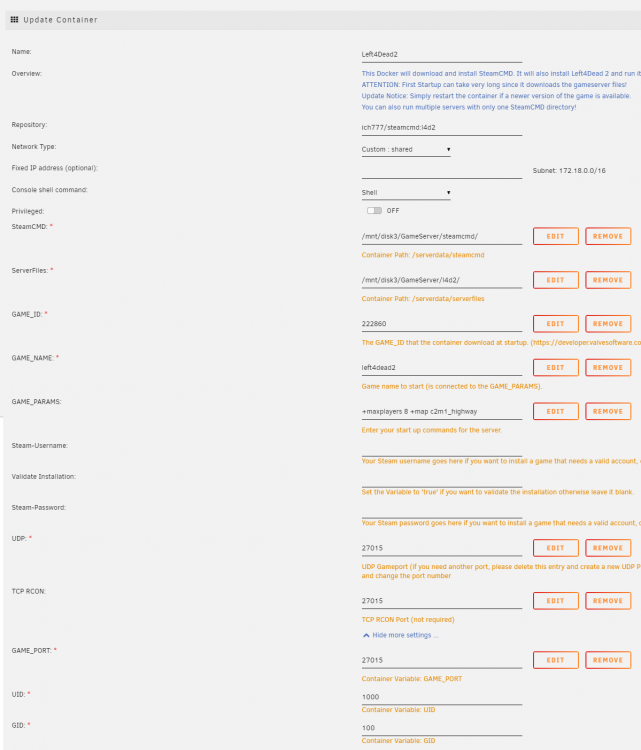

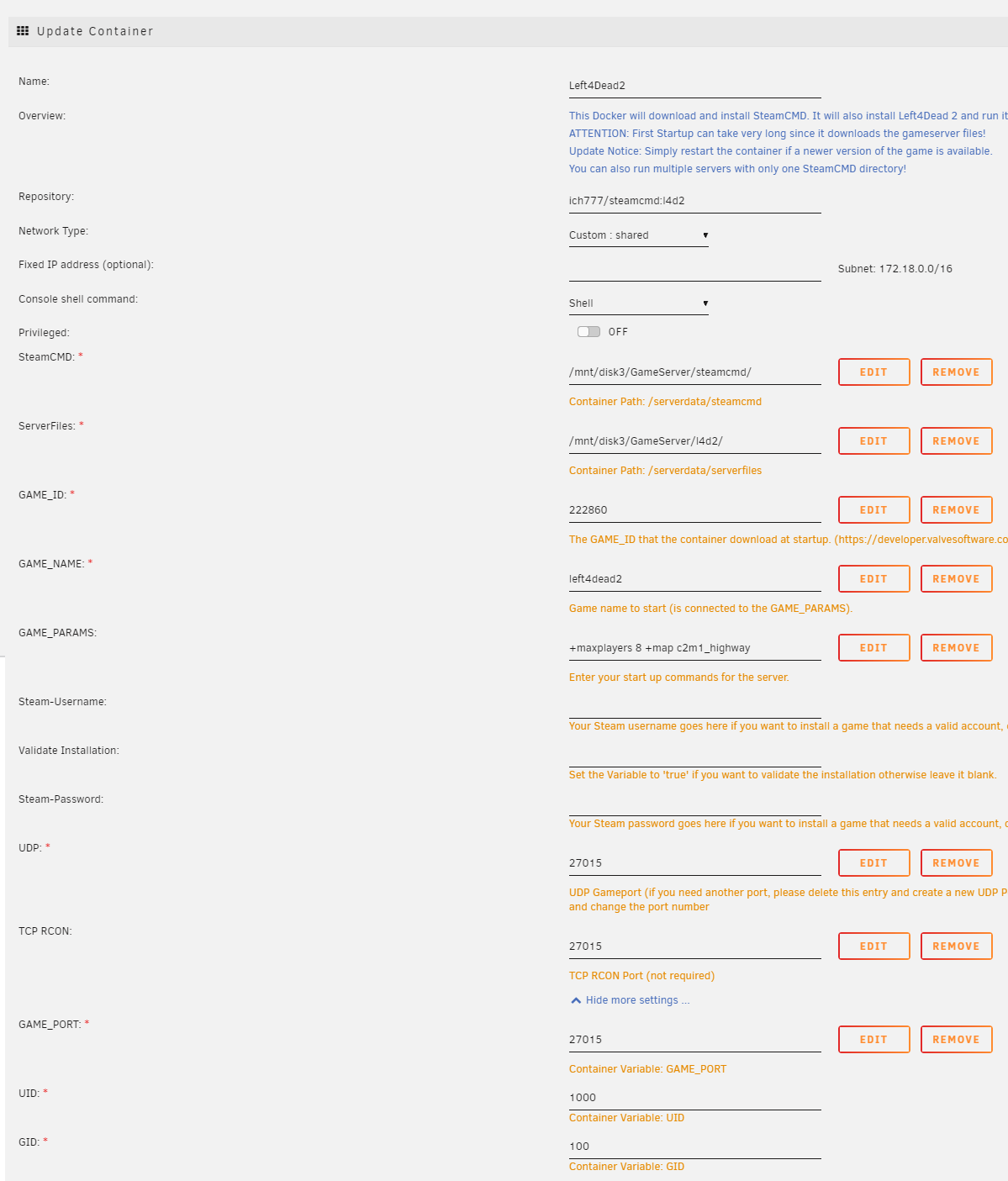

On 1/4/2022 at 8:03 PM, ich777 said:
I still can't reproduce this error.
Have you tried since then to install the container, of course wipe it before completely:
Delete the contianer
Delete the l4d2 folder from your appdata directory
Pull a fresh copy from the CA App
On what unRAID version are you?
Have you installed a Cache driver if yes, make sure that the appdata directory is set to use cache "Only" or "Prefer" in the Share settings. If you don't have a Cache drive make sure to point it at the right disk where your appdata directory is located and also make sure that the files aren't split over multiple directories.
Also make sure to not set the game directory to a path like /mnt/user/appdata/... it always needs to know where the files are located physically, so to speak: /mnt/cache/appdata/... or /mnt/disk1/appdata/...
Here is the log from a fresh pulled container from the CA App: l4d2.log
When I create a new share directory named "GameServer" with cache setting "No", the server command seems run normallly.
---Checking if UID: 1000 matches user---
usermod: no changes
---Checking if GID: 100 matches user---
---Setting umask to 000---
---Starting...---
---Update SteamCMD---
Redirecting stderr to '/serverdata/Steam/logs/stderr.txt'
[ 0%] Checking for available updates...
[----] Verifying installation...
Steam Console Client (c) Valve Corporation - version 1639697740
-- type 'quit' to exit --
Loading Steam API...OK
Connecting anonymously to Steam Public...OK
Waiting for client config...OK
Waiting for user info...Warning: failed to init SDL thread priority manager: SDL not found
OK
---Update Server---
Waiting for user info...OK
[33;1mPlease use force_install_dir before logon!
[0mSuccess! App '222860' already up to date.
---Prepare Server---
---Server ready---
---Start Server---
Server will auto-restart if there is a crash.
Setting breakpad minidump AppID = 222860
Using breakpad crash handler
Forcing breakpad minidump interfaces to load
Looking up breakpad interfaces from steamclient
Calling BreakpadMiniDumpSystemInit
[S_API] SteamAPI_Init(): SteamAPI_IsSteamRunning() did not locate a running instance of Steam.
[S_API] SteamAPI_Init(): Loaded '/serverdata/.steam/sdk32/steamclient.so' OK.
#Using shader api: bin/shaderapiempty_srv.so
#Console initialized.
#Using breakpad minidump system
Could not find steamerrorreporter binary. Any minidumps will be uploaded in-process#Game_srv.so loaded for "Left 4 Dead 2"
Server is hibernating
ConVarRef test_progression_loop doesn't point to an existing ConVar
[S_API FAIL] SteamAPI_Init() failed; create pipe failed.Looking up breakpad interfaces from steamclient
But I still can't connect to the server through 192.168.9.10 (which is my unraid server static local ip address) in game client. The docker setting is showed below.
