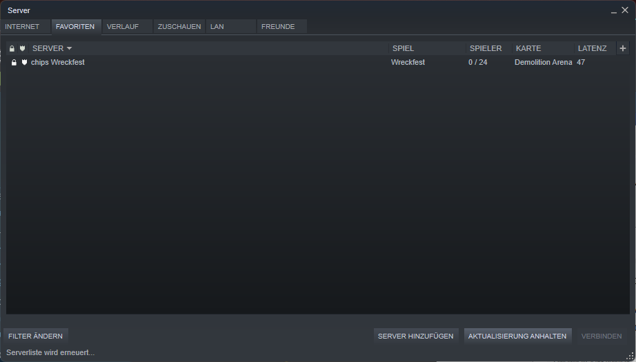

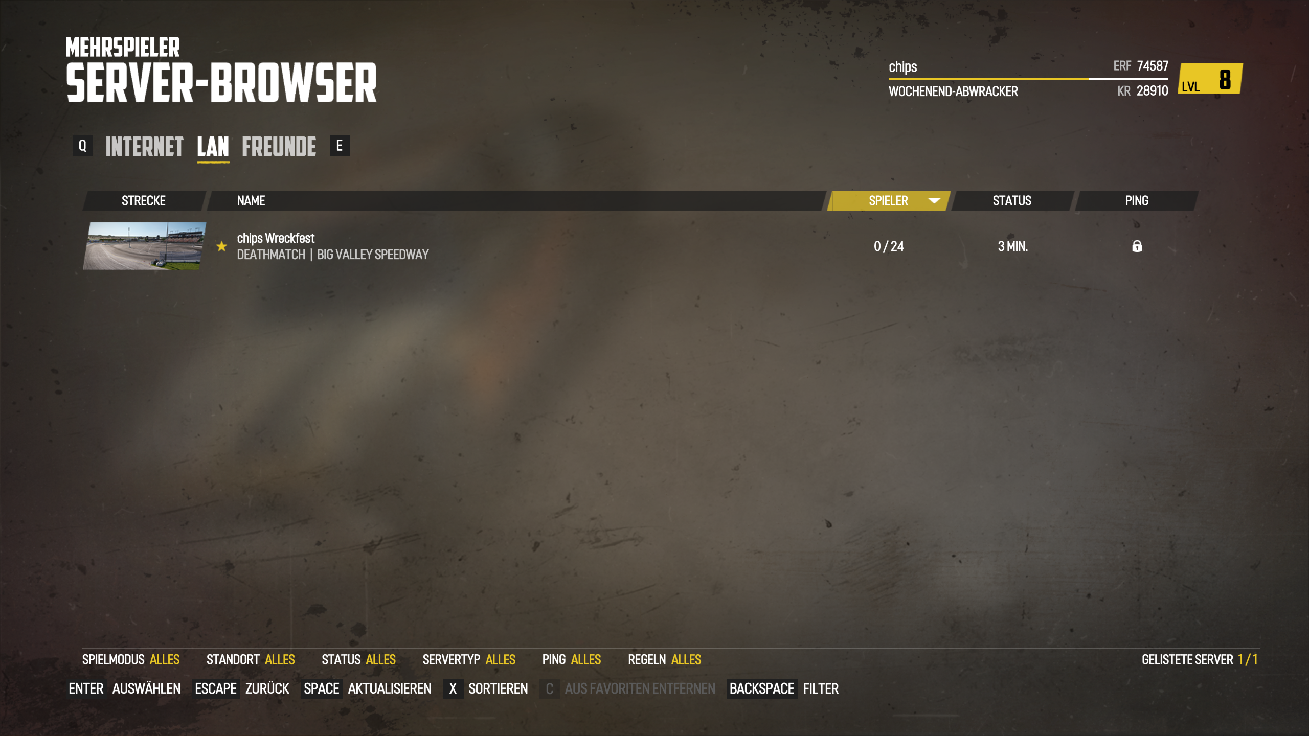

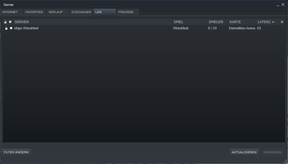

I can't reproduce this issue, are you on the same network? Did you allow Wreckfest access to your network when it prompted you to? Do you changed anything to your bridge network?
Here is a screenshot form my server (also reachable from the Internet without a issue:

47 minutes ago, LFFPicard said:
Is there any more indepth logs or something I can do to try and narrow it down a bit?
No, when the server is running it should be reachable as in the screenshot above.
You can see my configuration here:
48 minutes ago, LFFPicard said:
Annoyingly Wrekfest has no "Direct connect" for me to try and force a connection to see if it actually works at all.
This is not enirely true you can look in the Steam Server Browser (In Steam click on View -> Server):
You also can add it manually and see if it responds by clicking on to Favourites -> Add -> enter you unRAIDIP:27015 -> click onec more Refresh:
The server should show up there.
If it isn't showing up there you have some kind of network error in your LAN.
