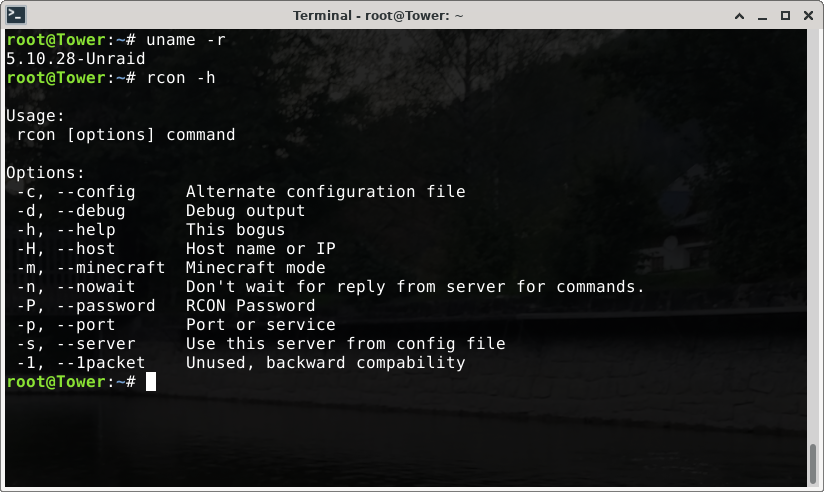

On 2/17/2022 at 10:00 PM, ich777 said:
This is really strange since it is working just normal on my test system with 6.9.2:
Do you have anything special installed through the NerdPack or from somewhere else? Do you have Unassigned Devices installed on your server?
EDIT: Ah, now I get it, if you install UnassignedDevices and UnassignedDevices Plus it is working... :D
I will add a check if the required package is installed and install it if it isn't installed next week.
EDIT2: Released an update from the RCON plugin that now installs the missing libraries if they are not already installed.
Ayyéé ! Sorry I totally missed your message from my notification box :(
But yeah now it work with your update ! Same that I was only missing some dependancie ! Thanks for the help and support provide !

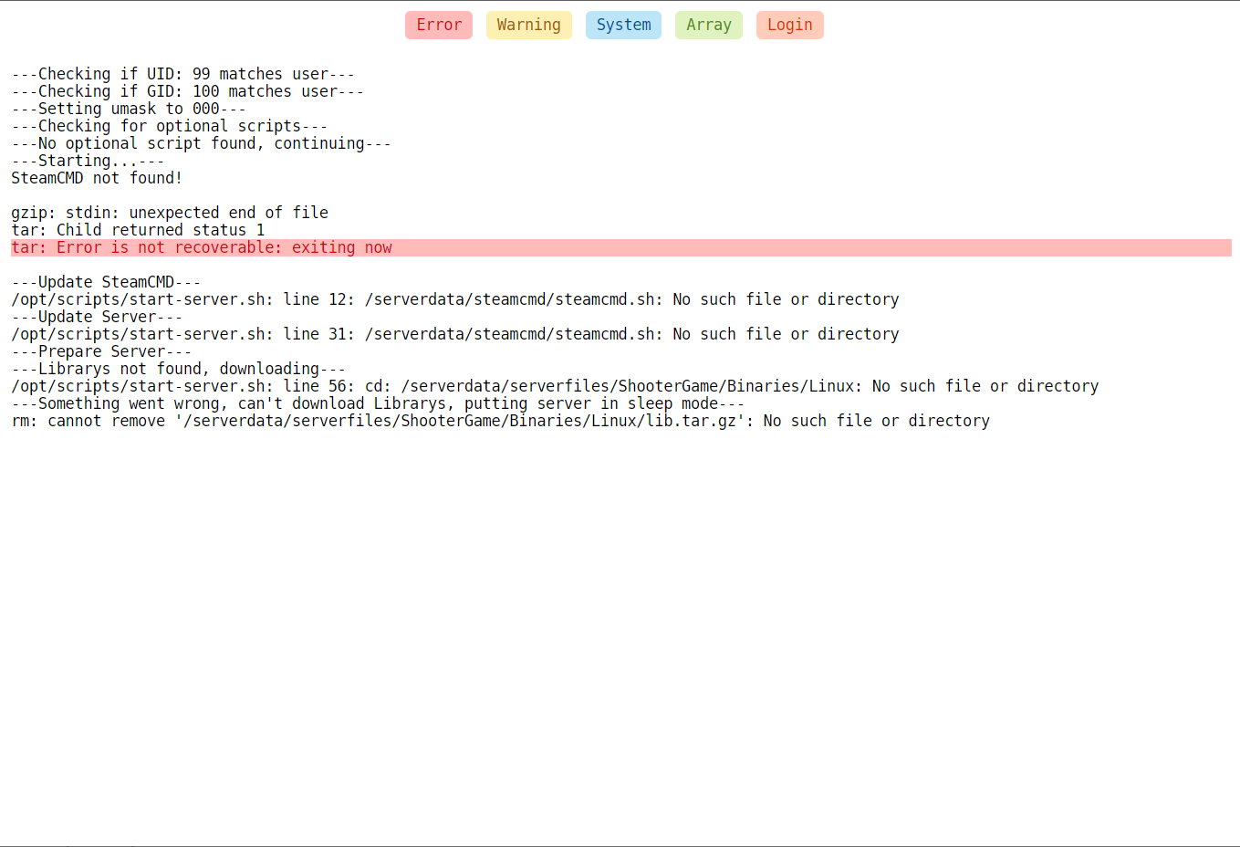

Hey , getting this error with all of your dockers, need help :)
On what Unraid version are you?
It seems like it failed to download SteamCMD, I would recommend to stop the container, delete the folders for steamcmd and the game itself from your appdata directory and try to start the container again.
