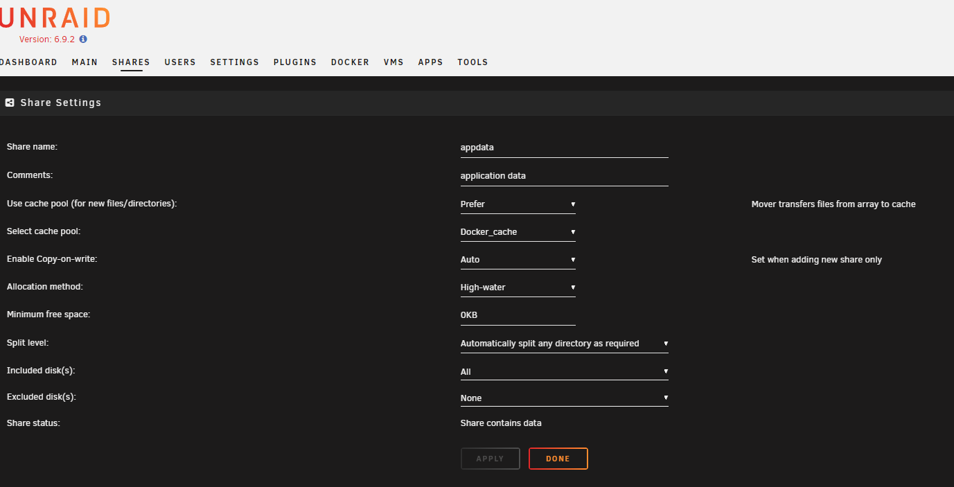

Do you have a Cache drive installed? If yes to what is the appdata share set in terms of Use Cache in the Share settings?

I am running Unraid version 6.9.2
Log file is attached.
appdata share is set to "prefer" for use Cache pool ->
conanexiles_log.txt
