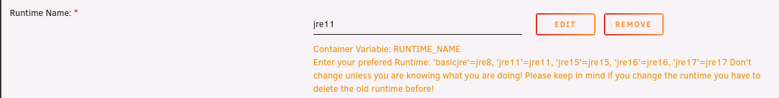

I think this was asked a few times before and from what I know Forge is not compatible with the newest Java version or am I wrong?
You maybe have to set this to Java 11 I think like in this screenshot:

Also if this crash is coming from modlauncher maybe try Java15 or Java16, don't know exactly which one is compatible.
I tried Java11 and that had no change... I then tried Java 16 and i had a change in the log reports:
