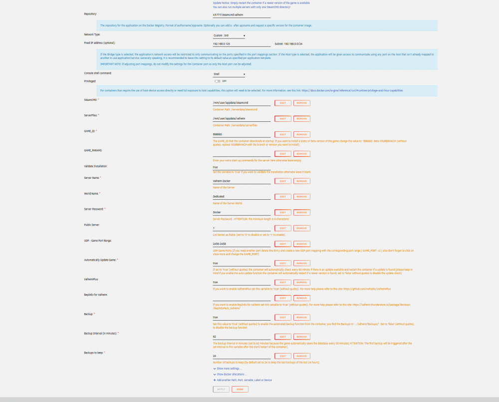

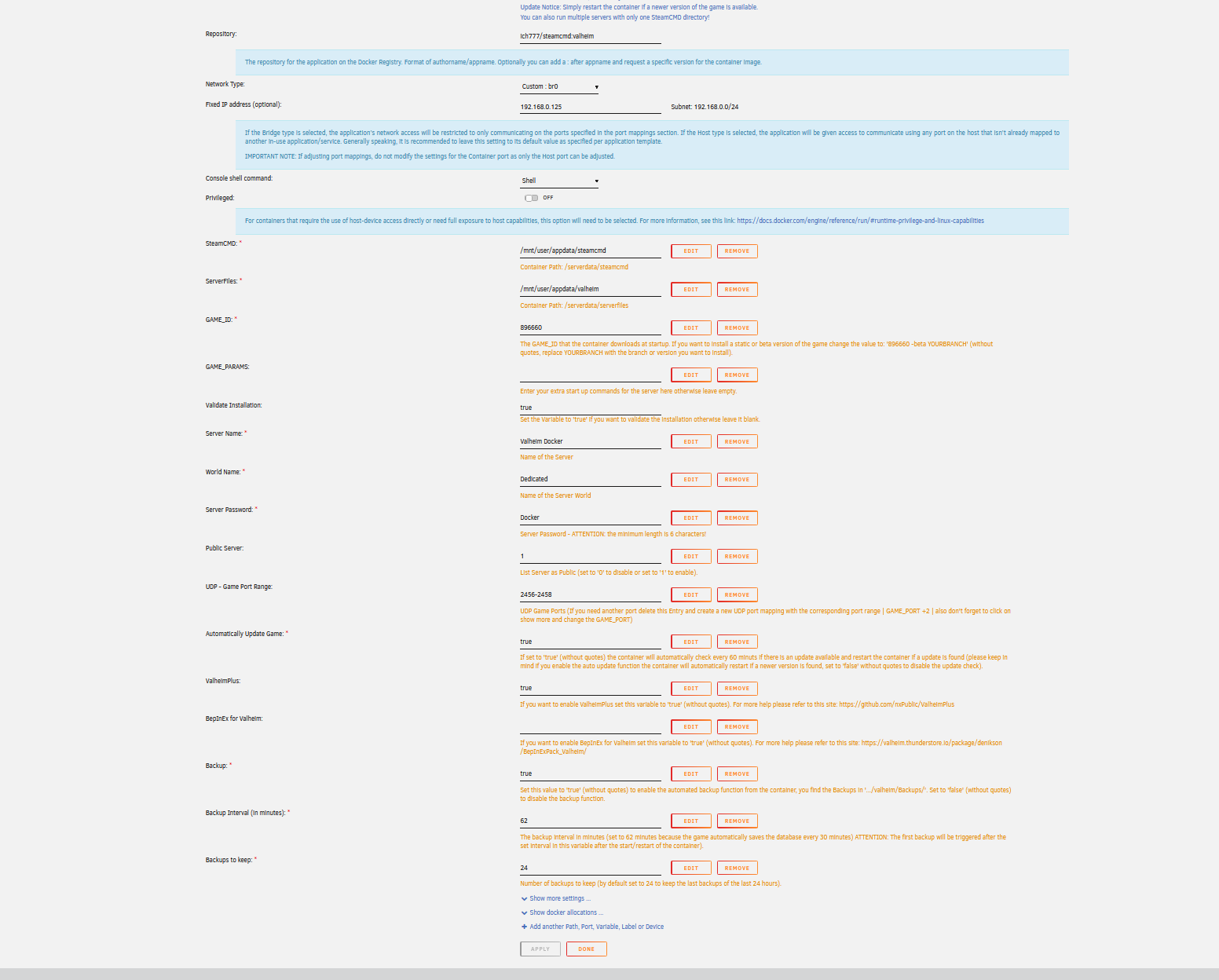

When I try to add ValheimPlus or BepInEx mods, I can't connect to the server.
Error "incompatible version"
If I disable the mod, the server works.
How can I solve the problem?
