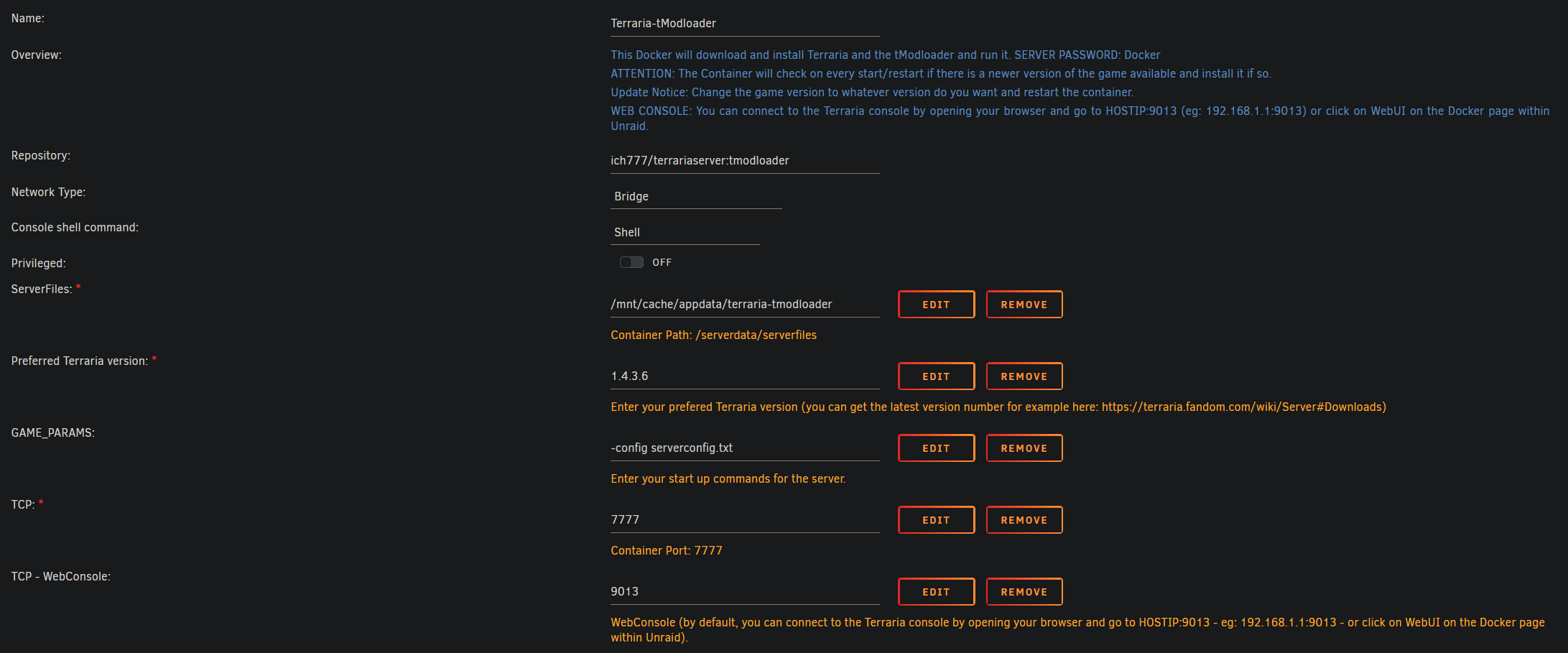

Hi again,
There is a new version available for 1.4 on that repository, but based on what I can see, the container needs to be updated to support the new version, as the tModLoader server works differently in the 1.4 version compared to 1.3. Might be worth your while to take a look at
Can you point me to the release (link)?
From what I see 1.3 is currently stabel or is this wrong:
A mod to make and play Terraria mods. Supports Terraria 1.4 installations - TML itself is 1.3 Terraria currently
28 minutes ago, BellyMeister said:
This is the exact version what the container should pull... :)
The container pulls always the release that is marked as "Latest".
Could you look into the terraria folder that is located in your appdata directory, there should be a file called "tmodloader_VERSION" where VERSION should be the tag that it pulled.
I couldn't find any such file, but starting the server and looking at the logs gave me this
Terraria Server v1.3.5.3 - tModLoader v0.11.8.9

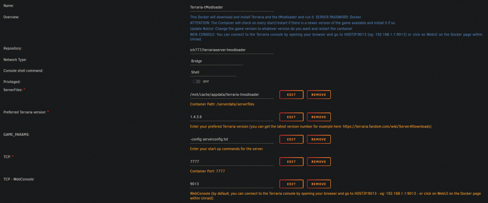

Attached container settings
I just took another look, turns out I'm blind. There's a file here called tmodloader_2022.04.62.6.
Edited by BellyMeister
I'm a dumbass
