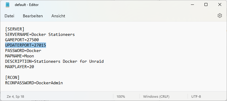

Having a hell of a time getting stationeers to work..
I have a couple physical machines running game servers on them..  and the machine im trying to get stationeers on has 7 days running on it using the 27015 port..   now... 7 days is fine..     my issue is getting access to stationeers..   I have changed the port in the stationeers docker (by adding a new port at the bottom and deleting the old one)  I have confirmed that the ports are not in use across any of my machines/servers/network..   ran the game for a while and still cant find it online..  cant even seem to connect to it using my lan ip.. or my external ip..  or even my ddns routing name..     so im 99% sure its server docker related..
I have checked the config file for the server name once its up and running..  but it shows the port still being 27015..  ive changed it and saved it.. restarted the docker..   and still no connection..
Im pulling my hair out..  lol..     the downside with unraid and dockers is that they are too stable and I dont have to mess with stuff often enough to remember everything to look for LOL.....
what am I missing?
I only have one drive in the machine so I dont have to worry about running the mover incase its keeping old data on it..
I have tried deleting the docker and image.. and starting over and changing the port before even running the docker..  still nothing..
I have double checked that I am forwarding the ports to the right machine..  and I am..     i know im entering the port forwarding correctly cause the other servers I have are up and visable ect..    and I have double checked for spacing or wrong numbers ect..
now its showing up in the list..  but when it asks for the password I have tried my set password..  I have tried the generic one..   nothing..  and the server logs dont show even a failed attempt to connect...

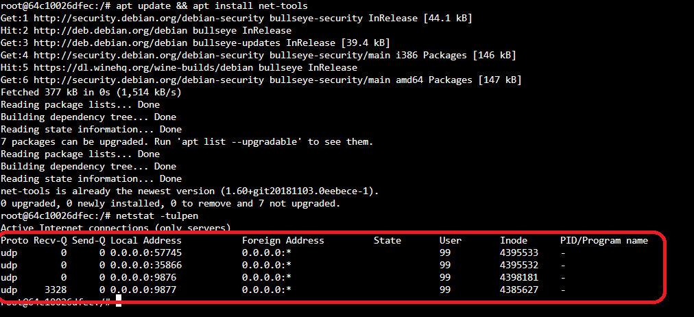

The default ports for this game are 9876 and 9877, nothing even listens or connects to 27015.
Do you have the port 27015 in the V-Rising template? If not, nothing can connect to it because the port is basically non existent if you don't publish it in the template.
I've made a screenshot from my server where you can see which ports are used (ignore the first two):

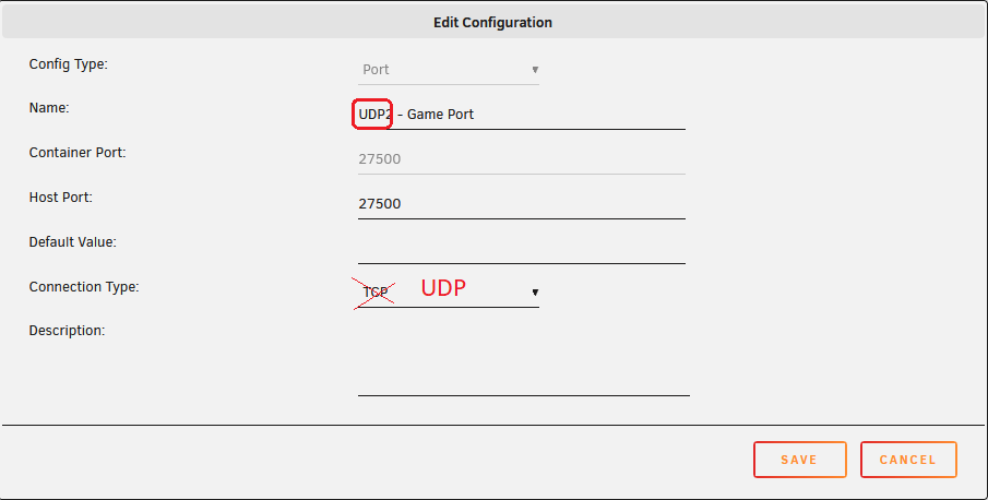

EDIT: I really have to appologize for the inconvenience, there was a mistake in my template where the UDP2 - Game Port was the wrong protocol type, please change that in your template to UDP and you can connect (already changed it in the template but you have to edit it manually in your template):
After that I can connect fine.
BTW did you also change the port in the default.ini which is located in the main directory from the container:
I've figured it out, it was doing the whole loopback when you're inside the same network, the moment i rerouted my pc to a completely different network, it just worked.
