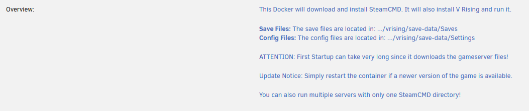

Sorry there was an error at first creating the container, the main data path is now .../vrising/save-data
Updated the template and looks on new installations like this:
