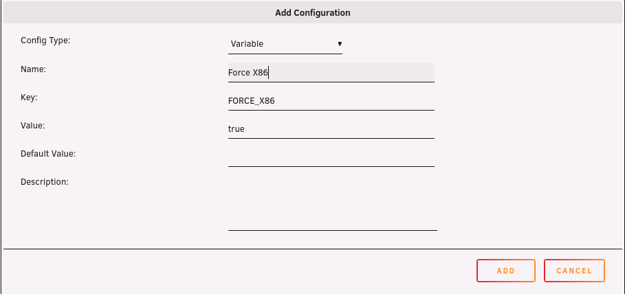

So, i tried Arma 3 again with my friend, after 2 minutes we got kicked because no response.
We played over 90 min with your Unturned Docker and it works rly well.
Could it be the default Port for the Arma 3 Server?
I am only connect with the local IP to the Server,  we both (my friend and me) have problems

1 hour ago, ich777 said:
Please try to add this variable to the container template:
