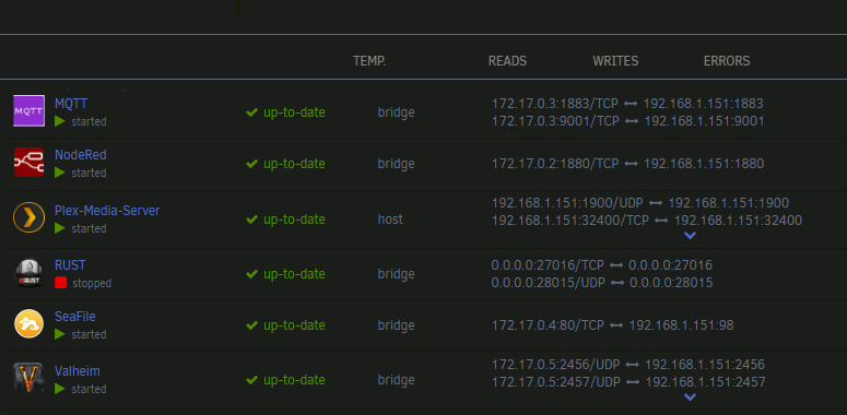

I have had the Rust Server Docker take a 100% cpu after it ran some time. it crashed the whole unraid server. I have tried a couple of times and it happened again, havent tried it for a couple of months now, but i dont want my other things to crash.
Did anyone experience something like that?

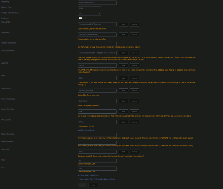

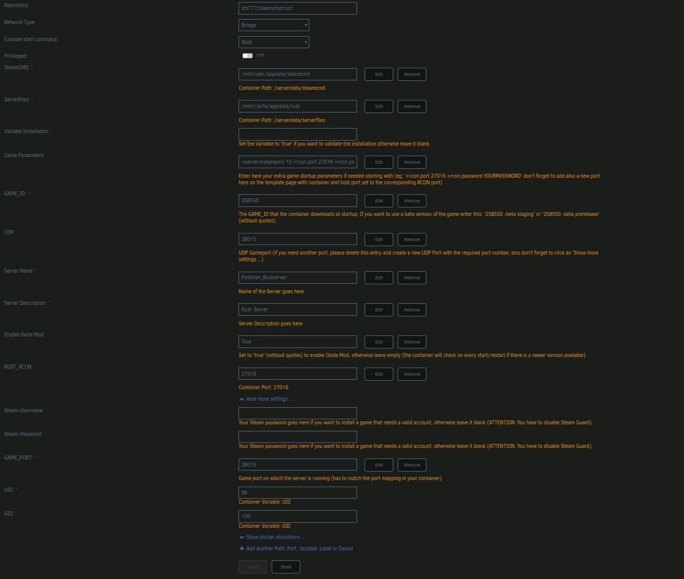

Can you share a bit more details please (Screenshot from the Docker template, what your Cache is set to in terms of use Cache).
It is very unlikely that a Docker container is crashing the whole server and this is the first report of such an issues, at least I don't remember such an report until now.

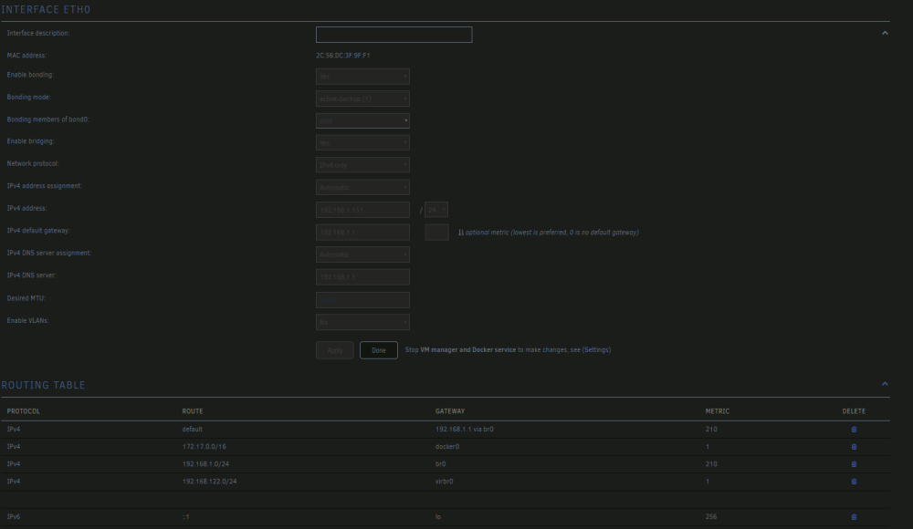

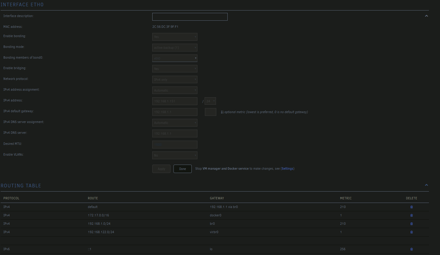

Do you use IPVLAN or MACVLAN in your Docker settings?

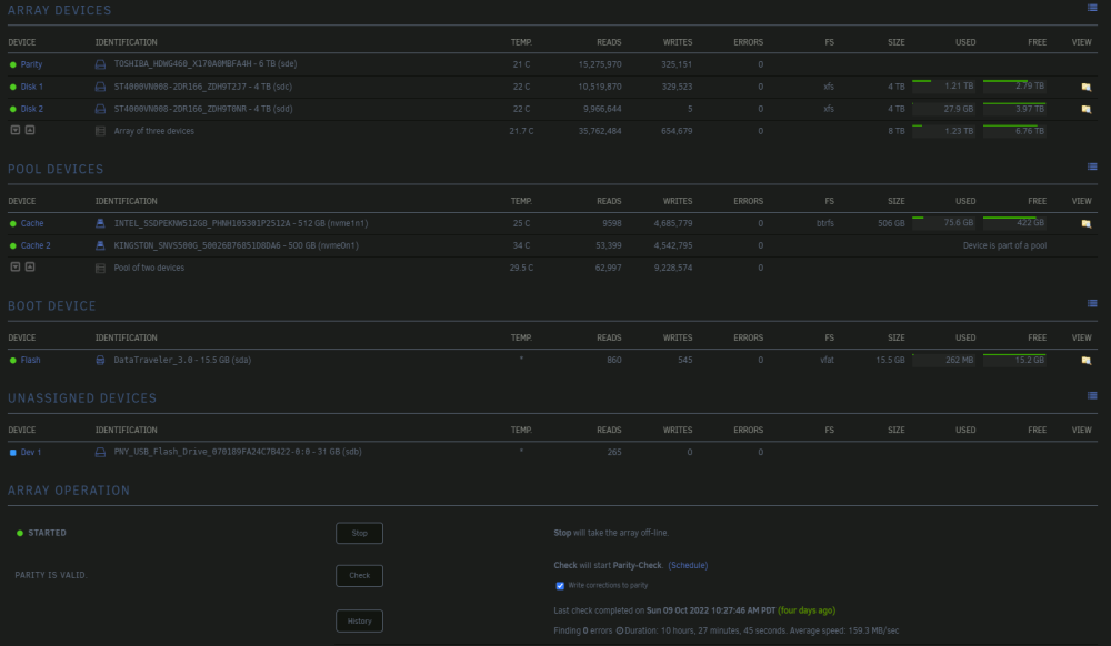

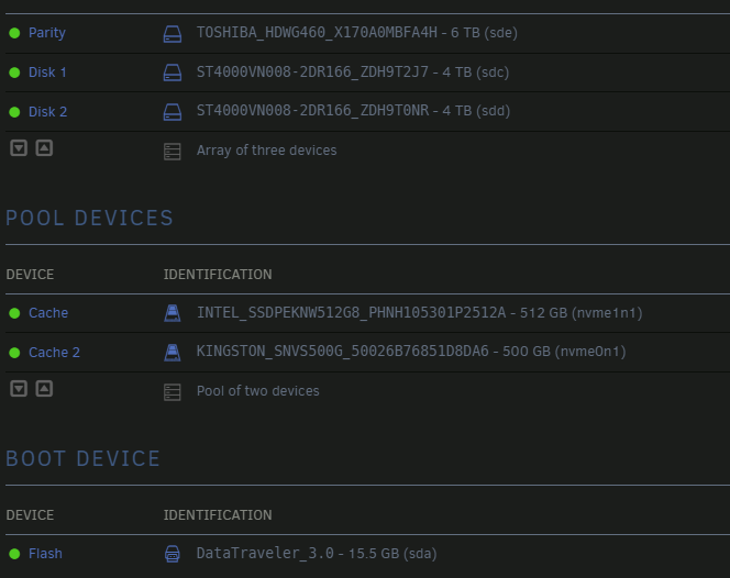

It might be a overstatement to say it crashed, but it did make all on the server unresponsive because it was at a 100% cpu load.
And i actually only have 16GB ram.
Not sure if this was what you were thínking of?
Maybe watch out how much RAM that the container allocates but usually it crashes if no RAM is available anymore.
Usually non of my containers should crash the server, it is however possible that the server consumes a lot of CPU on start up.
One screenshot from the appdata share would be nice where it is visible to what setting it is set in terms of Use Cache.

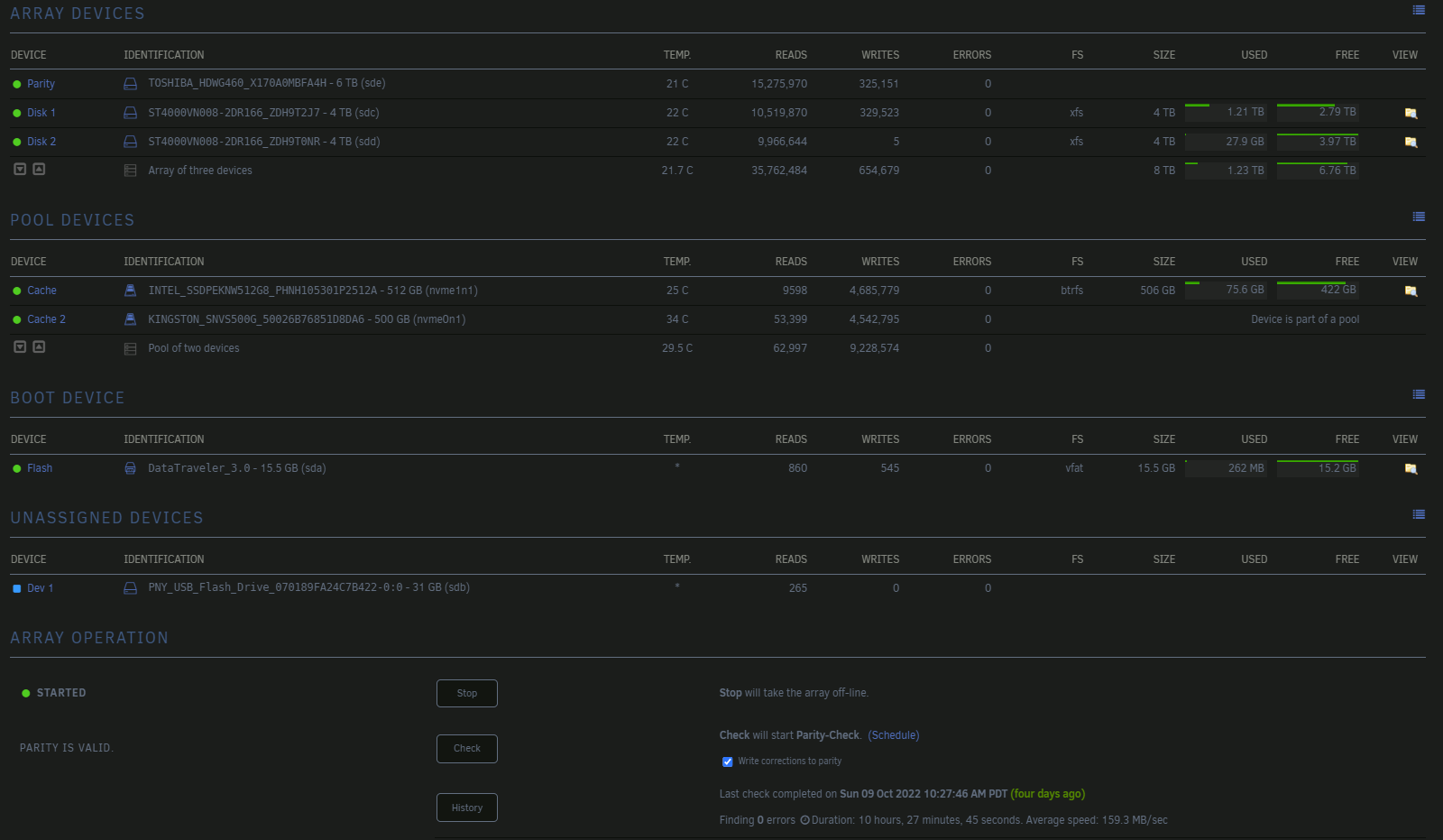

13 hours ago, HellraiserOSU said:
It is in my share for all my game stuff
This is actually bad, at least from my point of view because the data is spread over 6 disks.
I don‘t know if CSMM-7DtD is affected by this that it won‘t work properly when it‘s split across multiple disks and the location points not to the real path where the files are located.

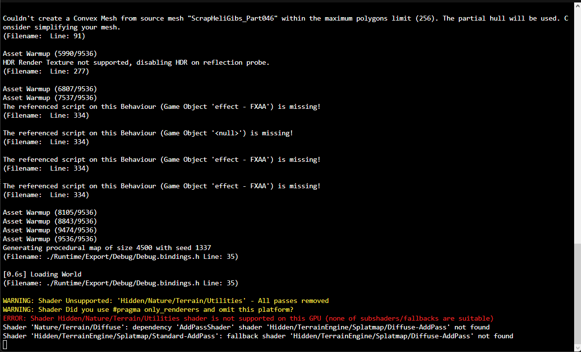

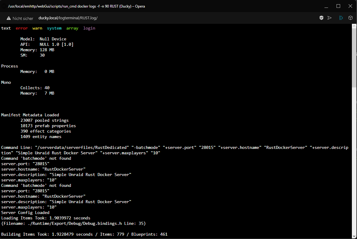

Hello ich777 I have tried to create a Rust server with the docker now it has downloaded everything ready and spits out only error and has no config there is config loaded but in the server files is nowhere to find the config....
You can ignore that error since this is just normal and is displayed on every instance (some errors and warnings are just normal since this a dedicated server and in this case they are displayed because well, this is a dedicated server without a GPU).
From what I see the dedicated server is just started as expected. ;)
Have you yet tried to search it in the Steam Server Browser (simply add the address from your server followed by the port - in this case 28015 like: SERVERIP:28015).
