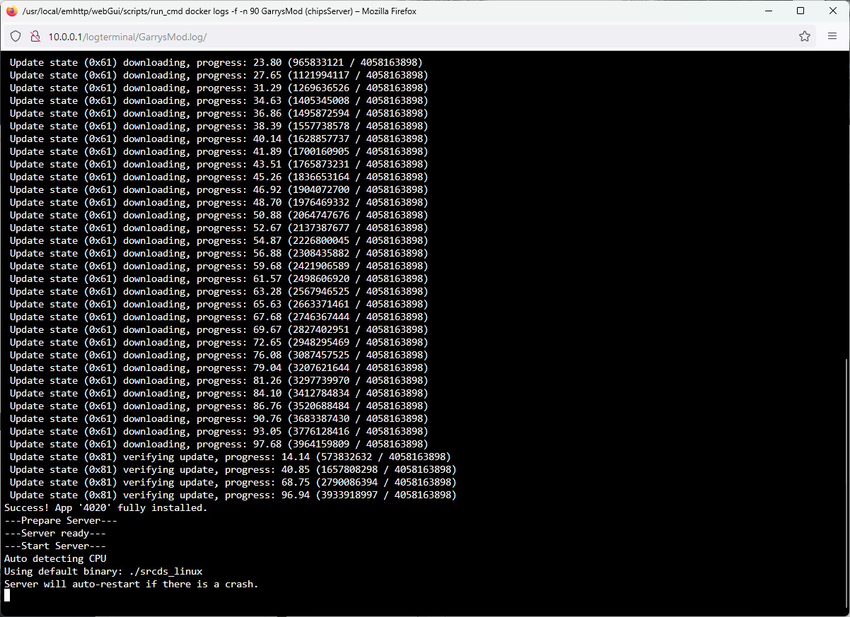

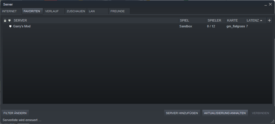

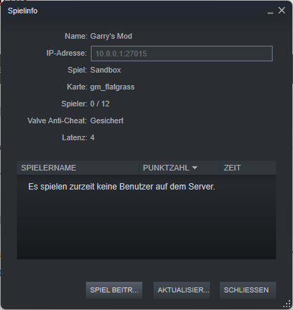

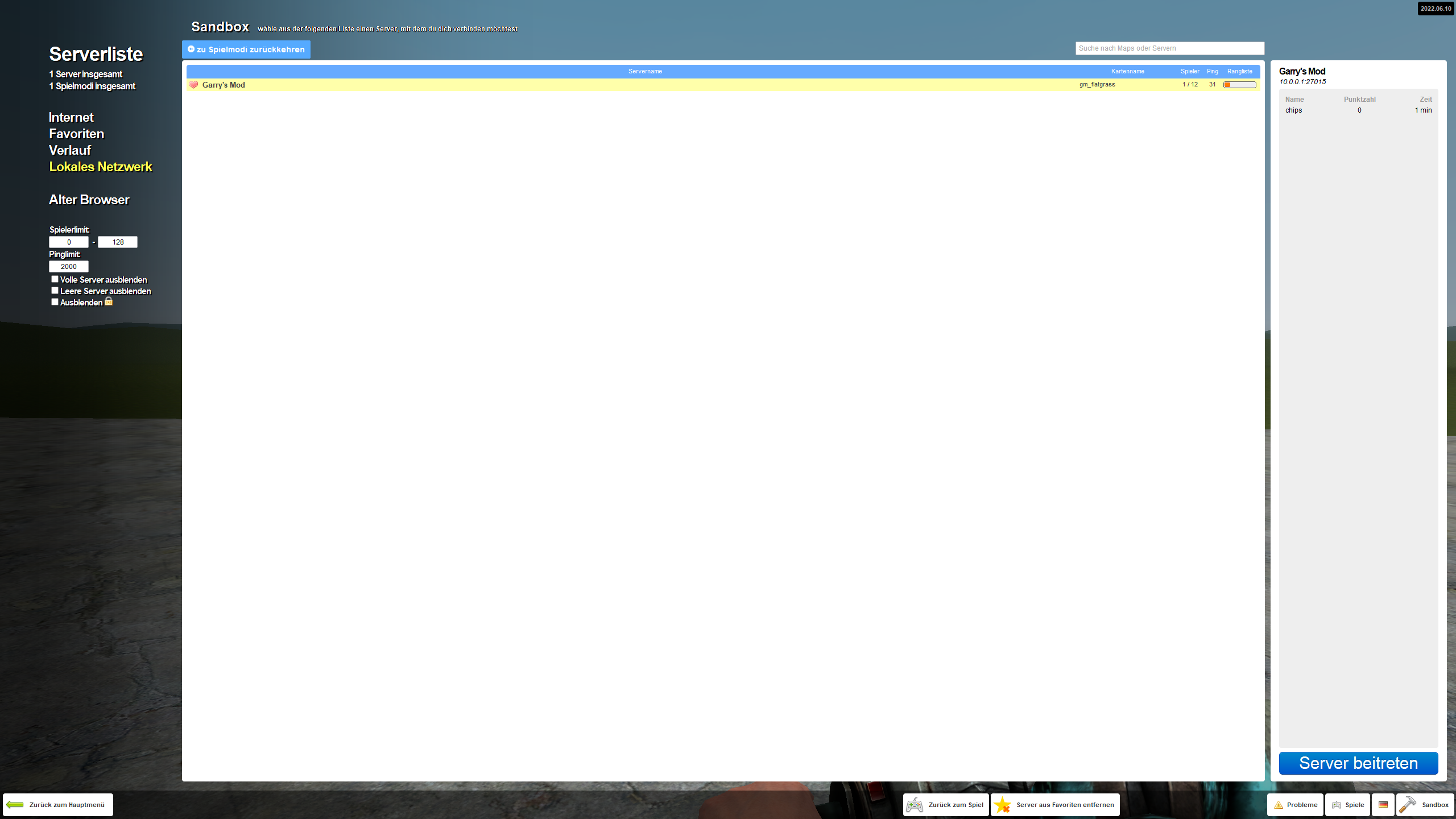

No issue over here:
It's even listed in Game here (you should see that I'm connected in the following screenshot):
And there is no issue connection to it:
Here is the log output from the container:
Haven't tried to make it publicly available but this should be no issue too.

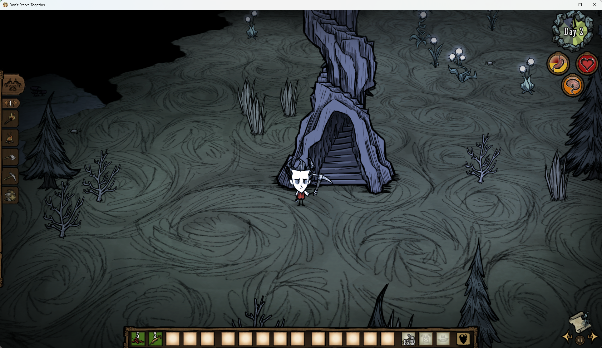

On 10/19/2022 at 1:06 AM, Shuamann1 said:
The Don't Starve Together server doesn't seem to launch the caves correctly. It keeps launching a second overworld server that shows in the server browser instead of a caves instance. I have been messing with it all day but cannot get it to generate caves.
I've fixed the container now, please delete the container and the folder that was created for dontstarve in your appdata directory and re-download the container from the CA App.
Caves are now loading properly.
Awesome! Thanks a bunch ich!
