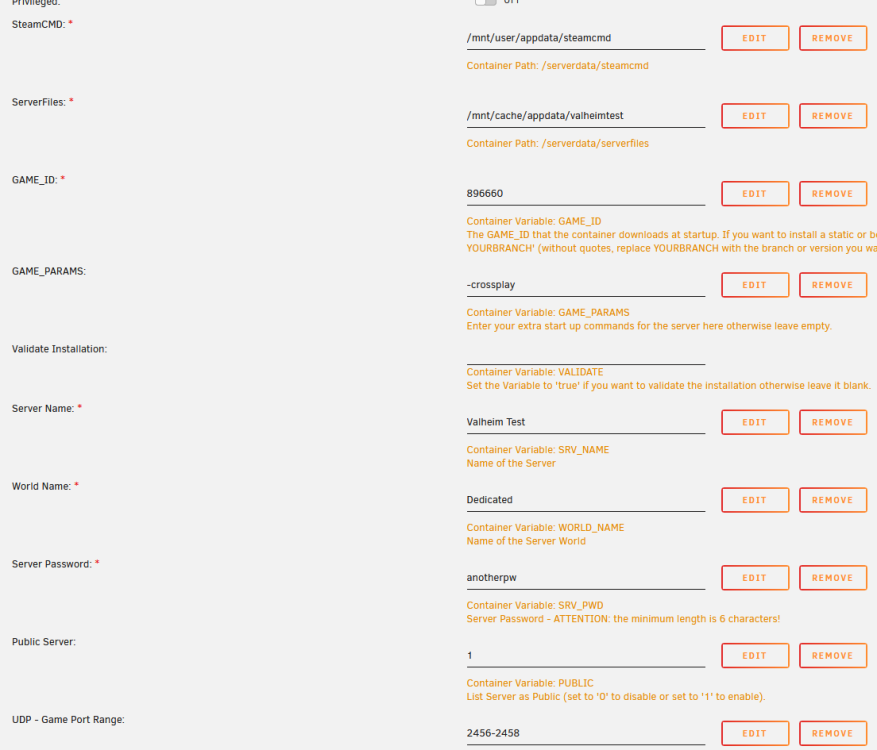

5 minutes ago, vanik said:
Completely fresh appdata dir, completely fresh container (only added "-crossplay" and changed the server password), transferred files over from Windows... still no luck 😒
FWIW, I turned on server logs and got:
ERROR: Shader Legacy Shaders/Particles/Additive shader is not supported on this GPU (none of subshaders/fallbacks are suitable)
ERROR: Shader Legacy Shaders/Particles/Alpha Blended shader is not supported on this GPU (none of subshaders/fallbacks are suitable)
ERROR: Shader Legacy Shaders/Particles/Alpha Blended Premultiply shader is not supported on this GPU (none of subshaders/fallbacks are suitable)
ERROR: Shader Unlit/Color shader is not supported on this GPU (none of subshaders/fallbacks are suitable)
ERROR: Shader Lux Lit Particles/ Bumped shader is not supported on this GPU (none of subshaders/fallbacks are suitable)
HDR Render Texture not supported, disabling HDR on reflection probe.
Unloading 6 Unused Serialized files (Serialized files now loaded: 0)
UnloadTime: 19.529563 ms
Only custom filters can be played. Please add a custom filter or an audioclip to the audiosource (Amb_MainMenu).
10/26/2022 16:37:30: Get create world Dedicated
10/26/2022 16:37:30:   failed to load Dedicated
10/26/2022 16:37:30:  creating
10/26/2022 16:37:30: Considering autobackup. World time: 0, short time: 7200, long time: 43200, backup count: 4
10/26/2022 16:37:30: Creating first autobackup
10/26/2022 16:37:30: Saving backup at: /serverdata/serverfiles/.config/unity3d/IronGate/Valheim/worlds_local/Dedicated_backup_auto-20221026163730.fwl

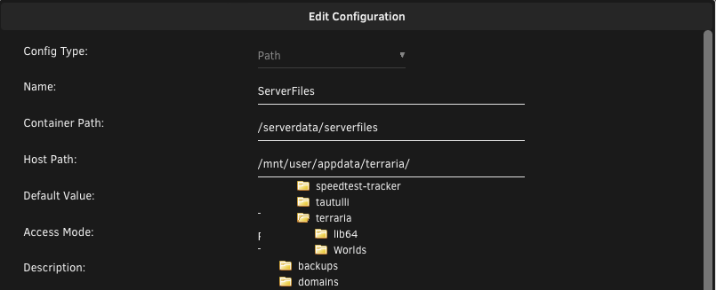

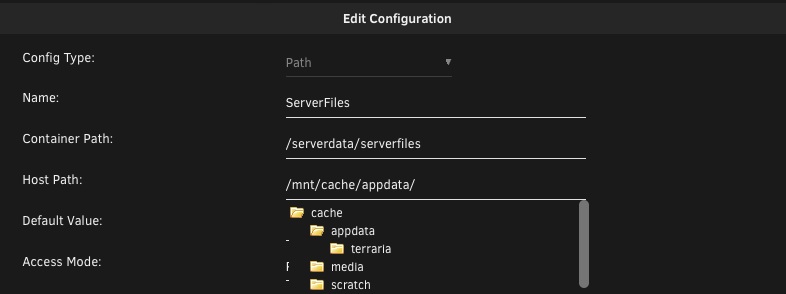

Thanks for testing it @ich777. I think I've managed to figure it out. For whatever reason, the default install was setting the "ServerFiles" path to /mnt/cache/appdata/ - had a look inside this folder, nothing there whatsoever.
Changed it to /mnt/user/appdata/terraria/ instead:
Everything now works perfectly fine! I have no idea why it wasn't defaulting there automatically. My world loaded up correctly, no issues shutting down/restarting/saving world progress it seems. Thanks again for testing on your side!
Because this is done on purpose, some game servers don't work when you point them to the FUSE file path (/mnt/user/...) and you have to point it to the real file path (/mnt/cache/...).
BTW is your appdata share set to not Use Cache Only or Prefer in the Share settings? I would strongly recommend that you do that because otherwise your Array will never spin down.
If you set the appdata share to Use Cache Yes, the mover will move the files off of the Cache and onto the Array, that's why you see that.
Is this maybe also your issue:
You can also post your Diagnostics and I will take a look at it.

14 hours ago, vanik said:
That's the case for SteamCMD, but not the ServerFiles... Would that make a difference? My appdata share is set to Prefer: Cache.
I somehow forgot yesterday to put in -crossplay, but I tried it now again with this option and it also works flawlessly:
These are the settings that I use:
I really don't know what's going on on your system...
You copy over the files through SMB or am I wrong?
However the folder looks like this when copying it over through SMB from my Windows machine:
My appdata share is set to Use cache pool: Only. Was running prefer, but found the pool @ 512gb was big enough. Disks definitely spin down after 15 minutes for me!
But then the path /mnt/cache/appdata/… should be okay and this is also my prefered way where to put the files, also keep in mind that this is the real file path and it will produce less overhead.

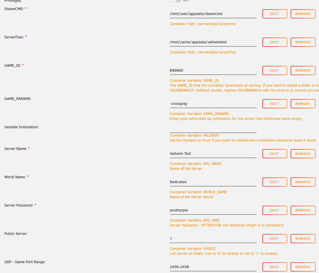

Holy crap, I got it! It was an absolutely insane fluke. I have _TWO_ cache drives in my pool, "cache" and "large". It turns out Unraid was splitting the data across them so since the container was pointed to "cache" and my files (through SMB) were put on "large", it wasn't seeing them.
Ugh. COMPUTERS.
Thank you so much for your patience and help, ich777!

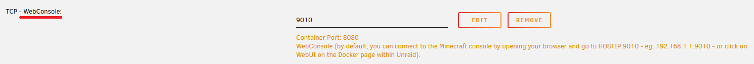

3 hours ago, Gromit83 said:
Also the description is pointing to a webhook at port 9010, but that's outdated maybe or just for the java version?
Definitely not, this is the WebConsole.
Click on the container icon and select WebUI and you will see that this is the port it points to:
(also the description should tell you what it is...)

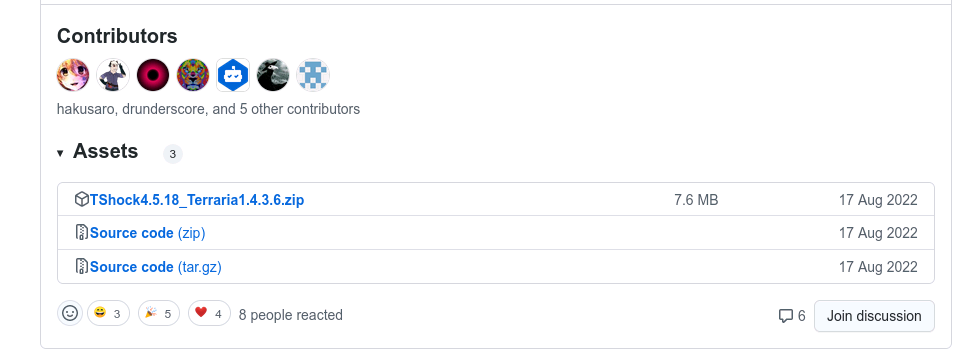

On 10/15/2022 at 7:30 AM, ich777 said:
My Tshock container should always download the latest version from GitHub. IIRC the version that it shows is always wrong, at least that was always the case for Tshock.
Have to look into this after the weekend.
Has this been further delved into?
I looked at my \appdata\terraria-tshock folder and can see a file there called 'tshock_4.5.18' which does look like the latest release of tshock; but the log from starting up the container says the game version is running v1.4.3.6.
Opening the game states it is on 1.4.4.7 now
Thanks for looking into it~
