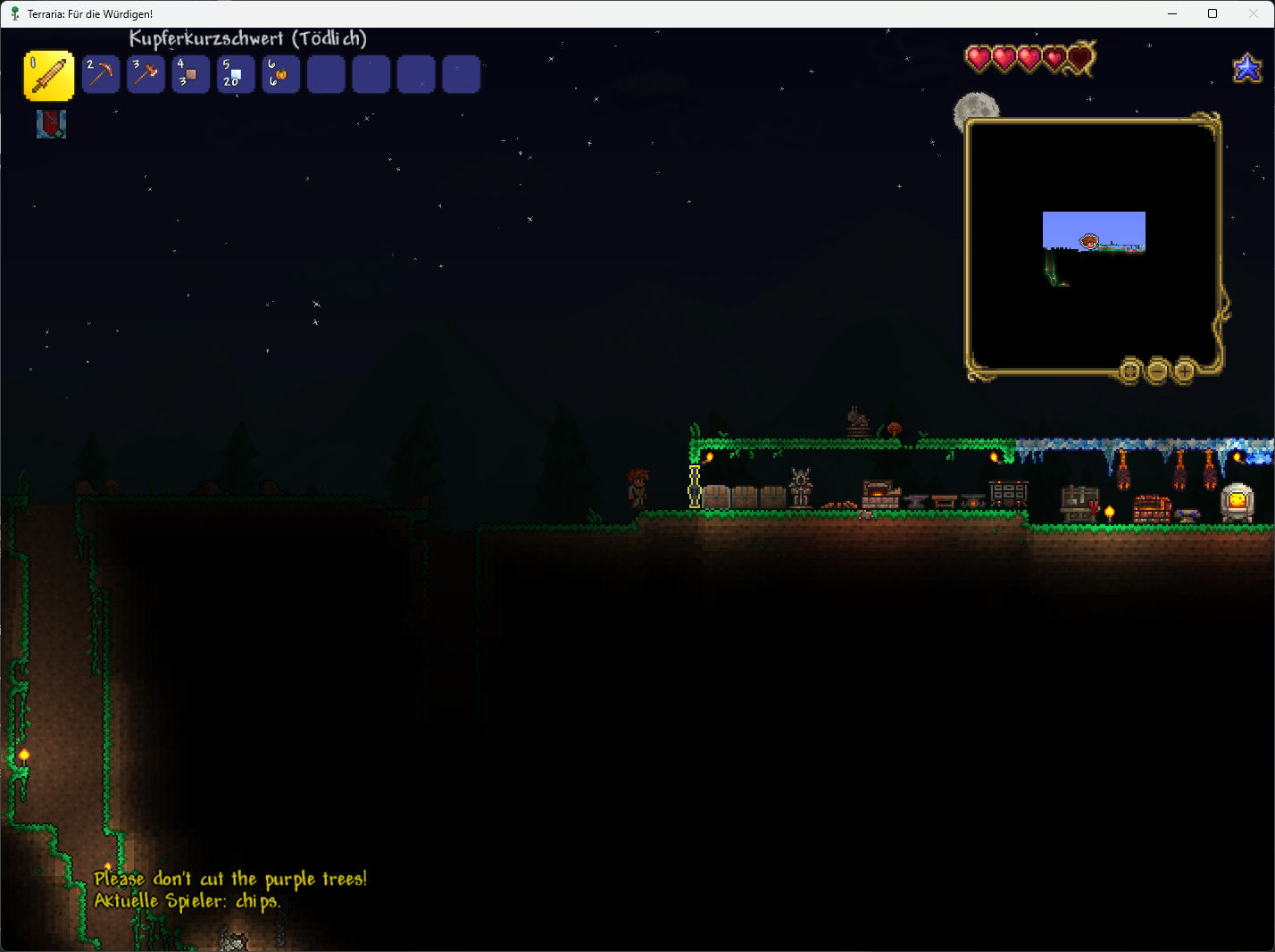

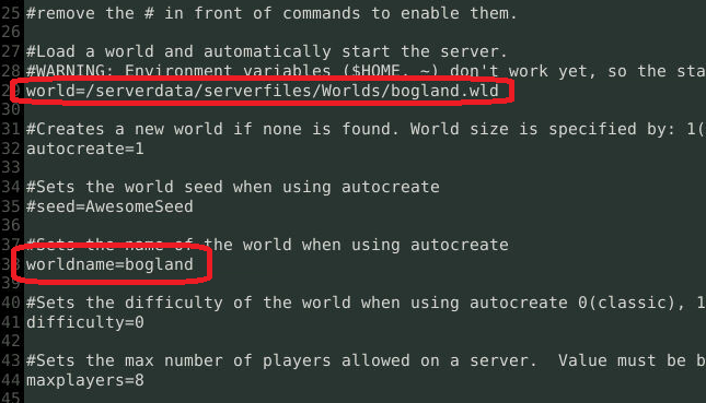

Hi all, struggling with getting Terraria server to load my existing world. It keeps spawning new worlds.
Steps I've taken:
1. Installed docker image
2. Setup TERRARIA_SRV_V as 1.4.4.7
3. Started Docker image, stopped it. Deleted world.wld
4. Copied over my existing world.wld from PC
5. Restarted server.
6. Connected using latest Steam Terraria client, but new world is generated and not my existing seed. Stopping docker container generates world.wld.bak file in addition to my existing world.wld file.
I've also tried renaming my world file to bog.wld and editing the name of the world in the serverconfig.txt file to match - no other parameters/paths were touched, just the physical filename.wld file. Upon reloading and connecting, it still generates a new world (and subsequently saves world.wld or world.wld.bak.
Have tried a fresh docker reload after blowing away the appdata/terraria folder, and adding bog.wld + updating serverconfig.txt to refer to after stopping the new docker installer. Same problem, world not loading.
Tearing my hair out, have I missed something? World was created in 2020, but as been saved multiple times obviously, and under latest 1.4.4.7 PC client.
Edited by BOGLOAD
Can you please send me your world file (simply drop it in the text box) so that I can try it on my server?
Have you installed a cache drive? To what is your appdata Share set in terms of Use Cache in the Share settings? Have you changed anything else in the container template?
Hi @ich777 - sure thing, file is attached.
Yes, a cache drive is installed (use it mainly as a downloading drive), called it 'CACHE' and it only holds my 'scratch' share.
Created a separate cache pool called "Data" for my appdata share (running RAID1). The appdata share is set to Use Cache Pool: Only,  and Select cache pool: Data.
Nothing else is changed in the container template, just the version number of the server.
bogland.wld
No issue over here, at least it seems like no issue (this is definitely not the default world😞
After the first server start I let the server create the default world and let the server fully start.
After that I stopped the container, put your world file in the "Worlds" folder and then changed two things in the serverconfig.txt:
Finally I started the server again and it loaded the world just fine.

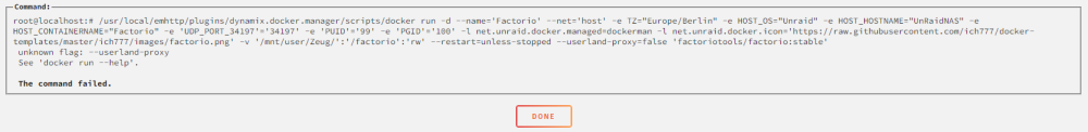

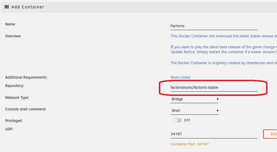

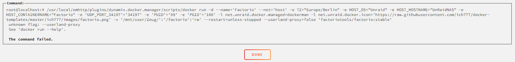

I have setup a the Factorio Server at home on my dedicated NAS system. UnRaid 6.10.3
The Server uses my Name and auth-token to make it available for public access.
I switched between ichs777 docker and the now maintainging "factoriotools" between and forth. (https://github.com/factoriotools/)
I left the standard ports 34197 UDP and 27015 TCP as is and both are forwarded in my router.
Also UPnP is activ on UnRaid and router if that makes a difference.
The server is set to publish to public and LAN, and can be seen from my and other machines on LAN and public.
All machines can connect via LAN/Local IP Address.
Nobody can connect via the "Browse public server" or via the public ip address.
I have read on the github and in this post, about some issues with some kind of internal proxy docker is using. There suggestion was to start the container with: --userland-proxy=false but that always corrupts the container and i have to reinstall it again.
https://forums.factorio.com/viewtopic.php?f=49&t=35255Bild_2022-10-26_155942981.thumb.png.1dc990e7b484527e732310a7ca9bf3bd.png

I am really not sure if a container issue or a docker one to be honest.
As far as i can tell the port forwarding on my router is working correctly. I have no issues opening ports for UnRaids build in Wireguard VPN.
Edited by JohnSaft
I've only made a template for Factorio it's also based on factoriotools/factorio:stable as you can see in the template:
Please double check your port forwarding and also if you have forwarded UDP, also note, some ISPs blocking port forwarding for UDP ports in general but this is only just a guess.
Also please check your configuration file if the token is set correctly without any spaces in the front/end.
With which editor did you edit the file, it's not the first time that the editor messes up the config file.

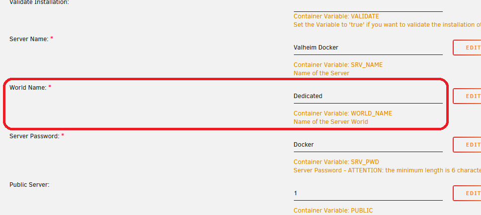

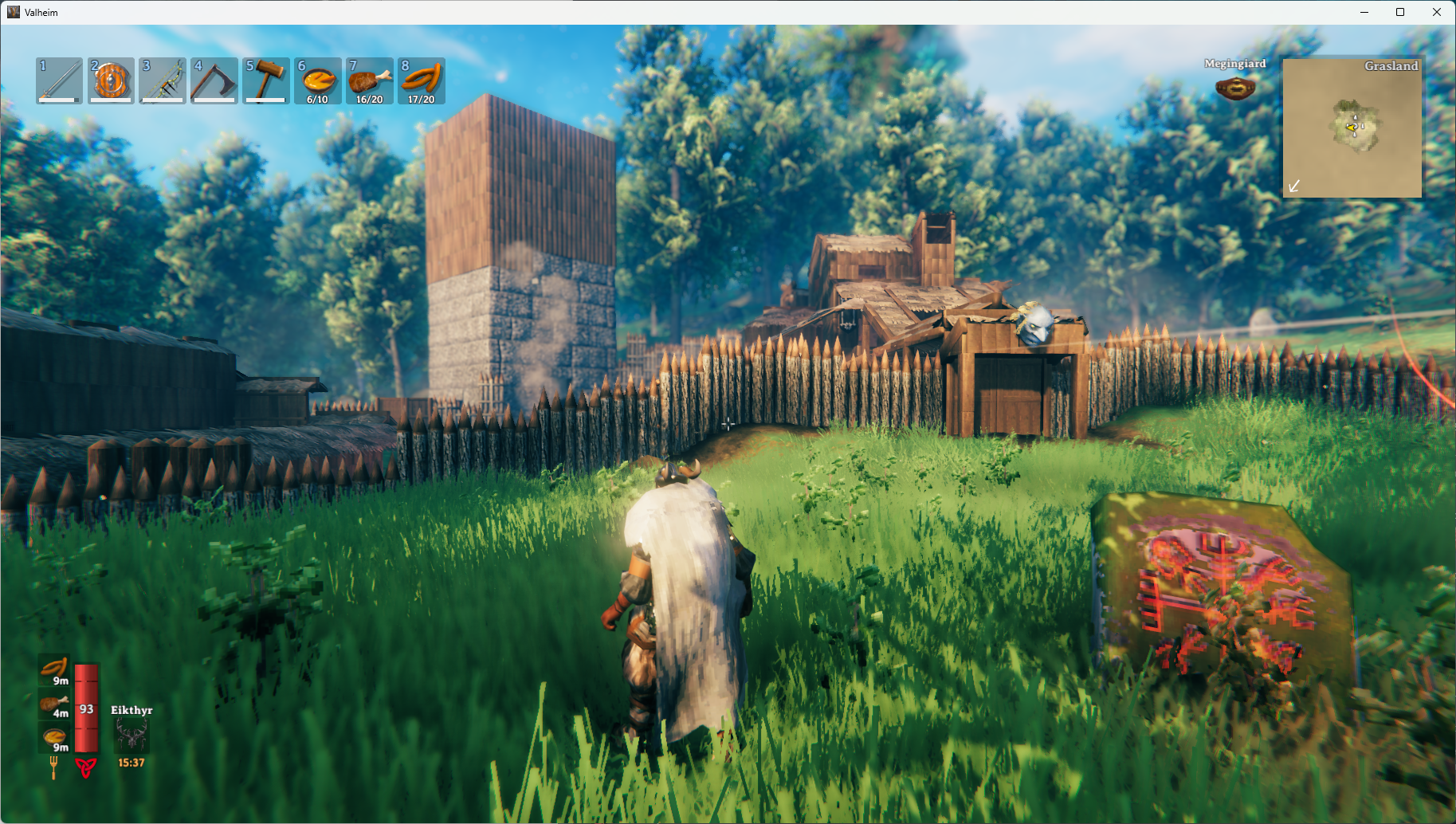

Hi - first, thank you so much for all these containers and all the support!
I'm running into a similar problem with my previously saved Valheim world not loading on the dedicated server. I've checked:
* -crossplay is turned on
* the files are in ./appdata/valheim/.config/unity3d/IronGate/Valheim/worlds_local
* the Docker World Name is the exact same name as the file
* I'm passing the name through "-world [world_name]"
* The files I copied over belong to "nobody/users"
I still end up getting a fresh world every time.
I'm running the Game pass version of the client. Is there some kind of compatibility issue? Is "world_local" not the right folder?
Edited by vanik
9 hours ago, Uncle09 said:
yes I joined, but I did not realized that this question have to be asked not here, becaus ich777 did the container.
But now I will 🙂
Make sure to give yourself the unraid role so you can ask in the proper channel and @ me so that I know you're asking and can respond.  Same user name.
Why? There is a line in the template that does this.
No there is no compatibility issue.
Yes, but please don't use the -world parameter use the line in which is defined in the template.
This is not imported the container should set the permissions on each start/restart from the container, how do you copy over the files.
Do you stop the container first and then replace the world?
Have you yet tried to rename your world files to the default files which are in the folder and replace it then?
I can tell for sure that Valheim is working with crossplay because I added this feature about 3 weeks ago.

No, Dedicated is the default name:
(please always use that variable in the template)

Please send it over and give me some hint where I should go to where some buildings or something is.
13 minutes ago, ich777 said:
It is also enough to only rename the file...
Sure! Appreciate the help :) There should be a pretty big structure right to the north of the summoning stones.

Seems like no issue over here:
Steps that I did:
  1. Delete the container
  2. Delete the folder valheim in my appdata directory
  3. Pulled a fresh copy from Valheim from the CA App
  4. Let it create the initial world
  5. Stopped the container
  6. Delete all existing files from the folder .../valheim/.config/unity3d/IronGate/Valheim/worlds_local
  7. Copy the files from your archive to the path from step 7 (except for the __MACOSX folder)
  8. Started the container again
  9. Connected to the server

Huh! Well, it's a relief it's not corrupted. Did you adjust the any of the Docker variables? and you renamed the files to "Dedicated" before step 7, right?
Not one.
You've sent a archive with files named Dedicated, didn't had to rename them.
