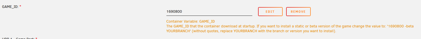

Running your satisfactory docker container, and trying to figure out how to force experimenttal.  Do I need to add -beta experimental to game params or somewhere else?
Please see the description from the variables:
Thank you I missed that
