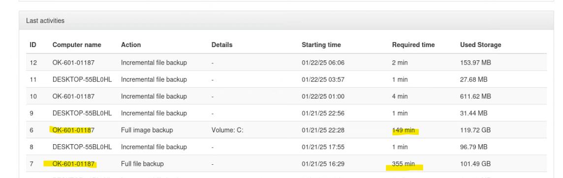

wanted to share been trying out URBACKUP since I've relied on RAID as Backup (hahahaha) being using icloud and google drive to have offsite backups anyway. I read thru all 18 pages of post and the documentation and it learn that this is what i need.  I have not done a image restore to a vm on my unraid yet but have done a few files restores and it  has worked flawlessly.
One of the post said wifi backup was terrible and it should be its wifi but I was able to back up and image a surface it took a while but it did it.
Thanks to binhex for this docker
restored a vm and it went smoothlly,
