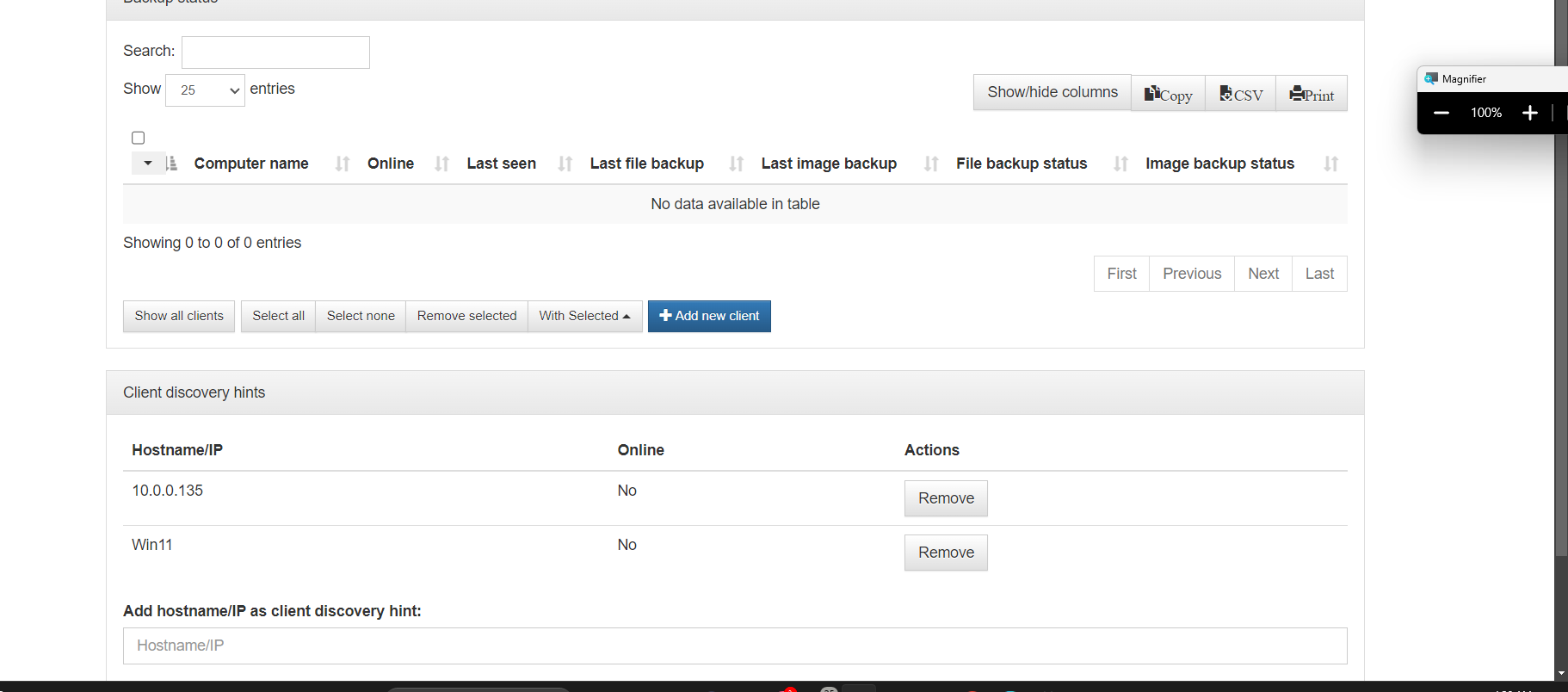

Do you have any recommendations for someone who is just starting out with unraid..   I have read the documentation for the urbackup and I am still unable to get the webui to recognize my client server I installed on my windows 11 machine.
Is the container set to use "Host" network?
Yes, as the picture shows it seems to recognize that it is there, but it's listed as offline for some reason..
It doesn't, those are manually entered "discovery hints". If they were seen they'd show in the top section.
Guessing there are VLANs or other isolation methods on your network that prevent discovery.
Have you checked no firewall software blocking the app?
Also make sure the Win11 PC is in the "private" network and not "public" network for file sharing.  If you go into Windows File Explorer and look at Networks can you see your UNRAID box?  (I don't have a Win11 box to hand to take a screen shot, but can likely talk you through it)
