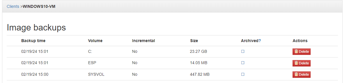

Also, here's what my first backup looks like:
Does this seem correct for a vm installation of Windows 10?
Yes.
