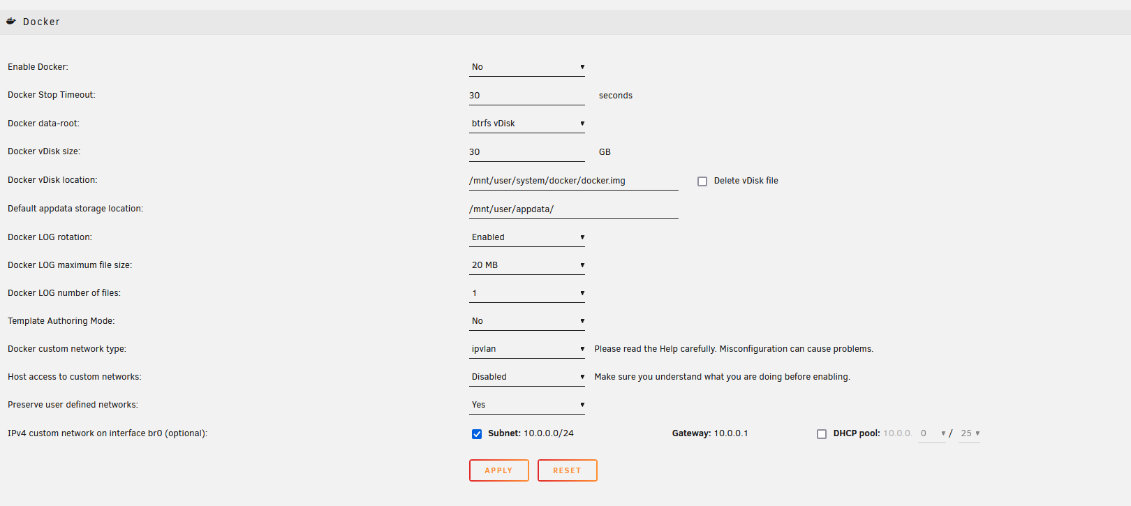

Fantastic, thank you so much for your help! This seems to have gotten rid of the error, but now it appears to have created a few others ones. 😆
It now seems to be complaining about how it is not on a btrfs filesystem and how a dataset is not configured? Any ideas here?
For background, everything Docker-related on my Unraid host is setup on a cache drive formatted with btrfs, with the docker image being a btrfs vDisk (if this matters):
2022-12-31 03:53:28,764 DEBG 'urbackup' stdout output:
MOUNT TEST OK
2022-12-31 03:53:28,767 DEBG 'urbackup' stdout output:
Testing for btrfs...
2022-12-31 03:53:28,772 DEBG 'urbackup' stderr output:
ERROR: not a btrfs filesystem: /media/testA54hj5luZtlorr494
2022-12-31 03:53:28,772 DEBG 'urbackup' stdout output:
TEST FAILED: Creating test btrfs subvolume failed
Testing for zfs...
TEST FAILED: Dataset is not set via /etc/urbackup/dataset
I tried doing a bit of research and it looks this is called via the "urbackup_snapshot_helper test" command. Not sure why it thinks there isn't a btrfs filesystem there (unless the Docker container does not know about the host filesystem type)?
Nonetheless, seriously though, thank you again for your help these past couple of days! 😀
Edited by Evolze
First off those messages are about the "/media" mount which is where urBackup is going to store your backup data. Despite being labeled as errors those are just urBackup testing whether or not it can use btrfs or zfs specific features in the backup location, if it cant then they are not errors. If you are expecting it to make use of the BTRFS filesystem then the container needs to be run as privileged. If you do have the /media location on your cache drive you will need to make it cache only. You can read back in this topic but i dont think unRAIDs mover necessarily plays nice with urbackups storage architecture, it certainly wont with the BTRFS specific features. If you point /media at the array and intend to use the BTRFS specific features you will need to point it directly at a BTRFS formatted disk share.
Ah okay, understood. The cache drive is set to Cache Only and even then, I had no idea these filesystem-specific features existed within UrBackup. It's a good option to have if I decide to go down this path.
Once again, thanks for your help -- Happy New Year! 😀

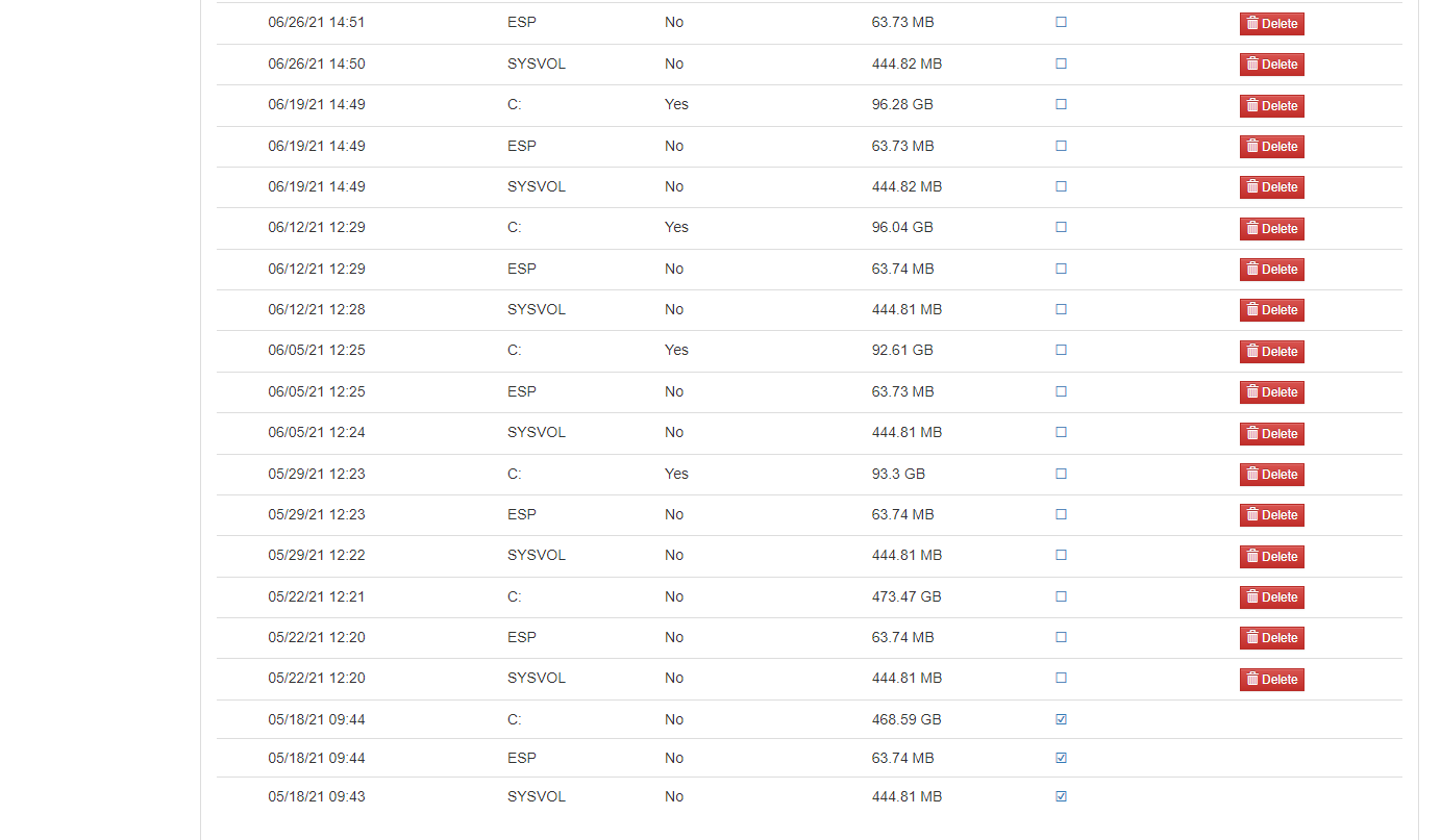

Before I realized I could delete old backup files from within the program itself, I manually deleted a bunch. Now that I know where to find the list to delete them from within the app itself, all those deleted backups are still showing there, and when I try to delete them again I get the error that the files don't exist. Is there a way to refresh this list to remove all non-existent backups?
6 hours ago, Lonewolf147 said:
I'm positive this is a user error issue, but I'm hoping there is a way to fix it.
https://www.urbackup.org/administration_manual.html#x1-10000011.4

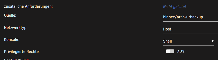

Hello
i can not see the GUI.
but in the log i can see
2023-02-08 08:44:37,642 DEBG 'urbackup' stdout output:
ERROR: HTTP: Failed binding socket to port 55414. Another instance of this application may already be active and bound to this port.
can anybody help me?
(and now, i have no other docker on this port)
7 hours ago, luckyheiko said:
Hello
Are you using Host mode?
yes, but i use urbackup since 1 year and have not chance anything.
is this a 'problem' since the last update, i don't now.
Not a common problem, my instance is up to date and working fine.
Have you powered down and restarted the server? Maybe there is a previous instance that didn't exit properly.
O.o it's to easy, but it works.
than i have with the Plugin CA Backup / Restore Appdata...
Thanks for your help.
