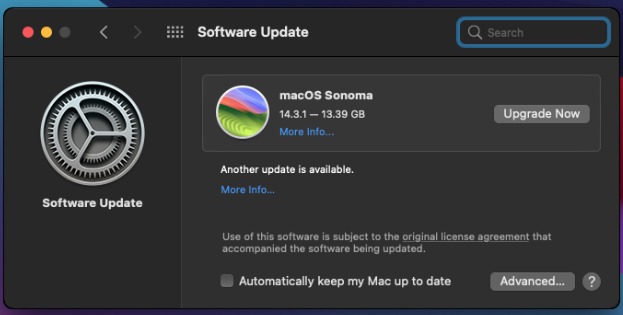

10 hours ago, Kev600 said:
I was able to successfully install BigSur! :)
Now - Does this work?
The current Macinabox has a very old version of Opencore (0.7.8) so you'll have to upgrade opencore to a much newer version (latest is 0.9.8) and update drivers and kexts. Just trying to apply the update to the newly created Big Sur install will fail.
I wrote a basic guide here: https://forums.unraid.net/topic/84601-support-spaceinvaderone-macinabox/?do=findComment&comment=1364505 (previous page) on how I got Ventura working and I also got Sonoma working but Sonoma is much pickier about hardware as Apple has dropped support for quite a lot of legacy hardware in the continuing push with Apple Silicon, especially Broadcom WiFi adapters. There are some workarounds in Sonoma using Opencore Legacy Patcher but these didn't work for me.
Mileage will vary depending on hardware, intel or AMD CPU etc, but if BigSur works well for you and any passed through hardware, Ventura will work but Sonoma will probably require quite a lot of fiddling.
