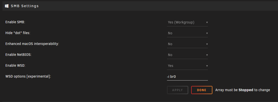

Have all of you with this issue tried the WSD Options setting mentioned in the bug report thread for this problem?
Adding -i br0 to the WSD Options has largely eliminated this problem for me. It is not completely gone but I only see it every 3-4 months or so now.  It's not a fix as it still can occur, but for many it at least greatly lessens the frequency with which the 100% CPU problem occurs.  YMMV.

On 6.9, still happening, issue not fixed. I am using the "-i br0" option, but the process still bugs out after some time.
