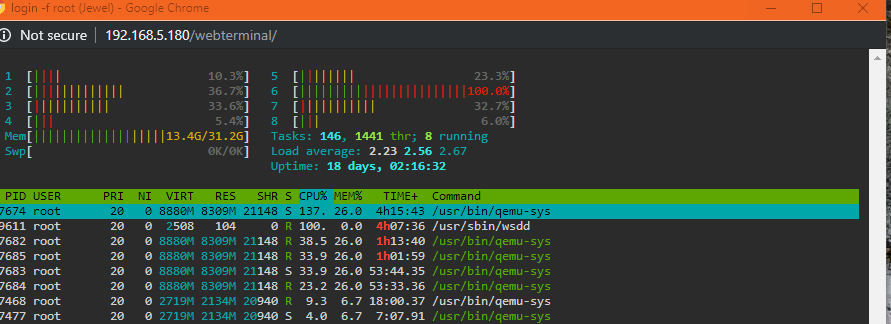

wsdd 100% using 1 core
wsdd was running 100%. I was backing up to backblaze via the VM through SMB. I shut down all dockers and vm's and it was still running high.
Wondering how do i restart the service wsdd? I believe it was at 100% because of the backup happening at that time.

@scubieman I have seen this (wsdd at 100% on 1 core or thread) twice as well.  In both cases, as expected, a reboot fixed it.
It happened when I had an Acronis backup running which backs up a PC/laptop to my unRAID server.  The core/thread changes but one remains pegged at 100% even when the backup completes.  A reboot is require to clear it.
I actually had a bug report ready to go and did not post as I want to gather more info and confirm it only happens during backup.  The last time I saw this was three days ago, but another backup is scheduled for tonight.
Since it is wsdd, this is only a 6.8.0-RC issue.

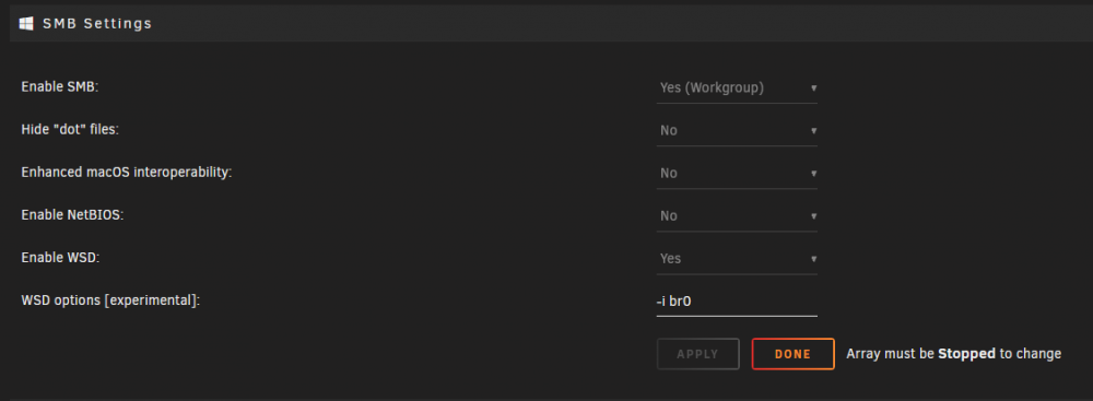

Tried -i br0 but still pegging 1 core
You can disable it, but you may not be able to see the server shares show up under 'network' in Windows 10 clients, but you can still browse them manually by server name or IP

The only sure way to prevent this is to disable wsdd in your unraid settings.
