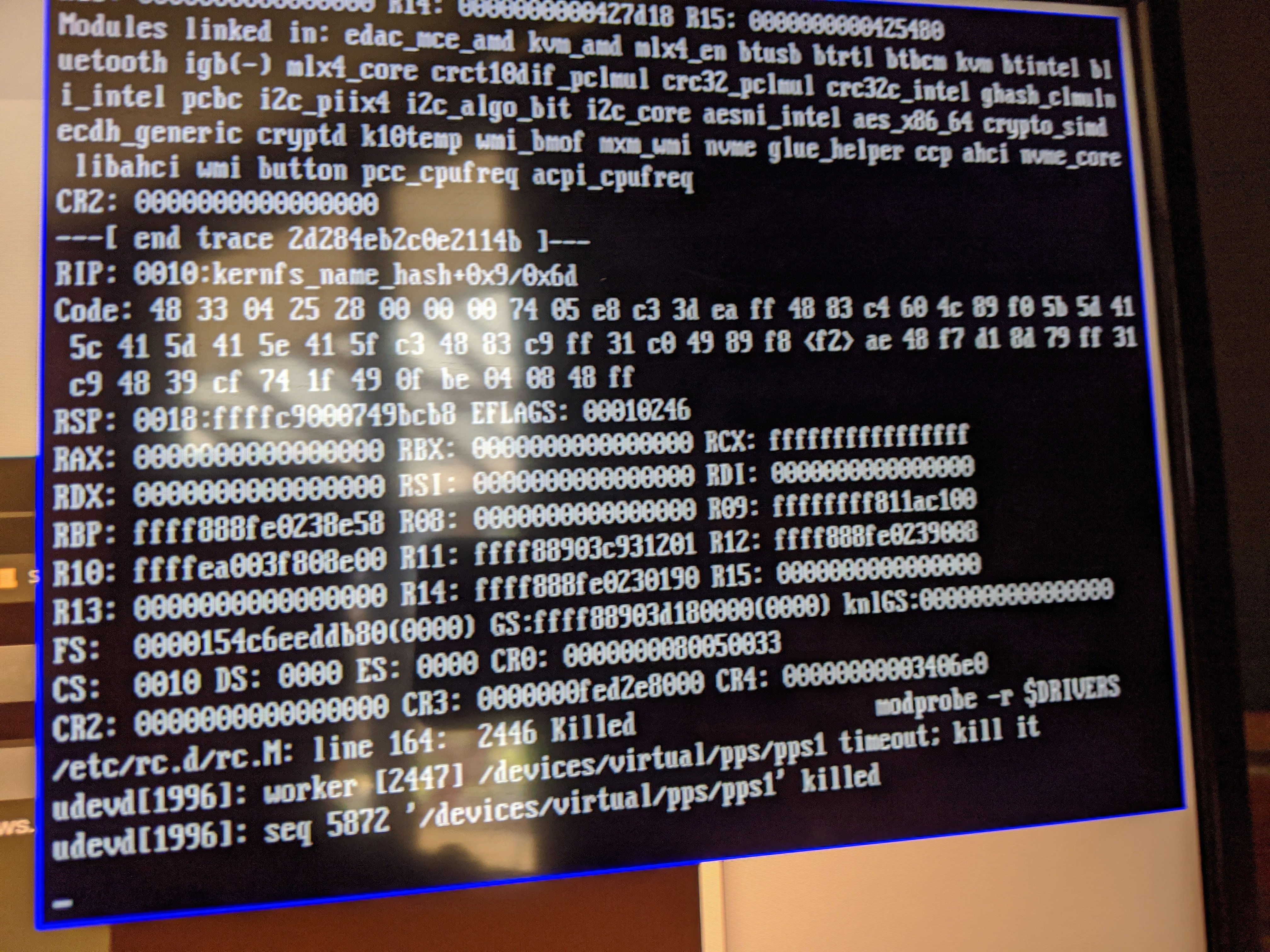

Currently can't boot, killed modprobe -r $drivers hanging.
Had multiple successful boots into 6.8.1, but I just changed GPU (I use GUI boot mode).
Tried power cycling and trying again, no dice.
Safe mode doesn't allow for boot either.
Finally pulled up an out for chkdsk on windows, on completion of check no errors were found.
Popped back to unraid... Still with the same error.
Rolled back hardware, no difference.
Rolled back to previous unraid version as a last measure... Yes I'm finally up and running again (on 6.8.0)
Edited by tjb_altf4
...and because I'm a glutton for punishment I'm going to try the same hardware upgrade under 6.8.0
Successfully upgraded GPU under 6.8.0, which failed and appeared to prevent booting under 6.8.1
Might skip this release...
