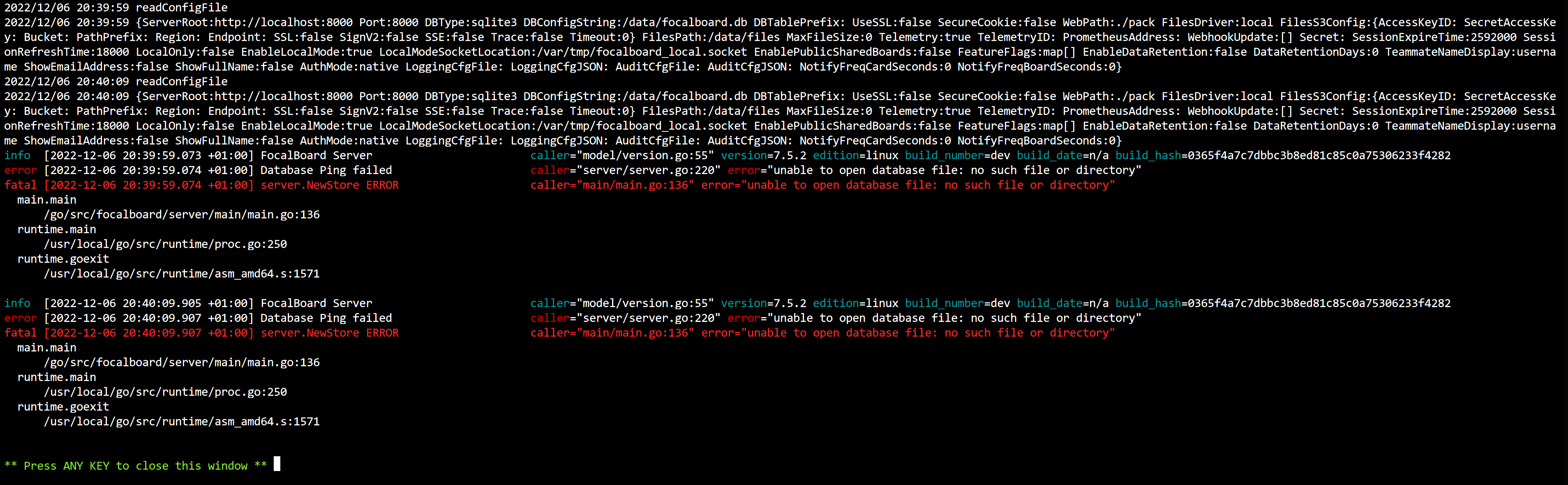

On 12/6/2022 at 8:43 PM, thany said:
Trying to install focalboard. Clean install. I only set the appdata to the correct location.
Surely if a database doesn't exist, can't it just make a new one? Or is it expecting me to magic up an existing database from somewhere?
Same happens to me - any tips?

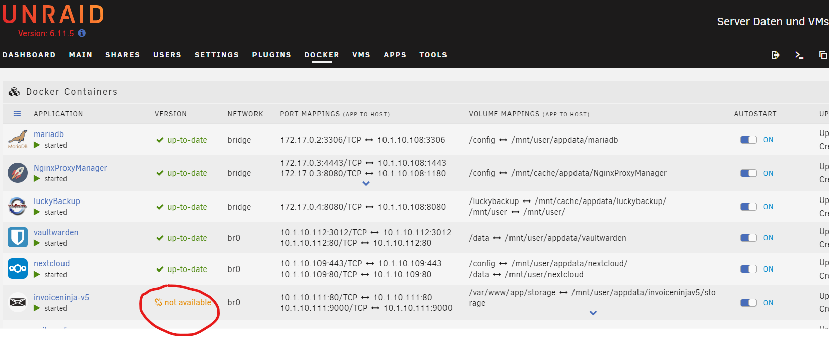

hello everyone, no version of invoice ninja has been available for a few days. Does anyone have an idea?
Thank you.
Thank you.
Seeing the same thing for draw.io as well. Has the repo name changed? Mine is jgraph/drawio
Any update on this?

@thany@aleberro I'm not sure if you managed to get it to work, but I had the same issue with another container, so thought I'd test it out. It's directory permission issue. I chmod 777 the whole focalboard directory, which allowed the container to create a database. I don't know why this happens, though. After creating the db, I reverted to 755 and it still seems to work (but didn't test extensively).

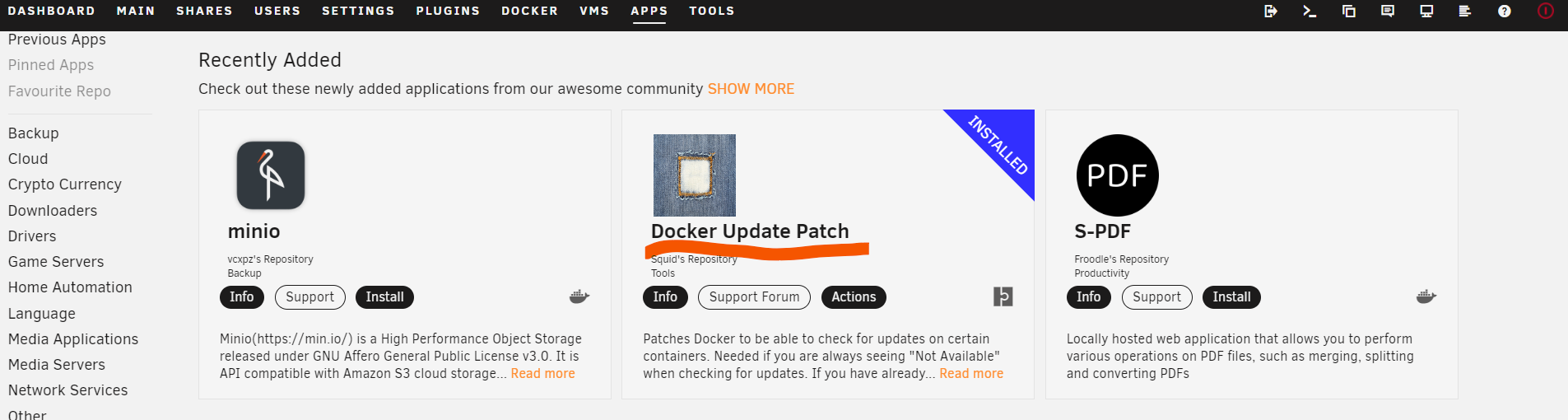

There is a solution as I have just seen. The plugin "Docker Update Patch" works very well. Many thanks to Andrew Zawadzki!!!!
Was it pulled?  I'm not able to find it in the community app.
Nope. Are you on Unraid 6.11?
Ah...6.10.3
So that's it, plugin is only for 6.11.
