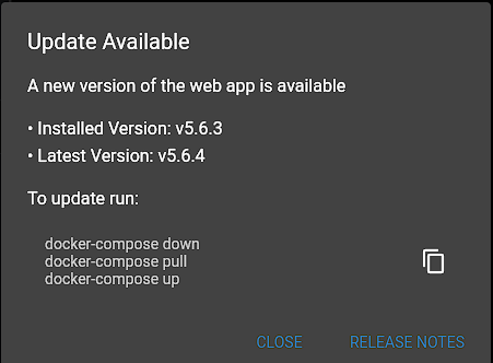

Hi all
I'm trying to use the youtube-dl docker container and I'm getting the attached error. I've tried using ENV variables to increase the max_old_space_size to even 20GB and I still get the same error, it just takes longer to appear.
has anyone seen this or know why?
Thanks
