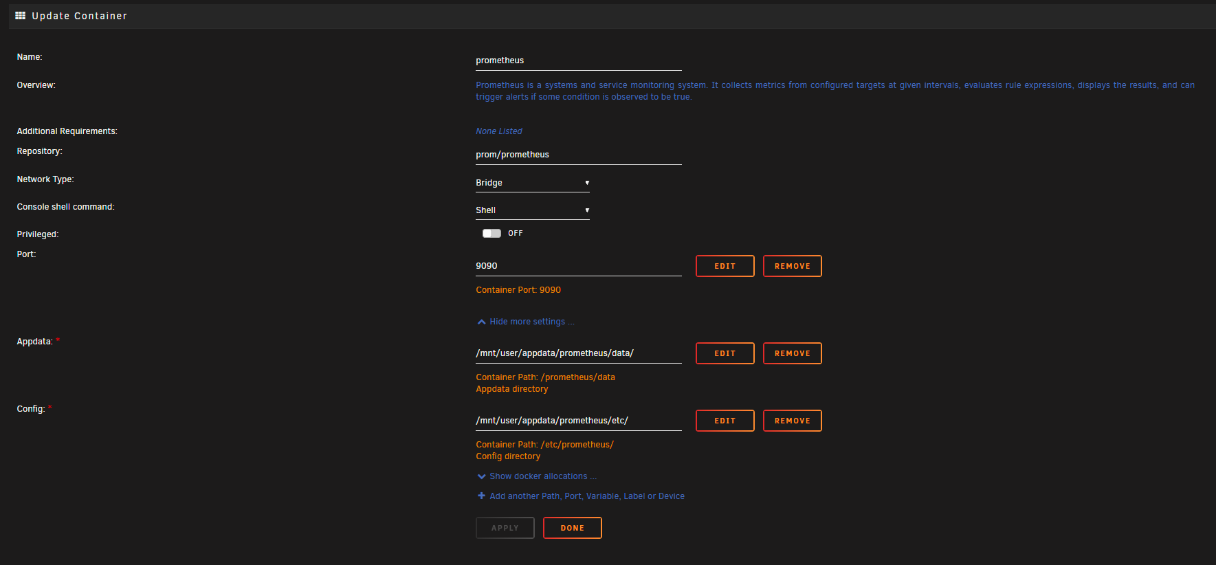

9 hours ago, Rusty6285 said:
Based on troubleshooting guides, I expected to find a mismatched path in the docker, however, they are set as follows:
appdata: /mnt/user/appdata/prometheus/data
config: /mnt/user/appdata/prometheus/etc
Etc has prometheus.yml, but the data directory is empty? is that normal?
You're not telling us the container side of the mount...
From the doc it seems the data dir should be the whole /prometheus, not /prometheus/data
https://prometheus.io/docs/prometheus/latest/installation/#save-your-prometheus-data
hey @Kilrah, what I'm experiencing makes sense if the data is stored inside of /prometheus, but that seems to differ from the templated docker image from community applications?

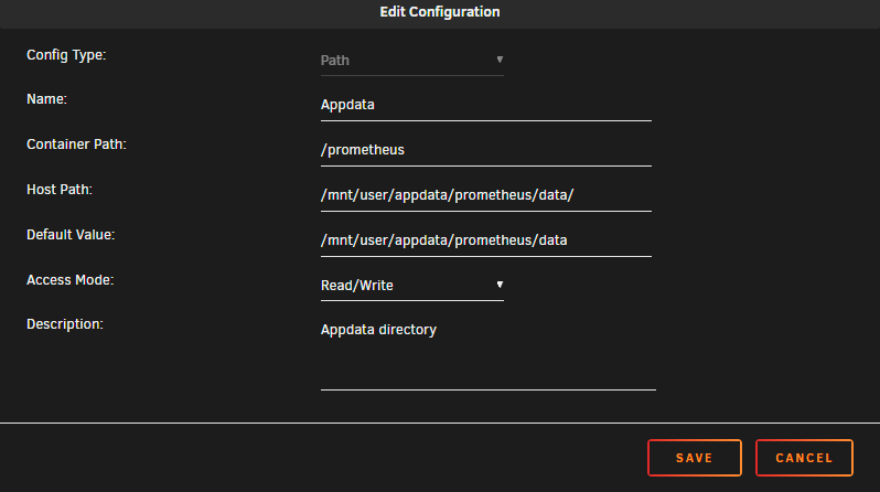

Don't know if it's the case here, but sometimes container developers change things and there's no one to proparate the changes to the template.
Edited by Kilrah
Thanks @Kilrah, I guess I had assumed this thread is where the owner of the template may see this and be able to help!
FWIW, based on the doc you shared I manually changed the template path of 'appdata' container path from /prometheus/data to just /prometheus, and I now see files populating as I'd expect inside of the 'data' folder, inside my appdata folder. I'll monitor if this edit resolves the docker image growth issue.
This is a bit of trial & error on my part, so hopefully the template owner will verify this action if they see this!
Edited by Rusty6285

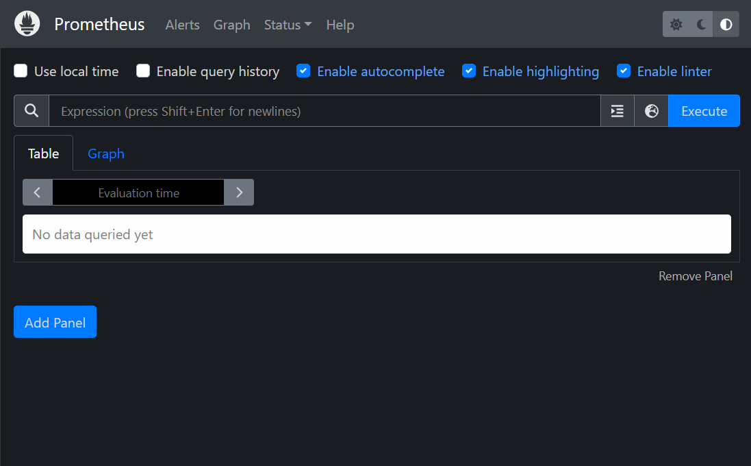

Did you solve this problem?
Yes this stopped docker from filling up! seems the template side of the mapping for appdata is indeed incorrect

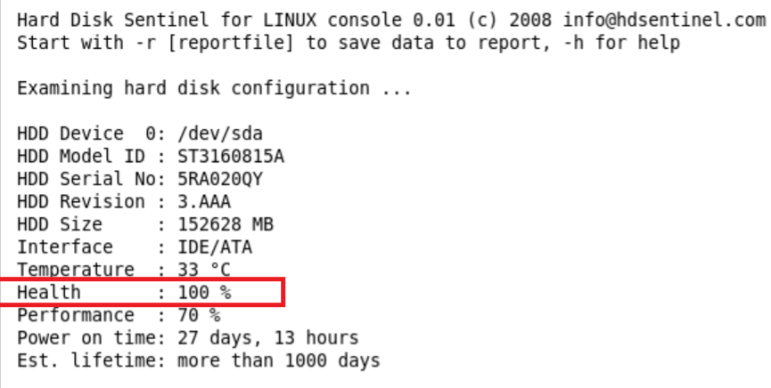

I have just downloaded and run the scrutiny application and am looking for a way to see the overall disk health like such shown via "HD Sentinel". Is this something that is available? or is this something that could be added in a future version?
Any and all infromation on this would be much appriciated.
Thanks

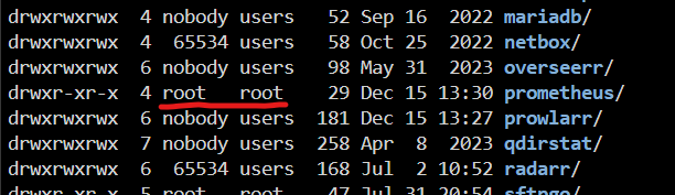

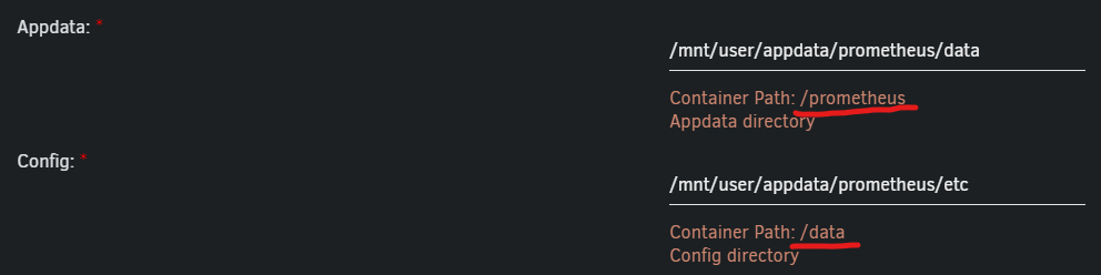

@Kilrah @Rusty6285 Not sure if I am late to the party but, I had issues deploying Prometheus and managed to fix the broken template and got it running. I saw that you had issues in September and maybe you fixed it by now. Appears the template is still not updated though.
I identified two issues with it.
1. The mappings to the yml file is indeed wrong. The correct Docker path for the config should be "/data".
2. For some reason (at least for me) the appdata folder for Prometheus installs with owner root:root:, which is incorrect and hinders it from starting. Viewing the log shows denied permissions etc.
Should be changed to "users" group and your user uid.
Example: "chown -R 65534:users prometheus/"
And its up!
Might be more to fix to get it completely up, for example chmod the appdata folder with correct attributes etc, but at least it's running.
Cheers 🍻

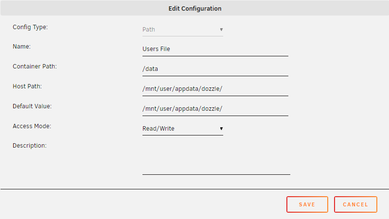

FYSA, Dozzle changed how they do authentication.
https://github.com/amir20/dozzle/issues/2630 explains the simple changes to create a configuration file to replace the environment parameters.
You will need a new "Container Path" for /data where you will put the "users.yml" file.
You will also need to remove the "Username" and "Password" fields from the template for Dozzle to start
Edited by martial
As stated by martial, the new Dozzle needs some changes.  Here are a couple of quick reference screenshots of the new path and variable that had to be added.
