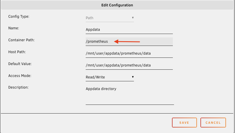

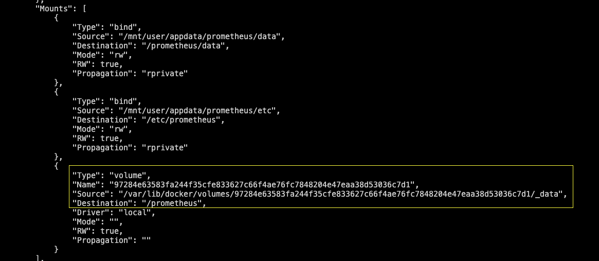

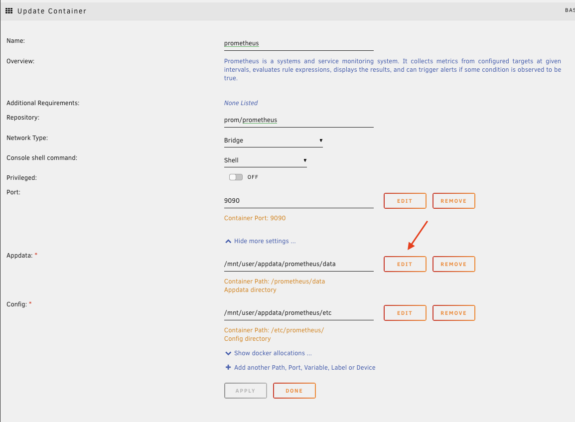

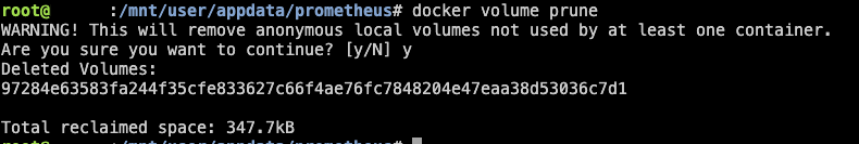

  • Hi   i fixed it by changing the rights of the data folder in /appdata/prometheus   chown -R 65534:65534 data   Maybe that helps you guys also.

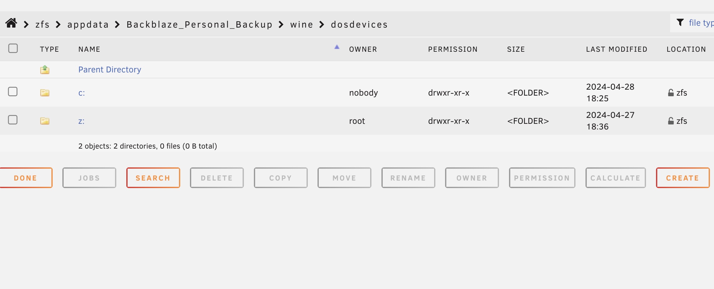

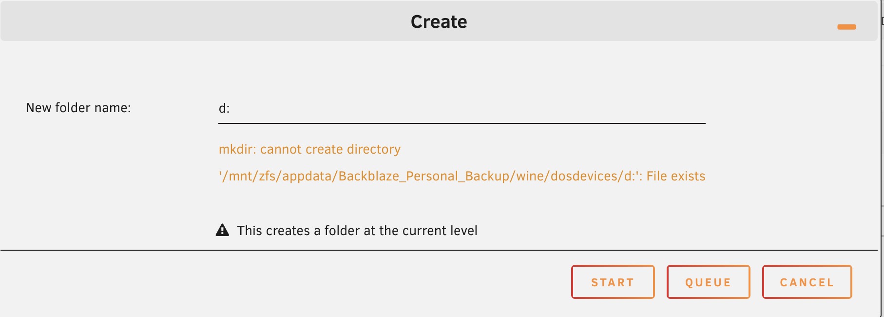

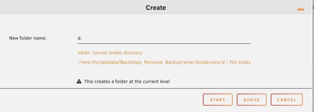

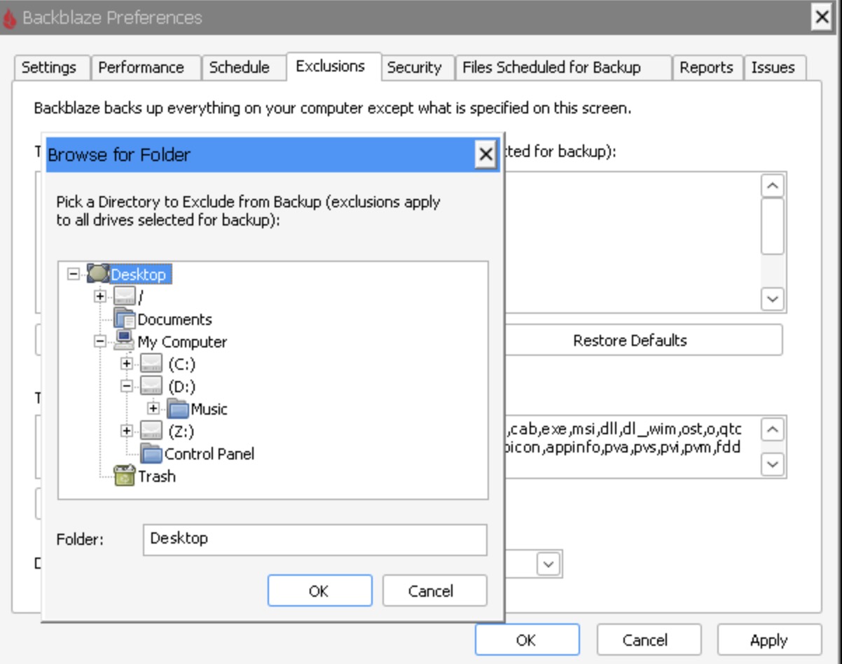

On 2/8/2024 at 8:46 AM, drparton21 said:
On Backblaze_Personal_Backup, I do not see a D drive. I only see a C and a Z. Also, when I try to point the temp folder for it at z:\anything (or z:\d_drive\temp, even), I get a message telling me that backblaze doesn't have read/write access to that folder. However, it's a folder that I applied chmod777 to, even. Not sure where to go from here--- has anyone else ran into this?
Did you happen to find a workaround for this? I am having the same issue.

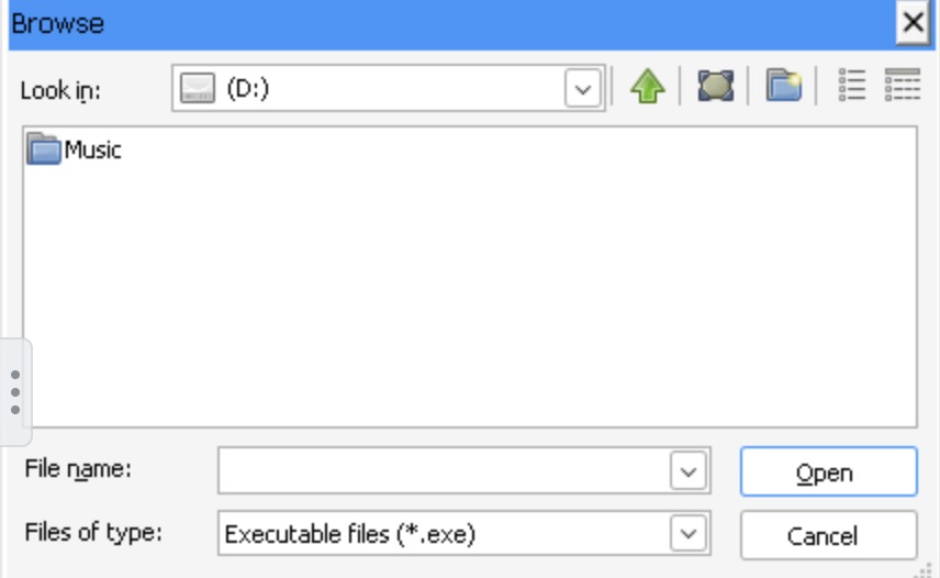

I'm having issues accessing the D:\ drive within the container. Any suggestions?

On 2/23/2024 at 12:41 AM, yoleska said:
Well, crud - looking at the Status > Command-Line Flags, I see this:
--storage.tsdb.path    /prometheus
That should be /prometheus/data.   I'm not sure how the best way to change this.
I noticed this too when troubleshooting why my docker.img was filling up. The mismatch was causing the Prometheus container to use a docker volume instead of the appdata path. I'm not sure if this is the correct way to fix it, but here is what I did and it seems to be working so far.
  1. Stop the Prometheus container
  2. Open an Unraid Terminal Window and type:
    docker container inspect prometheus
  3. In the Mounts section there should be a "Type": "volume". Copy the path in the "Source": field
    1429123628_Screenshot2024-04-23at10_14_41AM.thumb.png.8abb610d468c924f5826bc25afb5bc1d.png
  4. Copy the data from that volume to the appdata folder:
    cp -a <<Source Path>> /mnt/user/appdata/prometheus/data
    860951954_Screenshot2024-04-23at10_39_35AM.thumb.png.d68d933edd2ecf1456cc43f3ddb44f95.png
  5. Edit the Prometheus container:
    1. Click on Show More Settings ...
    2. Edit the Appdata setting158275213_Screenshot2024-04-23at10_26_30AM.thumb.png.30401d0a0fc9d7c08cd662c26539dc08.png
    3. Change Container Path from /prometheus/data to /prometheus1696055630_Screenshot2024-04-23at10_27_33AM.png.6aa7bbbdc71fc5f49a087d2ce1b69320.png
    4. Click Save then Apply
  6. You should be able to start the container now
  7. Once you're happy with everything you can clean up the Docker volumes with
    docker volume prune
Hopefully this helps!
I have the same issue myself. I've tried using both the normal deployment with `tessypowder/backblaze-personal-wine` and `tessypowder/backblaze-personal-wine:ubuntu22` but neither is seeing a Z drive.
I tried fully deleting the app data foldering & docker image, to reinstall with a completely clean slate, but no change. Right now the backblaze docker is effectively useless. 😓
I was finally able to fix this myself by running the command and confirming the container wasn't getting access to the main storage.
docker exec --user app backblaze_personal_backup ls -la /config/wine/dosdevices/
So, I ran this command to manually mount the storage drive.
docker exec --user app backblaze_personal_backup ln -s /backup_volume/ /config/wine/dosdevices/d:
Found the solution in the container's git documentation https://github.com/JonathanTreffler/backblaze-personal-wine-container#volumes
That seemed to half work!
The D: drive is now visible in the container UI. However, only one of the folders from my Unraid system is visible within it - my Music folder. Also rather strangely, after running the command you shared, a D: drive became visible as mentioned. But looking in the directory in Unraid, there is no d: drive. When I try and "create" a folder called "d:" next to the c: and z: folders, Unraid gives me an error saying that it already exists.
I'm not sure how/why this is the case. Any suggestions?
