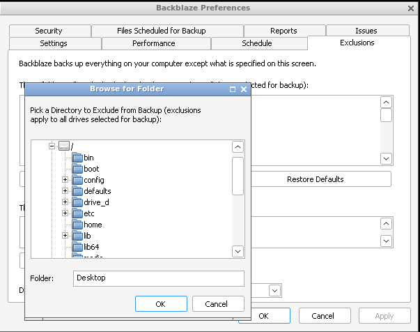

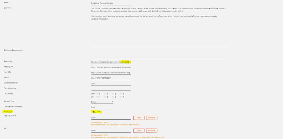

i believe I am running into permissions issues? I follow the steps and can see drive D but can not access it. Permissions for /mnt/user are nobody/users. I know wine uses app/app but I don’t feel like the answer of changing /mnt/user permissions is correct? It might break things?
I seem to have fixed this with the following changes to the setup, ubuntu18 repo, priveledged container, and adding USER_ID/GROUP_ID variables with a value of 0 so the container runs as root.

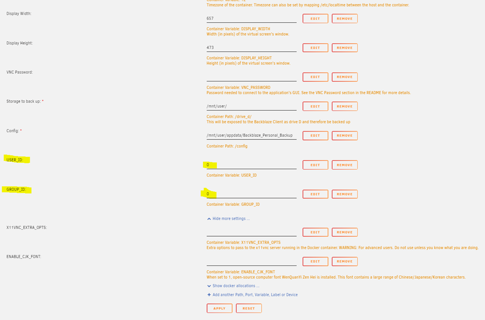

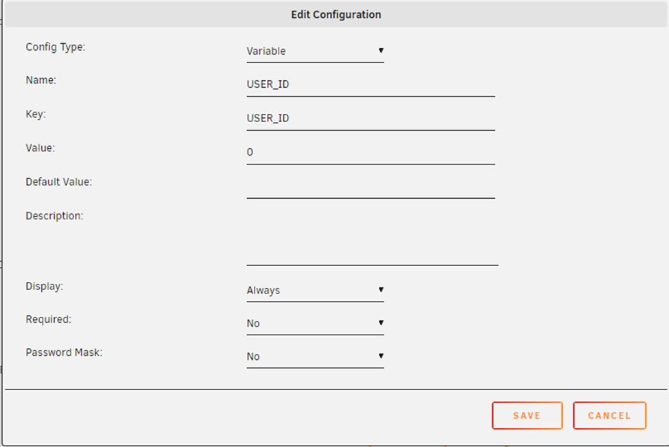

I edited that post with my fix. Mine is still running fine with the permissions and such changed.

8 hours ago, bubbadrk said:
I ain’t gonna do that but I’ll help for free. Screen shot your config and post it. I don’t check here too often so it might be some time. Also what errors you are getting
OK, thanks. Are these settings correct -- based on your recommendation?
Edited by newoski
That is exactly what I have. Possible your permissions are different but I doubt it. Have you tried deleting the container and erasing the appdata and re-installing with these settings?
deleting and reinstalling w these did the trick!!!

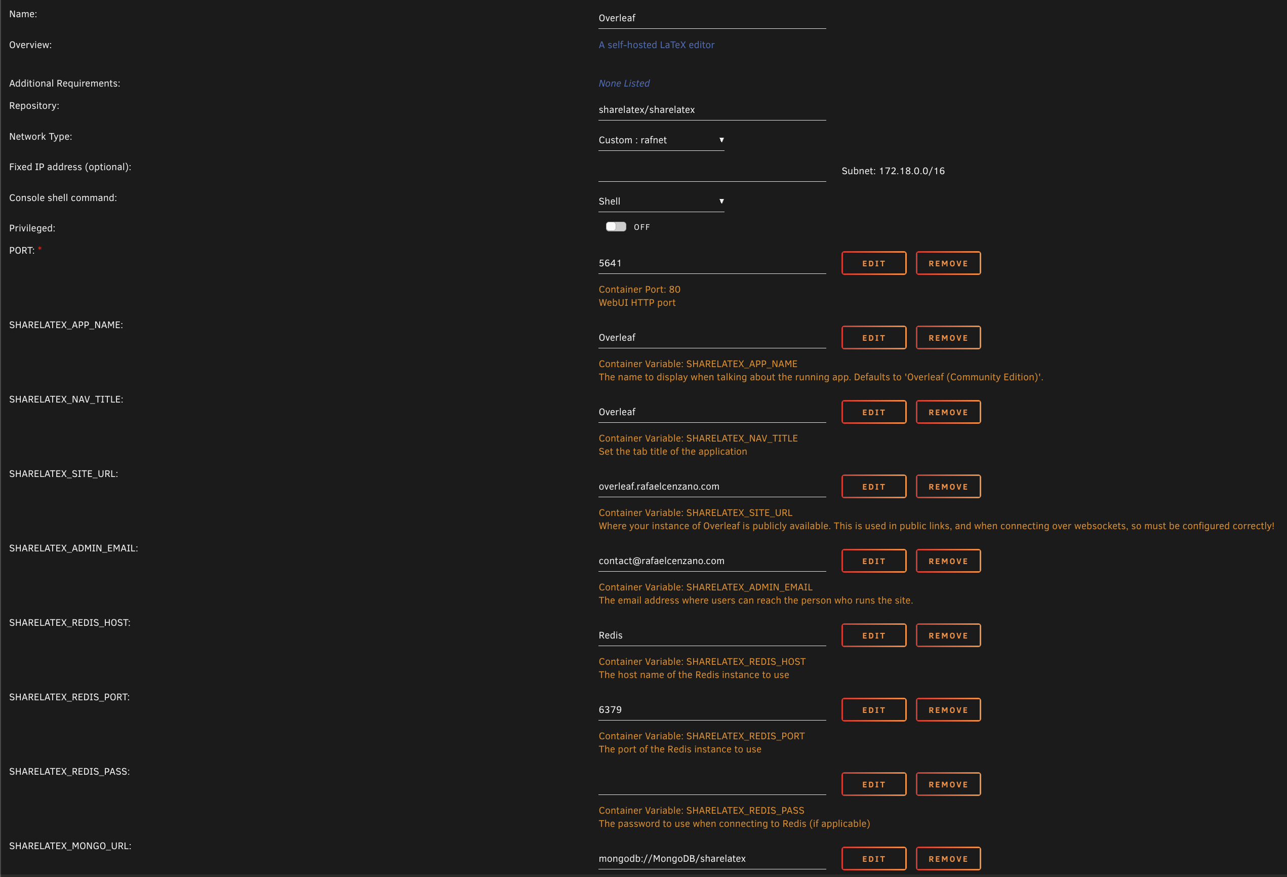

I'm trying to setup sharelatex and i'm hitting an issue with mongodb but I'm using the version specified by the overleaf setup mongo:4.4. Is there something i'm missing or something I should have setup in mongodb or sharelatex differently?
mongodb was setup just by installing the template from community applications and I attached an image of my sharelatex docker config.
I haven't found anything online that explains any steps besides just installing redis, mongodb, and sharelatex so i'm really confused why this is an issue given i matched the mongodb version as mentioned.

*** Running /etc/my_init.d/00_make_sharelatex_data_dirs.sh...
*** Running /etc/my_init.d/00_regen_sharelatex_secrets.sh...
*** Running /etc/my_init.d/00_regen_ssh_host_keys.sh...
*** Running /etc/my_init.d/00_restore_site_status...
*** Running /etc/my_init.d/00_set_docker_host_ipaddress.sh...
*** Running /etc/my_init.d/01_nginx_config_template.sh...
*** Running /etc/my_init.d/10_delete_old_logs.sh...
*** Running /etc/my_init.d/10_syslog-ng.init...
*** Running /etc/my_init.d/98_check_db_access.sh...
Mongo instance doesn't support transactions
MongoServerError: Transaction numbers are only allowed on a replica set member or mongos
    at Connection.onMessage (/overleaf/services/web/node_modules/mongodb/lib/cmap/connection.js:231:30)
    at MessageStream.<anonymous> (/overleaf/services/web/node_modules/mongodb/lib/cmap/connection.js:61:60)
    at MessageStream.emit (node:events:517:28)
    at processIncomingData (/overleaf/services/web/node_modules/mongodb/lib/cmap/message_stream.js:125:16)
    at MessageStream._write (/overleaf/services/web/node_modules/mongodb/lib/cmap/message_stream.js:33:9)
    at writeOrBuffer (node:internal/streams/writable:392:12)
    at _write (node:internal/streams/writable:333:10)
    at Writable.write (node:internal/streams/writable:337:10)
    at Socket.ondata (node:internal/streams/readable:777:22)
    at Socket.emit (node:events:517:28) {
  ok: 0,
  code: 20,
  codeName: 'IllegalOperation',
  [Symbol(errorLabels)]: Set(0) {}
*** /etc/my_init.d/98_check_db_access.sh failed with status 1

I was able to get past this by making my repository: tessypowder/backblaze-personal-wine:v1.5
However, I'm running into issues with read/write on the D drive.
Thank you for this, I was stuck at a black screen on my docker container suddenly and this got my backup running again. Really appreciate you.
