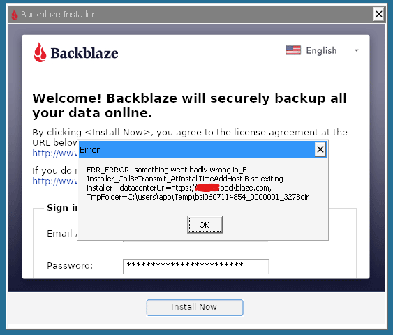

Since yesterday I'm trying to install the Backblaze Personal Backup docker, however it ends with an error after signing in with a Backblaze account (trial). Already tried different versions, but no difference.
Log: [app         ] wine: failed to open "/config/wine/drive_c/Program Files (x86)/Backblaze/bzbui.exe": c0000135
After pressing 'Ok' it just stops.
Anyone else experiencing the same issue?

New version released today which solved the described issue. However I gave up and give Duplicati a try since Backblaze doesn't recognize the mapped docker folder to be processed for the backup.

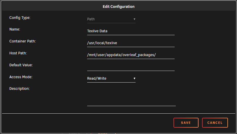

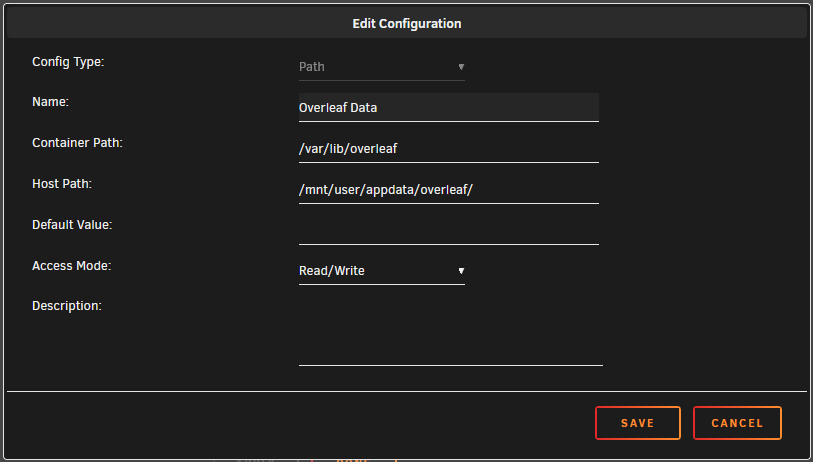

    2.3 You must add the following path (by clicking on the little blue plus at the bottom of the template), to install texlive in a location that is outside your dockerfile. If you don't do that, 8 GB of data is being installed in your dockerfile, which is not recommended.
    Also add the following where we can save some commands later, that otherwise you would need to type manually after every restart of your server:
    Note: You might want to adjust the Host Path to point to your desired location on your array. The entry in “Name” can be whatever you like.

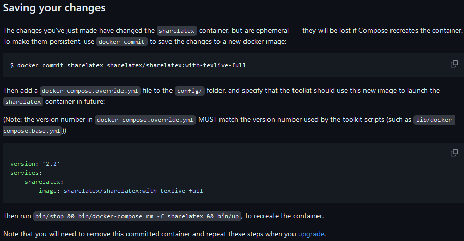

  5. To fix this, we need to install the full texlive-installation, by opening the Overleaf-console and running the following commands:
    5.1  Download texlive by typing the following command:
    wget https://mirror.ctan.org/systems/texlive/tlnet/update-tlmgr-latest.sh
    5.2 Install all texlive packages (This might take a long time, since over 4,000 packages are being installed):
    tlmgr install scheme-full
    5.3 Once the installation is finished, run the following command (most packages might work without it, but I had problems with biblatex):
    tlmgr path add

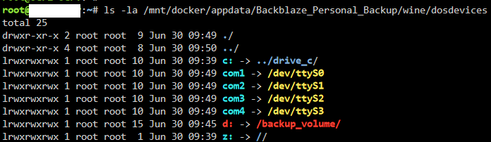

EDIT/UPDATE: looking directly at ls -la /config/wine/dosdevices/ from the unraid terminal, not the dockers terminal, i noticed the symlink for d: was broken. Created a backup_volume folder in config/wine fixed the broken symlink but the container still does not find any files to backup. Navigating the d: within wine I can access the files and modify them. I really am stumped if anyone has an idea.

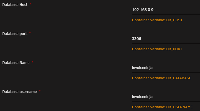

Are there any instructions for installing InvoiceNinja on Unraid anywhere? I can't get the app working...
I set up a database in MariaDB. Triple-checked my server, DB user, DB password, etc...But InvoiceNinja still crashes whenever I start it.
Here's what the container log says:
database/schema/mysql-schema.sql .............................. 47.05ms FAIL
In Process.php line 269:
  The command "mysql  --user="${:LARAVEL_LOAD_USER}" --password="${:LARAVEL_L
  OAD_PASSWORD}" --host="${:LARAVEL_LOAD_HOST}" --port="${:LARAVEL_LOAD_PORT}
  " --database="${:LARAVEL_LOAD_DATABASE}" < "${:LARAVEL_LOAD_PATH}"" failed.
  Exit Code: 1(General error)
  Working directory: /var/www/app
  Output:
  Error Output:
  ERROR 2005 (HY000): Unknown server host '192.168.1.100:XXXX' (-2)
You left "XXXX"es instead of putting the correct port for the DB?
No, I just masked that before posting...
No reason to but...
Nothing special here, works fine
On what networks are the 2 containers?
I realize that...don't know why I did. 🙃
MariaDB is on bridge. InvoiceNinja is on my reverse proxy network.
UPDATE: I put them both on my reverse proxy network and it still had the same problem.
