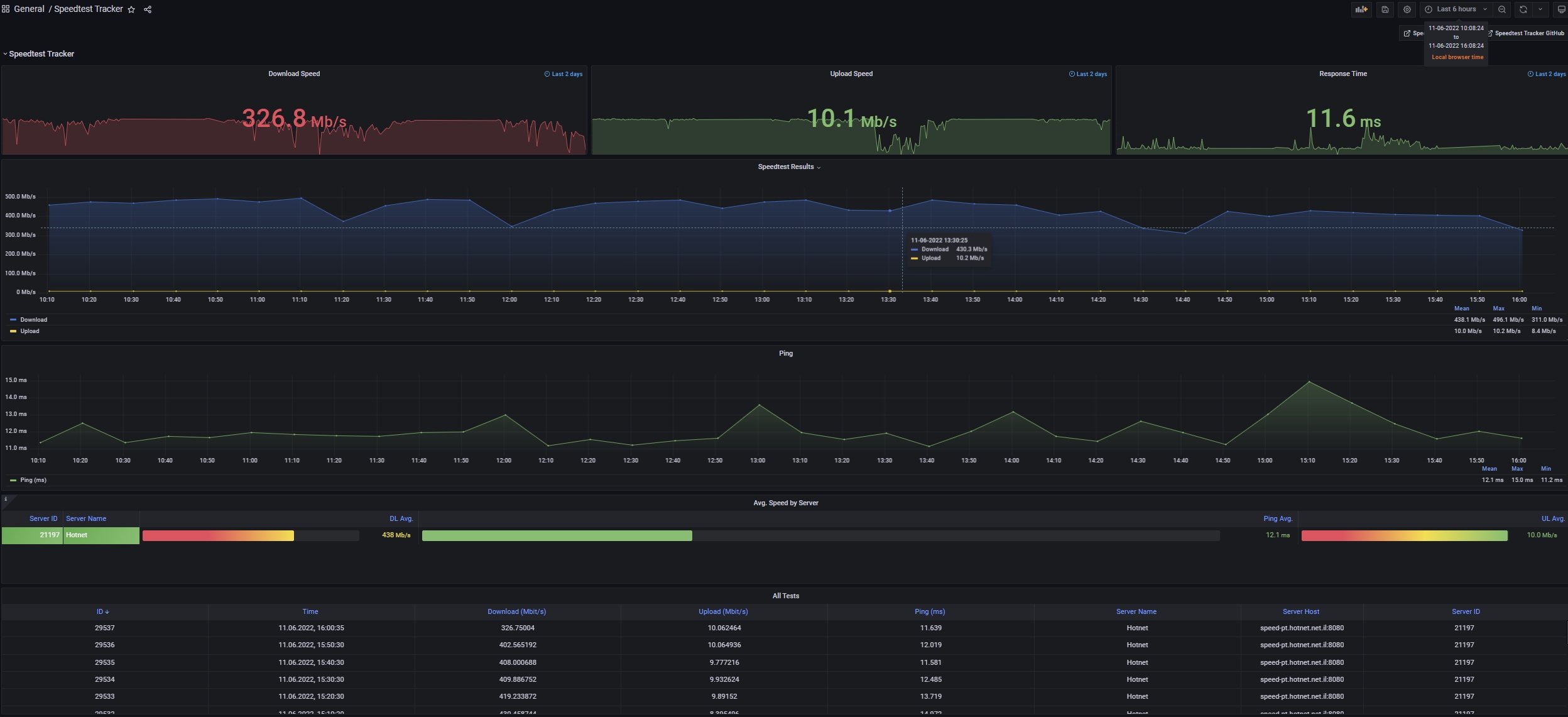

Finaly builded speedtest tracker on bucket linked to influxdbv1 in influxdbv2 on grafana on 16339
if someone interested i can write the steps here , its not the easyest way ....
but the easy way just install influxdbv1 ..
Please also check here https://github.com/henrywhitaker3/Speedtest-Tracker/issues/954

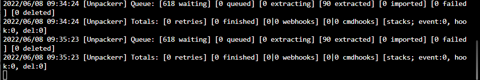

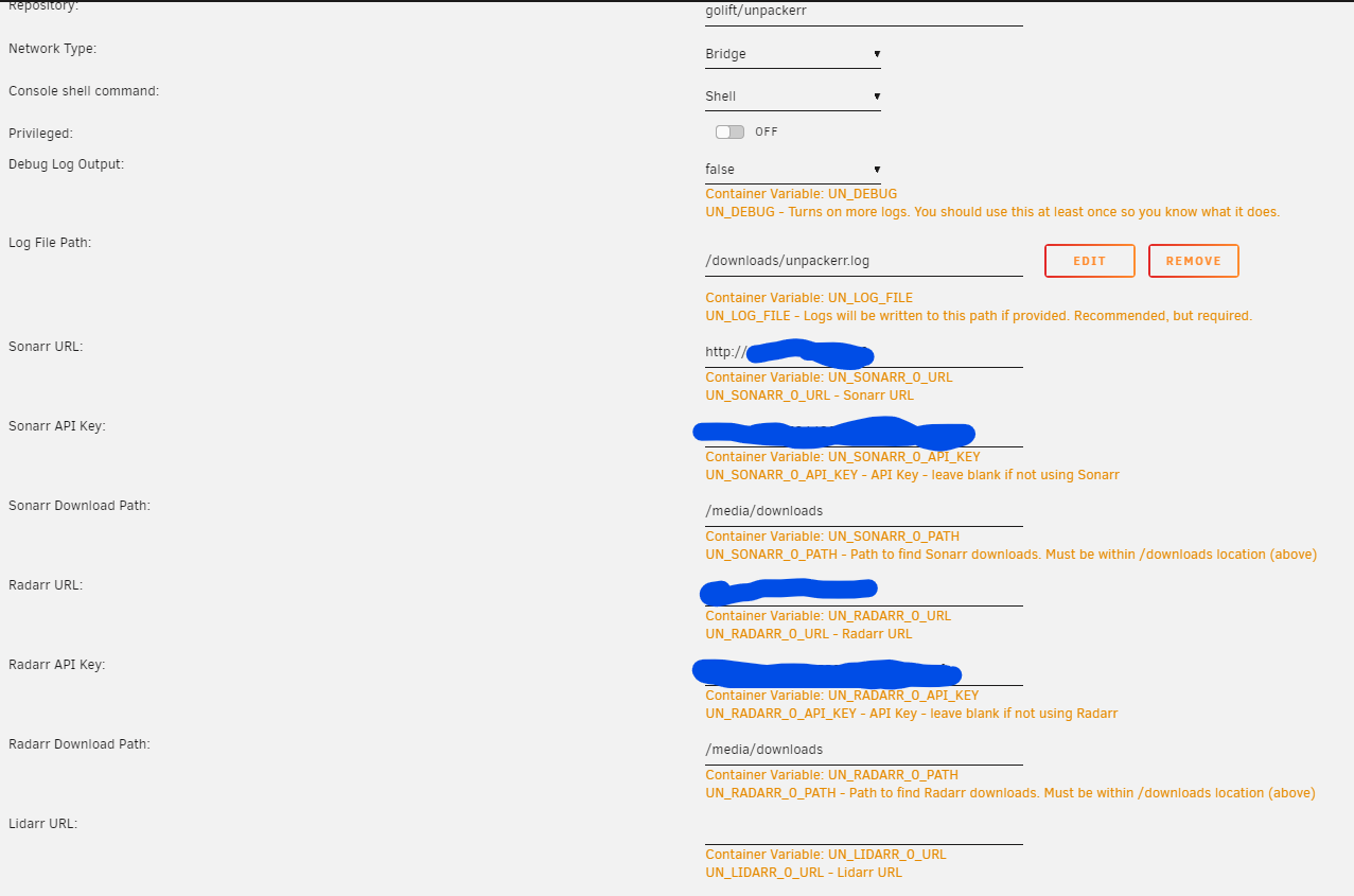

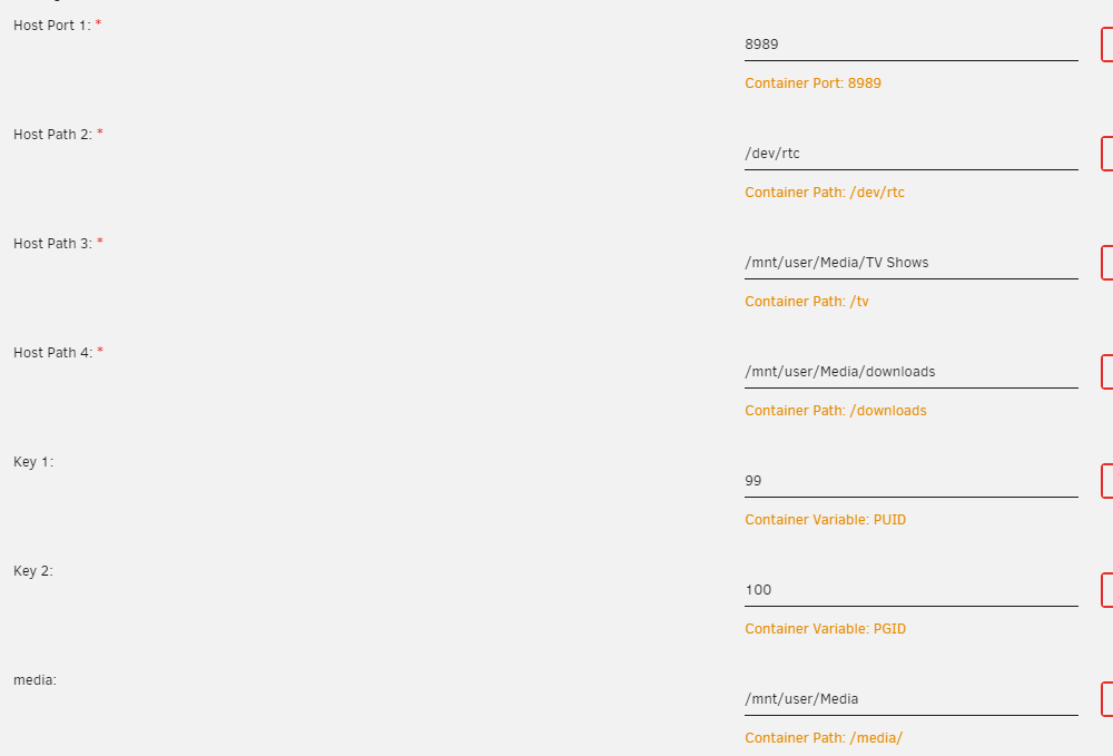

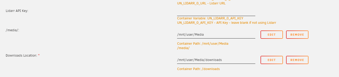

I have been trying for days to get Unpackerr working, to no avail.
Unpackerr Settings:
Sonarr settings:
so my host paths are:
/mnt/user/Media/downloads <--incomplete downloads
/mnt/user/Media/downloads/Complete <--complete downloads
/mnt/user/Media/TV Shows <--TV shows directory
Unpacker log looks like this:
Finally uploaded my dashboard to Grafana with instructions
Speedtest Tracker - InfluxDBv2 https://grafana.com/grafana/dashboards/16428
Unpackerr Settings:
Sonarr settings:
bumping this?
