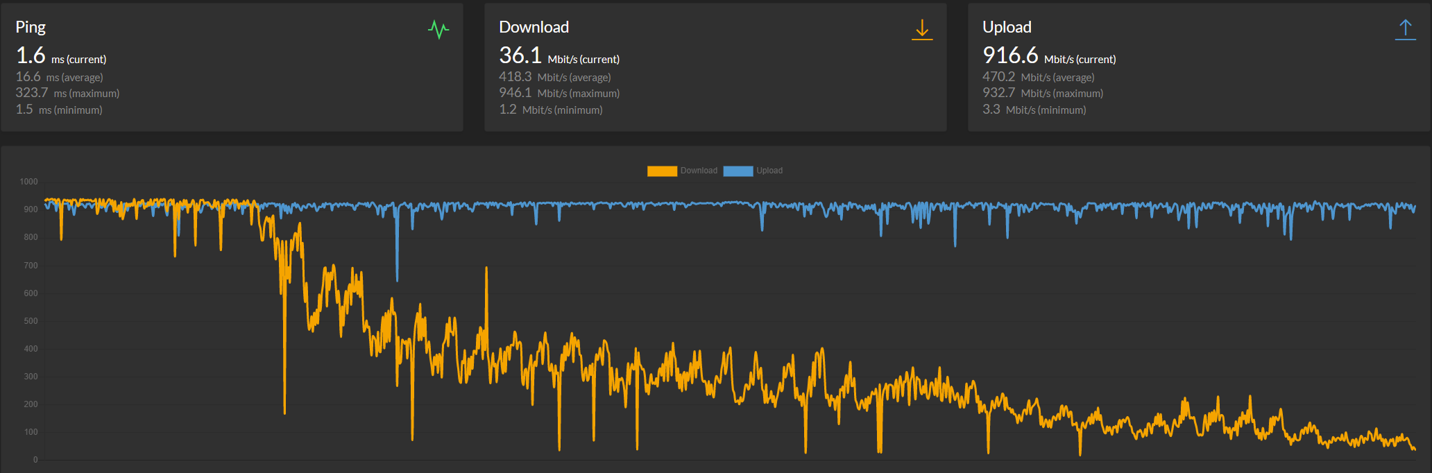

As it turns out, I've been losing ~7% of my download bandwidth since August 26th about every 3 days.  Tech support is sending someone out to check my line and the main fiber panel at the end of my street Tuesday, October 5th.  And a large part of that was due to this information.  I didn't notice it before because it was slowly and slowly dropping.
45 day graph:
I'm supposed to be getting ~950Mb/s down, I'm NOW getting ~36Mb/s down!  Yikes!  We both are wondering if I'll be at dial-up speeds by Tuesday...  Time to bust out an old US Robotics 56.6...

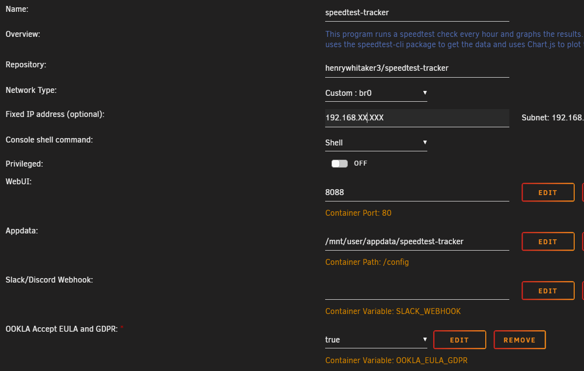

Recently installed speedtest-tracker and tests run successfully, but have errors daily.  Below is recent log entries:
{"type":"log","timestamp":"2021-10-17T17:00:07Z","message":"Failed to resolve host name. Cancelling test suite.","level":"error"}

Not really sure what is causing the issue so would appreciate any insight others may have.
Here is my config:
