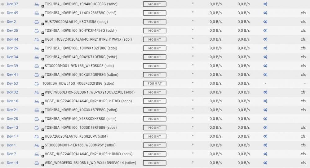

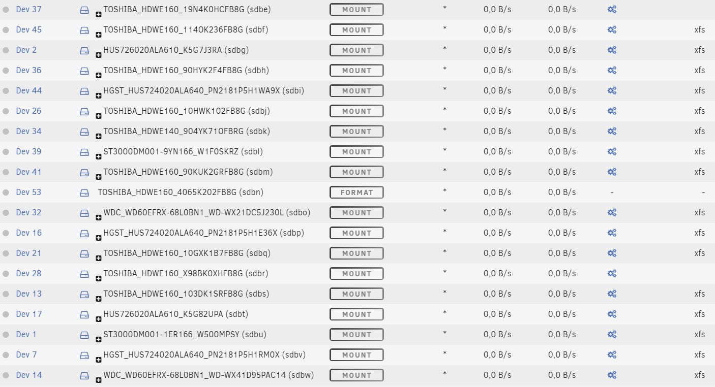

UD does not leave "Format" State for a passed through disk after the rebuilt of this disk finishes in the VM.
Let me explain:
Several disks are passed through to an Unraid VM. These disks are marked as passed through within UD. One of the passed through disks had to be replaced within the VM. During the rebuild within the VM, UD did show the "Format" button for this passed through disk. Everythings fine until here.
Now the disk is successfully rebuilt within the VM and the VM is working as usual.
UD still shows the "Format" button and no plus sign (for the partition).
Please have a look at the attached screenshot. The disk is formatted (rebuild), working and is written to. But UD still shows no + sign (for the partition) and still shows the Format text.
Thanks for listening.
Edited by hawihoney
2 hours ago, NiLon said:
For SMB at least you don't need to disable hard links nor cache to fix stale file handles.
This is fixed in the latest release of UD.
Linux does not recognize the file format and/or partition layout.  If Linux does not recognize the file format, UD can't show it.
Thanks for your answer.
To rebuild I did shutdown the VM, replaced the disk on the host backplane and did start the VM with changed disk/by-id again. Within the VM the rebuild was started and UD on host showed "Format" immediately. Now this "Format" does not go away. I do understand that the host still does not show the Partition (-part1) in /dev/disk/by-id and that's the reason why UD can't show the existing partition.
May I vote for additional options, or a slightly changed handling, in UD where a.) partitions for disks that are marked as passed through never become shown at all and b.) the text "Format" is never shown for disks that are marked as passed through.
Reason: Consider a host with lots of disks and VMs, equipped with a professional backplane. It's not required to shutdown all VMs and the host to swap a disk that is passed through to a single VM.
In such an environment partitions on passed through disks are not required to be shown on the host. And it is not required to show the Format text for a passed through disks.
It does not harm the way it is. But it would look even more professional for large scale systems.
Please have a look at the screenshot. All these disks are passed through to VMs, they are marked as passed through (that's why Mount is not clickable - good). Format is still shown (- not good). And all partitions are expandable if there's a filesystem (- really not needed). Why would a host need to show partitions for disks that are completely passed through to a VM?
Edited by hawihoney
