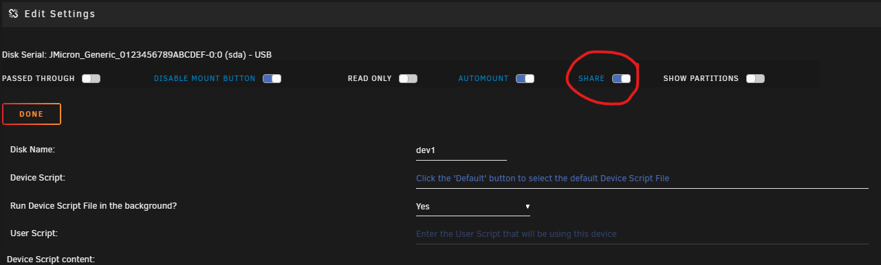

Im hoping someone can help me with this issue but for some reason if i try and un-share my external HDD in UD when i click the circled switch in the image below, the switch goes to the "off" position as expected but then as soon as i click "Save" and go back to this page the switch is in the "On" position again.
After i go through this process the HDD does actually become unshared and cant be seen by my network users which is what i want but as soon as UD gets an update or I restart my Unraid the HDD is automatically shared again 😞
I think it has something to do with that switch and if i can get it so stay in the "Off" position it might solve this issue of auto re-sharing again after a reboot or UD update.
This has been happening for a while now and i dont know what else to do to try and fix it. Any help would be appreciated 🙂

You don't need to click 'Save' for the share switch to be saved.  Just changing the switch will save the switch status.  That's why there is a 'Done' button right below the switches.  Change a switch, then click 'Done' does the trick.
It is working for me.  I suspect you might have a corrupted UD config file on your flash drive.  I would take the flash drive to a PC and run a file system check on it.

Uninstalling and re-installing UD won't change anything because the configuration files are not removed and re-installed, or changed.
A couple options:
  • If this is your only UD disk device, delete the /flash/config/plugins/unassigned.devices/unassigned.devices.cfg file and then click the double arrow icon on the UD page.  You'll need to re-apply any device settings.  Don't do this if you have any encrypted devices.  You'll lose the password seed.
  • You could use an editor and take a look at the /flash/config/plugins/unassigned.devices/unassigned.devices.cfg file for any obvious issues.  The device might be duplicated in the UD config file.  If you make any changes there, be sure to click the double arrow icon on the UD page to update the copy of the cfg file in ram that UD uses for updating the UD page.
  • Edit the /flash/config/plugins/unassigned.devices/unassigned.devices.cfg and remove the entries for the trouoblesome device.  Again, you'll need to click the double arrow icon to refresh the UD page.

Yes, it only affects the UD device.  Honestly, I think you have some issues on the flash device.
Before you do anything, uninstall and re-install UD, then click on the double arrows on the UD page.  The setting 'share.1' is set for no at the moment and is what you want.  The '.1' specifies the partition for that setting.  It is all correct.
Just tried to uninstall and re-install and then clicked on the double arrows and no joy unfortunately 😞
Ill take your advice and when im back home again ill run a check on the flash and see what it comes back with. Hopefully whatever the issue is I can fix it 🙂
If it is something on the Flash device would the solution be to backup the old flash and then format the flash drive and place the backup back on the flash? I guess thats assuming that my flash backup doesnt have the same issues.
