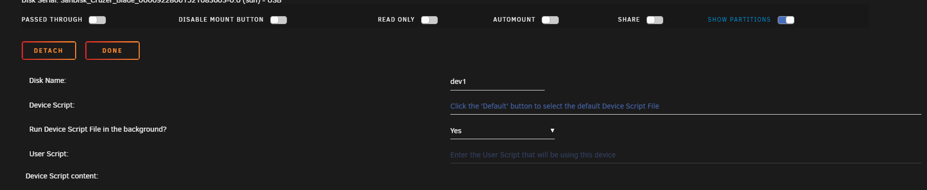

Can't get disk share to work - the "share" toggle is enabled for both the drive and partition, but it's not showing up. Interestingly, when I hover over the settings cogwheel for both, they each say "Share: No" despite the slider being enabled in settings. Any ideas? Thanks.

6 hours ago, mattalat said:
I have confirmed that it is set to Public.
The device is not set to share as you have said from the tooltip:
Mar 17 20:13:49 Wyse unassigned.devices: Device '/dev/sdb1' is not set to be shared.
Show a screen shot of the device settings.

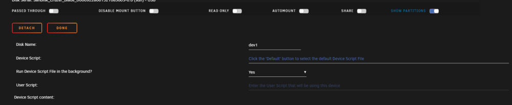

22 hours ago, Erich said:
I have an external drive plugged into my Unraid server. However, the external drive does not show up in my Network connections in windows. If I try to connect to the external drive (named "Ext_Disk") from a windows 10 machine, I get an error message saying that Windows cannot access or find this location. I am trying to connect by using "\\Phoenix\Ext_Disk".
In Unraid, I have tried setting "Enable SMB Security?" to Yes and/or Private, but it still is not working.
The external drive is mounted and I do see my Unraid server, "Phoenix" on the Windows 10 machine and can access all of its shares, just not the external, unassigned hard drive.
How can I connect to the external drive on Unraid from my Windows 10 machine?
Is there anyone who can help me with this?
Have you enabled sharing in UD of the device via the cog and then slider in options?
