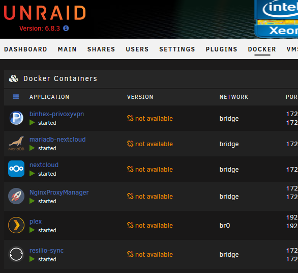

July 21, 20206 yr Community Expert Hi When I go into my DOCKER tab all my dockers are listed as VERSION "not available"; Does anyone else have this, or know how to fix it? The only work around I have found is to switch to advanced view and run "force update"... this then shows that the latest version is installed. But soon after, if I go back into DOCKERs it shows "not available" again. I have two HP servers and this persistent annoyance only happens on one! Any pointers? Thanks
July 27, 20206 yr Author Community Expert Update - I forced an update just after posting this, so they all said "up-to-date", then today when I checked again, they all say "not available" again 😞

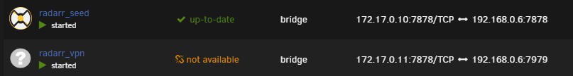

August 9, 20206 yr I am also getting something like this one is fine the other is "Not available" I have updated and rebooted the server what's next?

October 20, 20205 yr same problem here I just force the update of the first docker on the list and then hitted check for updates and now all the containesr are up-to-date again... Edited October 20, 20205 yr by yayitazale

February 13, 20215 yr I was running into the same issue. Docker Version "not available" In my case Fix Common Problems plugin was reporting "Unable to communicate with GitHub.com". This issue surfaced after setting unbound Pi-hole as the DNS on my home network. My workaround was as follows. 1. disable VM and docker in unraid settings 2. change the DNS in unraid IP settings to 1.1.1.1 (use whatever DNS you'd like) rather than my home router IP / Pi-hole 3. re-enable VMs and docker in unraid settings 4. toggle advanced view and force update containers in the docker tab of unraid After the following the above steps all contains show as up to date and are auto updating again.

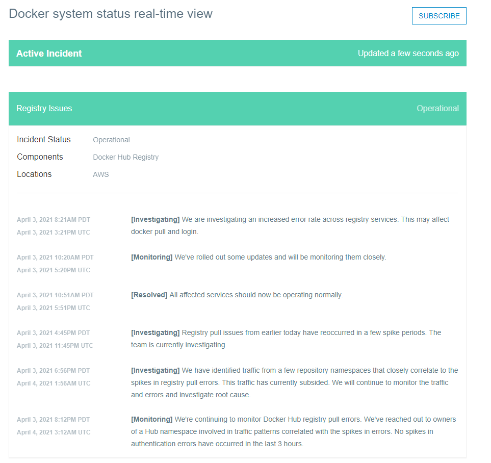

April 4, 20215 yr Community Expert This started happening to me as of today. My DNS however is set to cloudflares 'newer' 1.1.1.2 and 1.0.0.2 DNS servers. The ones with malware protection are 1.1.1.2. Maybe whatever unraid is using has got onto that list of nasties ?

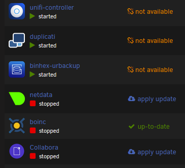

April 4, 20215 yr Same here for me, started yesterday. Yesterday i clicked on "check for updates" and mariadb and collabora came up with an update. Only collabora showed not available. After updating mariadb I thought, ok, your internet has stability issues anyways, check again tomorrow. And today it shows the following. Not all are unavailable and Collabora shows a update now. Weird! I've checked pihole if anything came up in the query log, but nothing is blocked. I updated all packages on pihole (on a pi4), updated unbounds local root config, restarted the pi and rechecked for updates. Now only netdata and collabora showed an update, no unavailable ones. Updating netdata wen't fine, recheck for updates and only collabora left with an update. Looks like it works again for me.
