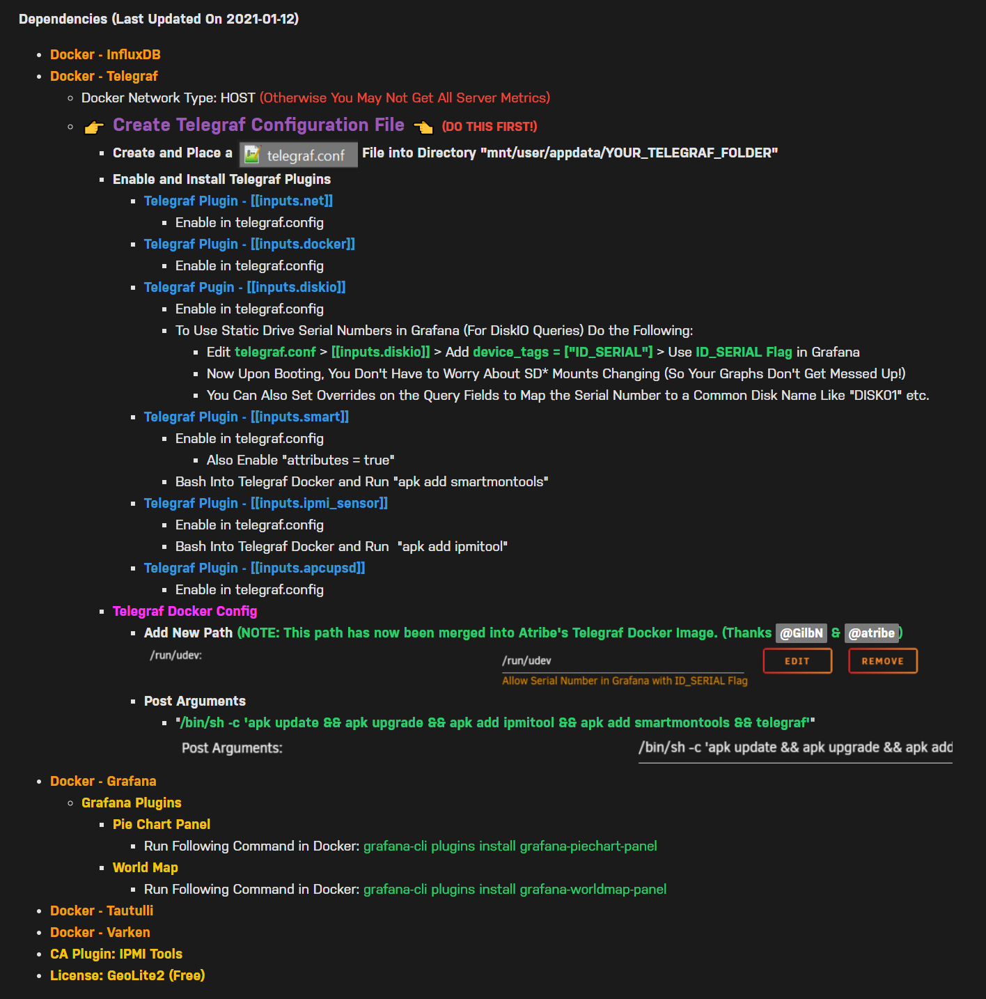

Thanks so much for making this.  I finally got it all set up and working the way I want it to.  Figured out how to compensate for the non-server hardware without the api.  A couple of issues I ran into along the way.

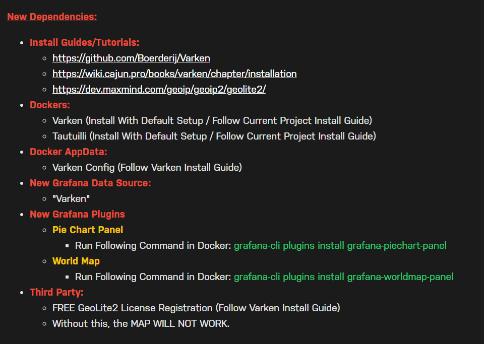

Using the telegraf:latest, there were no instructions on adding lm_sensors.  the apk add command doesnt work for it.  But adding apt-get -y install lm-sensors did seem to work.
Also, after setting up varken and the plex monitoring stuff, I noticed that two of the panel types were not included with grafana by default, so they showed an error.  It was the pie chart panel and the worldmap panel plugin.  They were easy to install just by going to the grafana console and typing.
grafana-cli plugins install grafana-piechart-panel
grafana-cli plugins install grafana-worldmap-panel
Once I did that they worked just fine.
Edited by mattekure
I also had this issue and did not had much time to look into it.
Just to clarify, the console is on the docker page, not in Grafana and you will have to restart the docker to see the new elements.
Thanks @mattekure ! :D

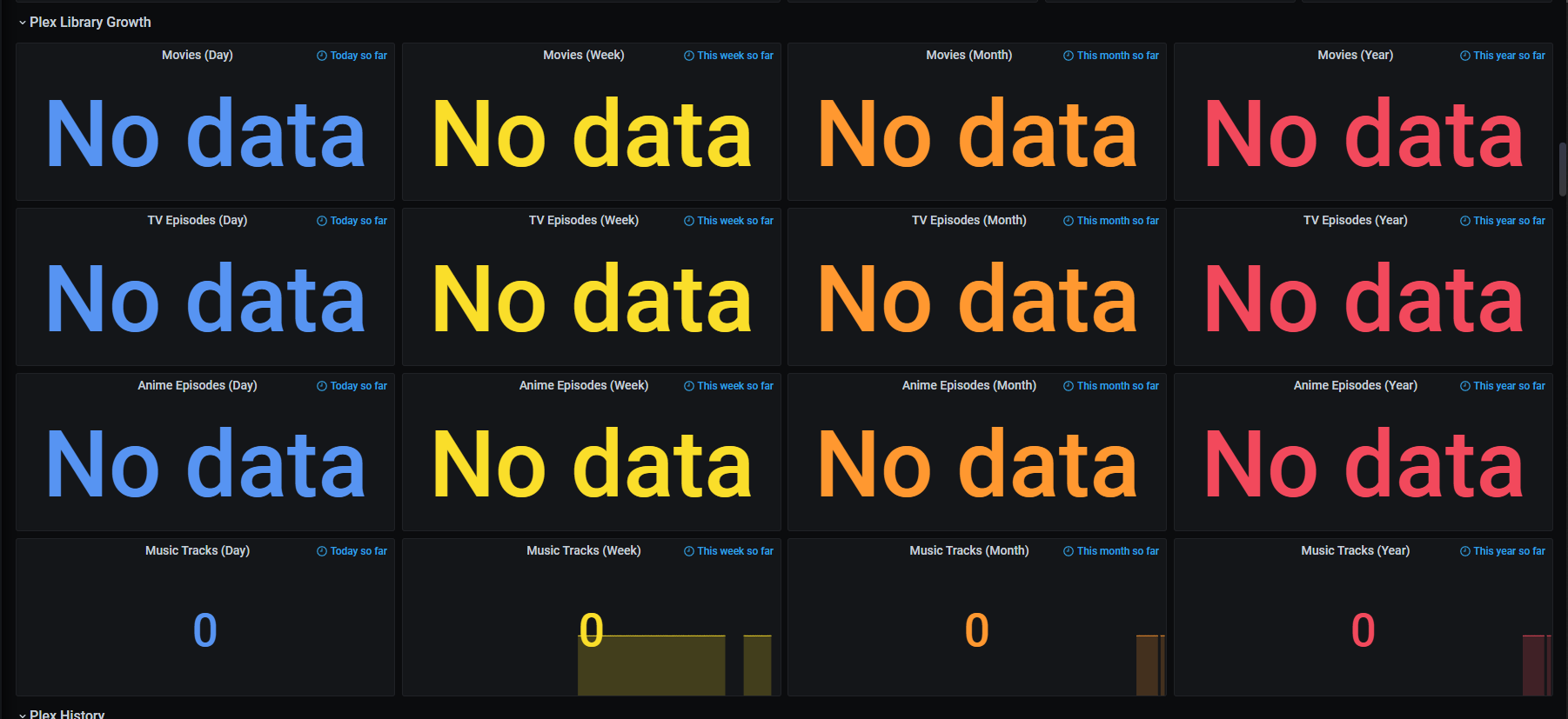

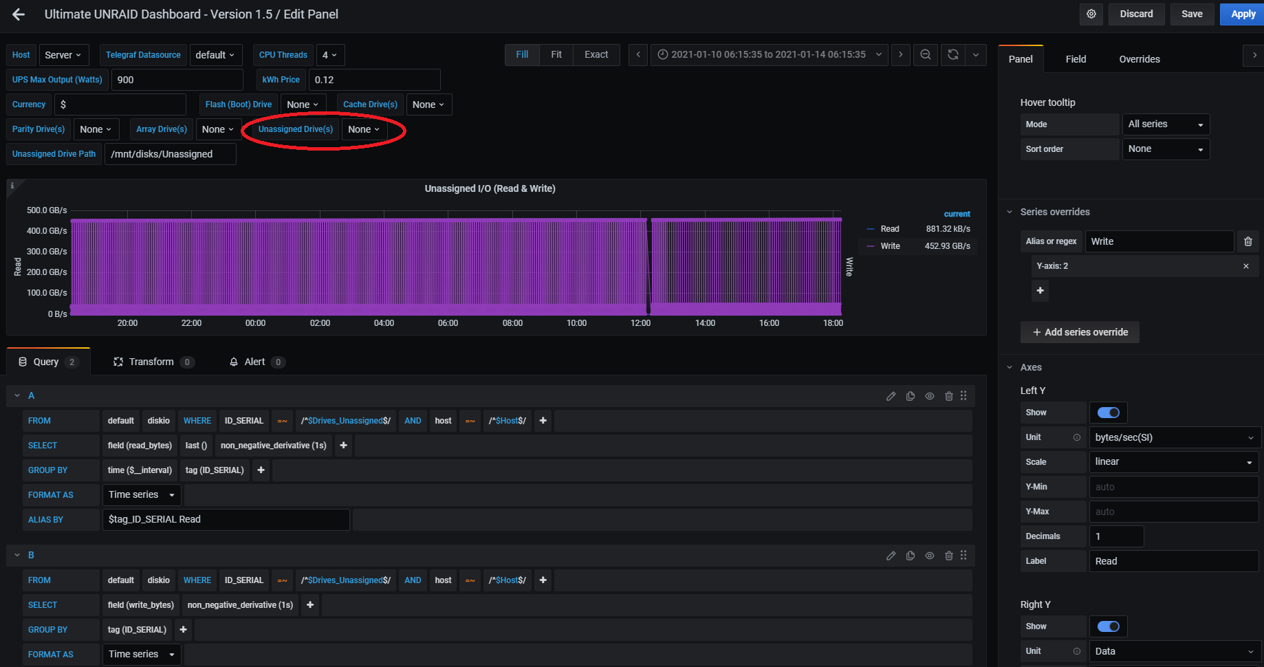

So i got UUD version 1.5 installed and all appears to be working but a few items so I have a few questions see below
first question my Plex Library Growth is not working any advice see image below

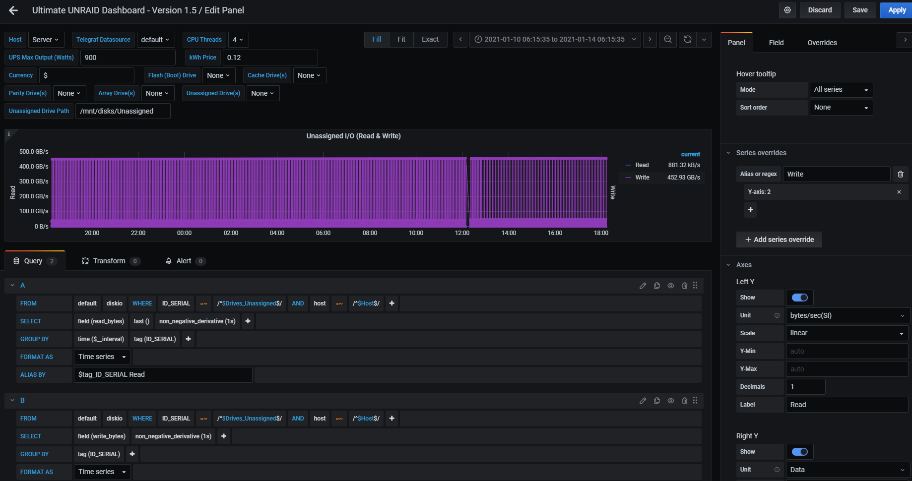

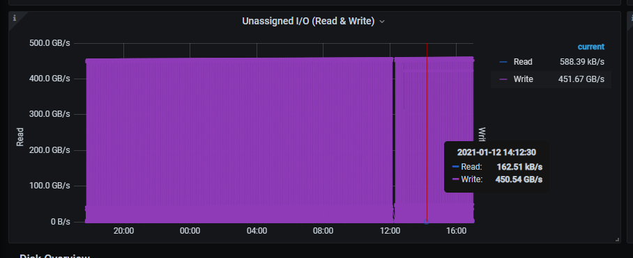

Second question what is the "unassigned i/o (read & write)" pulling its data from cause the writing on it is very high even though I only have 1 unassigned device and its a 16GB USB "only using 534mb out of the full 16GB" so I'm a wee bit confused since the write is shown as high as 500GB any help would be appreciated
I have not removed the unassigned USB disk because it is setup for backup purposes but only gets writing to once a week.
ask me any question if you require more info
Q1: Page 2:
You need to modify each of these Varken queries to account for your specific library name/path via the SECTION NAME tag. So for example, if you have "TVShows" instead of "TV Shows", you'll need to adjust that in each query as applicable:
Q2: Ensure your actual unassigned device is selected in the top drop down menu variable. Check the units on the field/override (right side of the screen). Also check the math division in the query to ensure it is correct. Clearly something is off with that... All of the UUD panels like this use bytes and use division to get GB or TB.
Edited by falconexe
38 minutes ago, falconexe said:

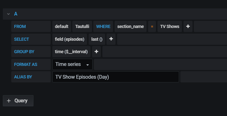

Q1: Page 2:
thanks I got the Plex Library Growth working.
but not full sure on the unassigned disks I have attached a screen shot on the right is that what you are referring to ? This is the first time I have set this up so not fully clued up
I updated the instructions in multiple areas to include these new Grafana plugin steps. These are in the Varken install guides, but it is also nice to have in-line...
Version 1.5 Release Notes:
Post Number 1 Dependencies:

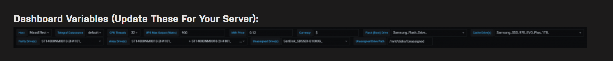

You need to set all of the variables in the top of the dash, including the Unassigned Drive(s) one which drives this panel via the "$Drives_Unassigned" Variable. If you don't set these, most of the dash is DOA.
Note: This information was previously provided in post number 1 under the Dependencies section.
