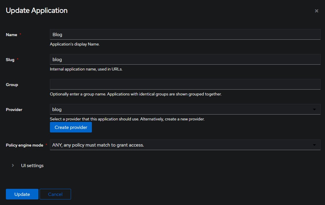

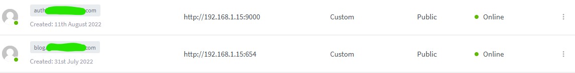

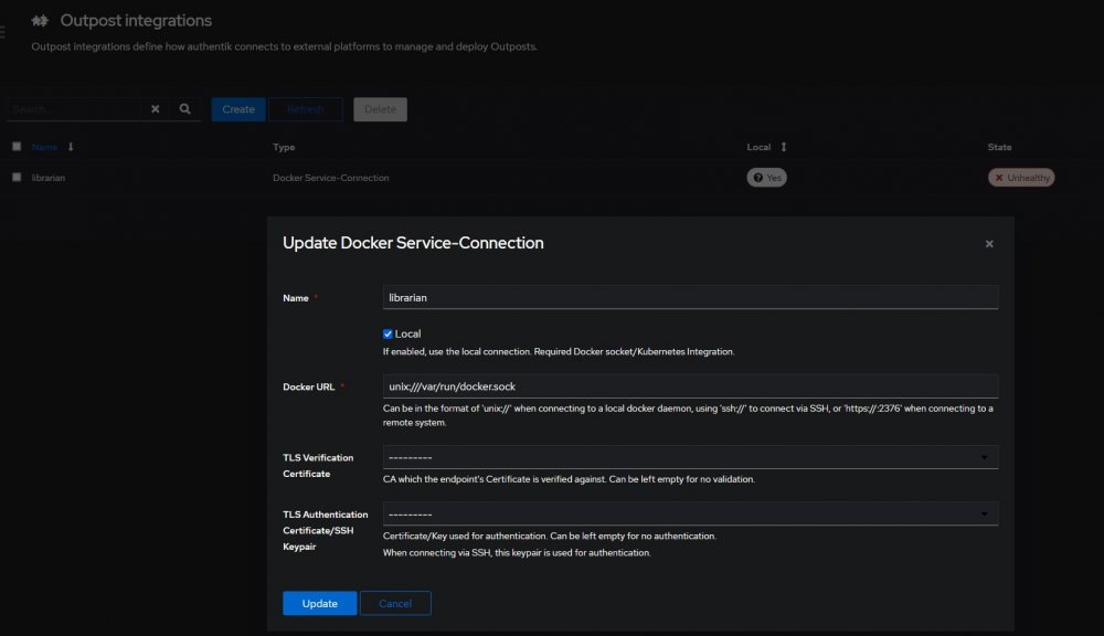

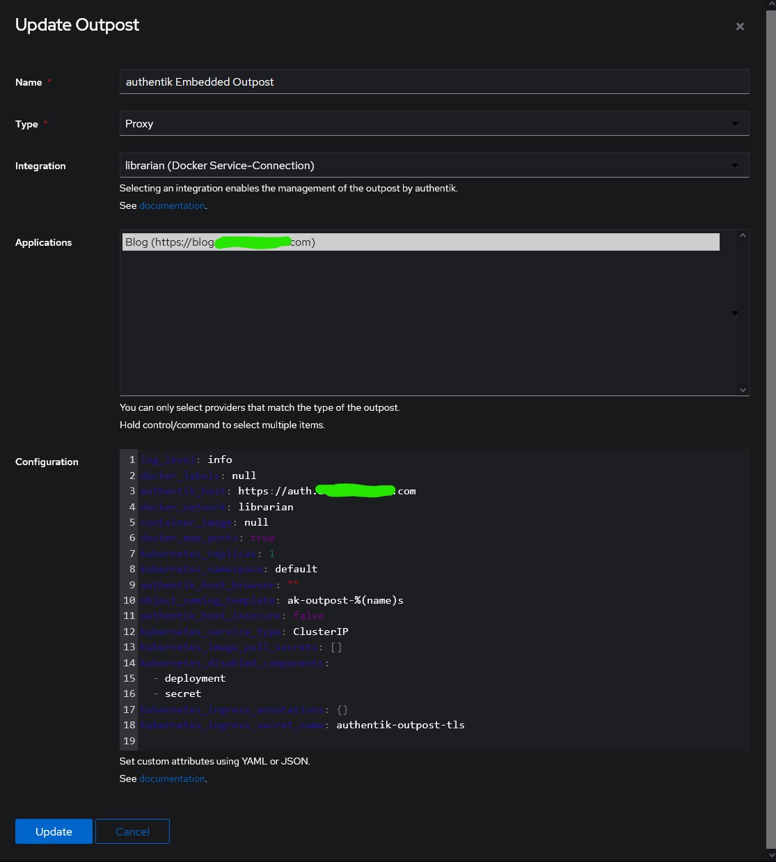

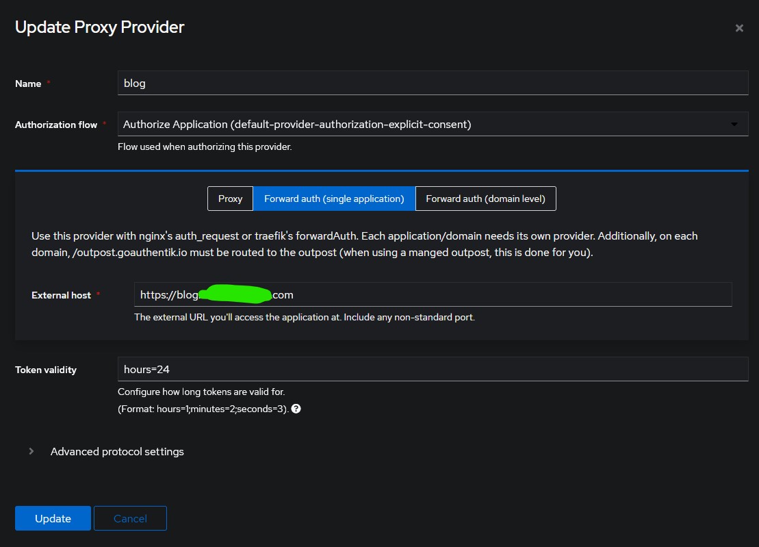

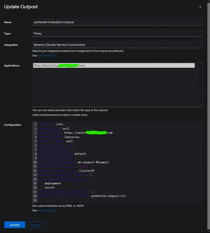

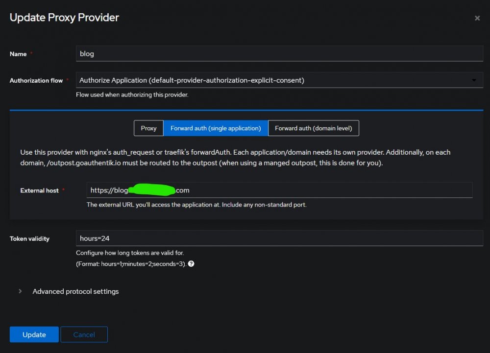

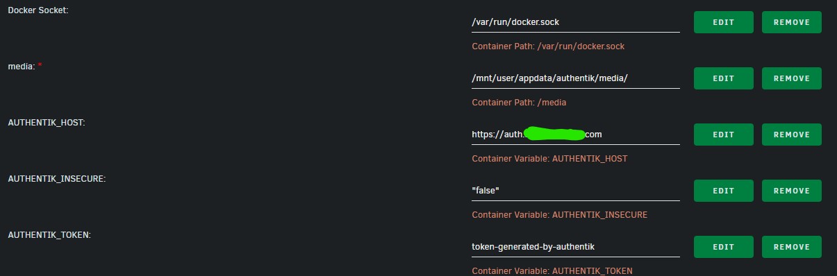

  17. I have been trying to setup Authentik following the video posted by Ibracorp: However I am getting the following issues using this config (nginx_advanced) where I replaced the proxy_pass on ~line 30 with my serverIP:9000 and replaced ~line 53 with my auth.domain.com... url. Once setup, my app.domain.com gets the advanced config, and ends up resolving to the wrong port. Meaning it ends up at app.domain.com:4443 which is my nginxproxymanger internal docker port. Nowhere is Authentik setup to re-direct to that port. Else, deviations from this setup, or replacing proxy_pass at ~line 9 creates server error 500. Unsure if related, Authentik shows my Outpost integration as unhealthy, even though I am pointing it to unix:///var/run/docker.sock as noted in the environment variable and documentation. Would this be causing my bad re-direct? Anyone willing to help me set this up? Also why was npm added to npm in the video? nginx_advanced.txt
