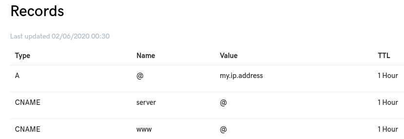

[Support] kru-x - Godaddy ddns
Hi Kru-x, Thanks for the reply. Not sure if this is the exact way you meant, but this works and solves my problem.
This docker is exactly what I'm looking for. I can get this working with my domain mydomain.com. But I can't get this working for subdomains like www.mydomain.com, server.mydomain.com etc. Only way I can get this working is by setting the "Domain Name" as mydomain.com when setting the docker up. I can't get it working for subdomains, by specifying "@", "*", "server" etc. How do you set this up?
