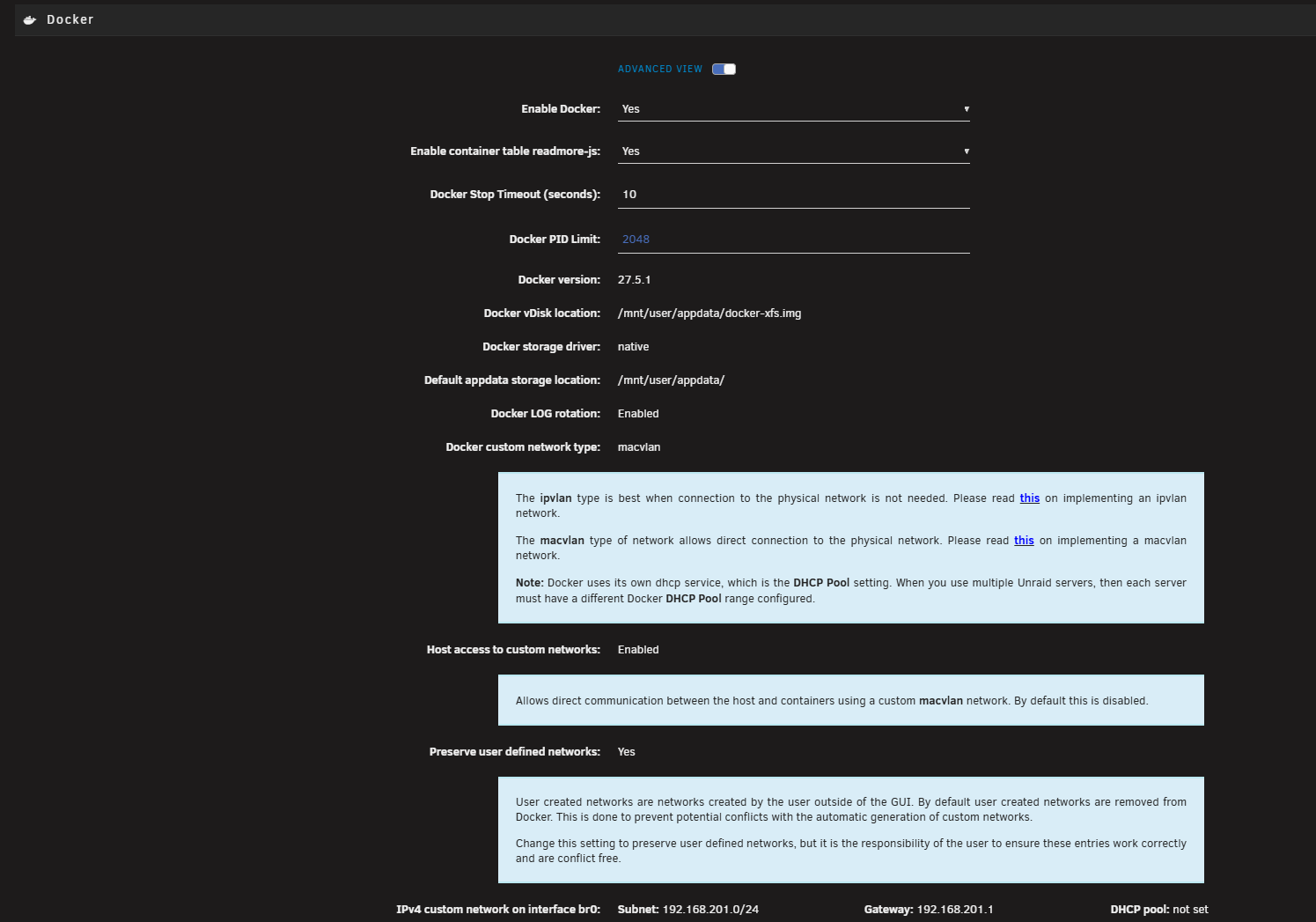

  3. Correct, please set custom to enabled and preserver user defined. Host to enabled will fix some docker isolation issues and on reboot your custom docker network on br0.100 for example would not remain causing other networking issues upon reboot. I want to make sure pfSense is correctly configured for vlans before editing and messing with unraid ... we should be able to run a temp docker, something like docker run -network=eth0.100 bash and consol in and double-check the docker on that vlan ... I'm not set on where what broke where. I do know that there were a mis configuration write with unraid moving form v6 into v7 that messed with docker vlan pool settings. but if your vlan is not correct then edits on unraid won't fix the underline issue. as we all need to make sure pfsense is routeing and able to tag the eth0 interface with multiple vlans... as its possible to have vlan 100 tagged and pluged into unraid and have valn 100 act as the default vlan... so only eth0 is on vlan 100 but doesn't see vlan 100 so packets sent off unraid are bing redirected(pfsense configurations). We want to make sure this isn't a network error first on pfsense. Then to infom unraid that a vlan exist and to tell linux to use eth0.100 we may need to remove the old bad docker data as well. as IDK what your settings curently are... Pleas post a diag! Example, if you turned off bridging br0 doesn't exist and the docker you made for vlan 100 is now eth0.100 not br0.100 so the docker network needs recreated... Not enuoth info to say one way or the other. but often when I jump in and help others on vlan stuff it has always been a network misconfiguration on how they have tagged there vlans in the router...

  6. and this tells me your messing with vlans and have hit the docekr netwrok isoaltion issue the vlan needs to have a dhcp server off pfsesne... meaning if I connect to vlan 100 as shown here. I get a dhcp IP form pfsense on that vlan. https://encrypted-vtbn1.gstatic.com/video?q=tbn:ANd9GcRN-XGWaNLzvwS_3harGp8nZhCPfDHmmx3oYCGD5nDNd3PcyHHR server user define network and host access enabled in docker settings. I still recomend using the bridgin for br0 (unraid default configurations) then we need to fix and doulbe check pfsesnt data for vlan and dhcp of a ip on that vlan... then docuble check the vlan on unraid and make a docker network on that vlan then asign that to the docker you wnat onthe vlan and get that mac to asign to pfsense... as given the OG post and data shown it looks like unrad was setup corectly... you will need pre check pfsense configurations for valns and the dhcp server over that vlan connection. Netgate ForumNo DHCP on VLAN interfacesI'm attempting to create a new VLAN configuration on pfSense 2.3.3, and can't get DHCP Server to configure. According to what I've been reading, after confi...

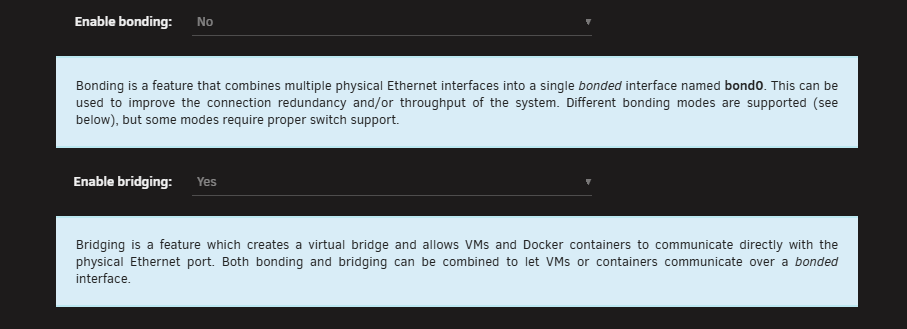

  7. given this data you turned off bridging which is fine/OK. it just means you will use custom eth0 this is your ipvlan/macvlan router lan docker network. so eth0 needs to connect to the pfsense device. unraind docker advance setting to move to macvlan to give dockers there own mac address is how i would direct you to move forward...
  8. we used to be able to define a docker run command to set a custom mac address. Docker updates and cahgns now moved this to the dokcer network side so no more define dcoker continer to this premade mac address... macvlan randomly generates this... that said... You can use docker compose and still pre define and set a mac address. example: docker compose to run unboud: networks: br0: external: true # macvlan on your LAN. Must already exist via: # docker network create -d macvlan \ # --subnet=192.168.2.0/24 --gateway=192.168.2.1 \ # -o parent=YOUR_NIC br0 # (replace YOUR_NIC with e.g. eno1, eth0, etc.) #uses unraids custom br0 default docker network services: unbound: image: mvance/unbound:latest # Additional system control if needed... # sysctls: # net.core.rmem_max: "16777216" # Memory budget for Unbound (cap + soft reservation) # mem_limit: 4g mem_reservation: 1g container_name: unbound restart: unless-stopped networks: br0: ipv4_address: 192.168.201.3 mac_address: "##:##:##:##:02:04" #I've written my own unboud and root hits location for this docker ... example only volumes: - /mnt/user/appdata/DNS/unbound/etc/unbound.conf:/opt/unbound/etc/unbound/unbound.conf - /mnt/user/appdata/DNS/unbound/key:/key # NOTE: Unbound is a full resolver and does not *need* upstream DNS here. # Keeping your original list below, but commented for later use if desired. Router Lan IP dns: - 192.168.201.1 labels: net.unraid.docker.icon: "/mnt/user/appdata/DNS/unbound.png" folder.view: "DNS" net.unraid.docker.managed: "composeman" extra_hosts: # Dockers - "unbound:192.168.201.3" healthcheck: test: ["CMD-SHELL", "/opt/unbound/sbin/unbound-host -C /opt/unbound/etc/unbound/unbound.conf -t A example.com >/dev/null 2>&1"] interval: 30s timeout: 5s retries: 5 start_period: 10s as example. AS I'm waiting for the push to convert and move unraid temaptel adn sytems over to Docker compose files... Unraid temapte esentail builds a docer run line that gets excuted to make teh dockers on unraid... we can use: https://www.composerize.com/ to convert them into compose file latter... sharing as proff of concept with docker mac address manipulation...
  9. using custom br0 giving the dockers there own lan ip static and opening pfsense and asigning the dockers mac to the ip. https://bmartino1.weebly.com/guide-dockernetworks.html under docker settings you would want to use macvlan to get a mac for each docker in the custom br0 network you can then grab the mac address form the docker via the network inspect command. docker network ls docker network inspect br0 eample my dns unboud docker is given this mac address in unifi I've infomred that this mac is this hostname and ip you then use that data to propgate pfsense and store mac address data... https://www.youtube.com/watch?v=jYZzAsPsyiQ https://docs.netgate.com/pfsense/en/latest/captiveportal/mac-address-control.html

  19. Depends on your network settings and how npn and your local network is configured. I can't say one way of the other as I don't know your network layout. in theory yes. in theory no. some settings need to be changed, fixed and checked. not eouth info to say which way one or the other... as example, my recomend unraid running network settings. especaly when using tailscale or a reversy proxy like npm, cady, trefek.... etc. Is your npm docker using ipvlan or macvlan? what docker network? did you give it a static ip? SO lets see what I run ... example how unriad makes the hyperv network is dictated in the vm settings: this should be br0 so new vms created will get a lan ip... default is vmbr which is a unraid dhcp server that give it internet but not always lan access.... Similar docker network settings can affect traffic. I personally prefer macvlan... this is because I want my dockers to be lan independent and have their own mac and not share a layer3 mac that can cause network routing issues. and general network setup are you using bridge mode? Bonding have multiple network nics? all of this can affect if a docker is able to traverse the network on the unraid host and on the lan via the router.
  20. udp requires broadcast and the use of ipvlan/macvlan... uptime kuma is built on node.js... its not common to need a udp check, or a check on the broadcast... https://github.com/louislam/uptime-kuma/issues/9 no udp as there is no need to check udp with node.js... what your describing more is something like portainer and setting up health checks, but portainer has to be running and you have to make the health checks to mark the containers as healthy... there are also a way to start dockers with docker exec... docker start <name of Docker> etc etc... And a FYI, watch dog docker does exist... Docker watchdog: https://github.com/buanet/docker.watchdog (*Similar to running watch tower for docker updates you run watch dog the docker and add -l a label in the dockers your watching... ) -But this needs to run/be running.... But I find uptime kuma quicker and easier to setup then watchdog direct... Similar to running portainer, this would run on top of the unraid docker socket system... if you looking for tcp, udp , and dns for checking there are other nice if up stem checks... not all are free.... like commercial enterprise grade software (Something we use at work) https://www.whatsupgold.com/network-mapping or a separate VM that runs something like netbox or foreman: https://theforeman.org/introduction.html https://netboxlabs.com/ *but this is more documentation not live checks... something could be leveraged and scripted... https://forums.unraid.net/topic/97228-support-linuxserverio-netbox/ *As you would want something with tcp dump and netcast... So Since your scripting, I would build my own script to run... https://www.digitalocean.com/community/tutorials/how-to-use-netcat-to-establish-and-test-tcp-and-udp-connections 3rd party unraid install... /boot/extra to have and write your own user script check... https://slackware.pkgs.org/15.0/slackdce-x86_64/netcat-0.7.1-x86_64-1_slackdce.txz.html Binary Package https://slackware.halpanet.org/slackdce/packages/15.0/x86_64/network/netcat/netcat-0.7.1-x86_64-1_slackdce.txz So, this really Depends on what your wanting it to do and how you want to interact with it.
  21. it has to do with docker custom br0 ipvlan/macvlan and docker isolaton. under docker settings if host access to custom networks is disabled unraid will not make a shim bridge to have teh docker on host, bridgemode or inteh custom br0 comunicate with each other. this is due to docker netwrok isolation.
