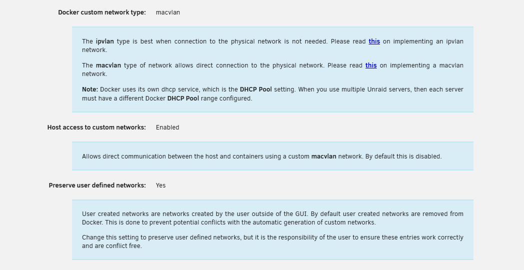

docker ps docker inspect diag done't realy show doker stuff it helps but doen't give use the full poicture... 2025-11-11 15:40:23 0 [ERROR] Can't start server : Bind on unix socket: Permission denied 2025-11-11 15:40:23 0 [ERROR] Do you already have another server running on socket: /run/mariadb/mariadb.sock ? this tells me that teh port is in use on the sytem already so docker network issues and how they are comunicating with each other... First ensure your docker advance settings: https://www.youtube.com/watch?v=bKFMS5C4CG0 https://bmartino1.weebly.com/guide-dockernetworks.html
