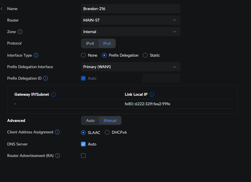

  22. using unfi equipment, I can turn off ipv6 RA (Router announcement) and use ipv6 dhcp via slacc. Unraid will not see nor use ipv6. If i turn on RA in my unifi device for example, then unraid will see ipv6 and enable ipv6 stuff as it should. I usually use unfi to test ipv6 on multiple OS. That's what I've found with unraid... If using Ipv6 SLAAC on unraid then the ipv6 slacc dhcp server need the RA option on... there is known configurations with Mikrotik router and ipv6 this is most likely a router misconfiguration. see forum: https://forum.mikrotik.com/t/intermittent-issues-with-ipv6-slaac-and-or-ra/176567 More on ipv6 and RA https://www.juniper.net/documentation/us/en/software/junos/security-services/topics/concept/port-security-ra-guard.html

  24. unraid needs ipv6 via ra to function and use ipv6 correctly per its inet rc script. slacc alone is not enoth for ipv6 on unraid... (more a linux and fored implementation and backwards compability due to andriods networking for ipv6... With a dhcp server for ipv6 using RA. then unraid wil corectly detect and use ipv6 corectly... Othwersie unraid will not coretly enabled ipv6 forwarding for dockers. I usualy use a user script at first array start to enabled ipv6 across dockers. Enable Unraid br0 IPV6 forwarding for Dockers #!/bin/bash # Delay before starting sleep 10 # Apply sysctl settings apply_sysctl_settings() { echo "Applying sysctl settings..." sysctl -w net.ipv6.conf.all.forwarding=1 sysctl -w net.ipv6.conf.br0.accept_ra=2 sysctl -w net.ipv6.conf.br0.accept_ra_rt_info_max_plen=64 #sysctl -w vm.overcommit_memory=1 echo "Verifying sysctl settings..." sysctl net.ipv6.conf.all.forwarding sysctl net.ipv6.conf.br0.accept_ra sysctl net.ipv6.conf.br0.accept_ra_rt_info_max_plen #sysctl vm.overcommit_memory } apply_sysctl_settings docker inspect is your friend here. docker network ls docker inspect br0 this will tell you if your docker network can use and is seeing ipv6. this was due to internal ipv4 do per communication to guarantee a host connection.
