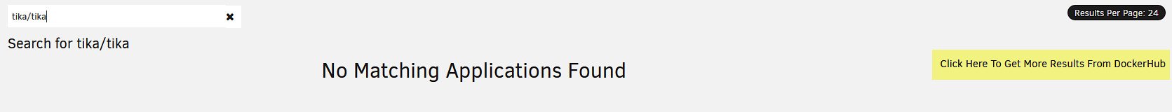

  22. As i couldnt find it in CA i took the results from DockerHub. First Unraid made a test installation. Had no problems and after it i could make the installation. I didnt use portainer.
  23. I installed these 2 containers: Repository: gotenberg/gotenberg Repository: apache/tika In Paperless i added these 3 varibles: Name / Key: PAPERLESS_TIKA_ENABLED Value: 1 Name / Key: PAPERLESS_TIKA_ENDPOINT Value: http://IP-of-tika-container:9998 Name / Key: PAPERLESS_TIKA_GOTENBERG_ENDPOINT Value: http://IP-of-gotenberg-container:3000/forms/libreoffice/convert# http:// before IP seems to be important. Only IP didnt work for me. Hope this helpes
