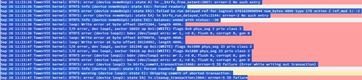

BTRFS errors in system log / VMs + Docker not working anymore + cant write to drive anymore
could somehow solve it with these commands (from another thread): mkdir /x mount -t btrfs -o skip_balance /dev/nvme0n1p1 /x btrfs balance cancel /x umount /x afterwards i could scrub and everything is working again now, will do a memtest and disable RAM OC...
hi JorgeB! thanks for help. tried to scrub already, but it doesn't do anything... so i should disable OC of the RAM and try to scrub again? it worked for years without troubles till now.. new diagnostics (but still with OC): towervie-diagnostics-20230928-1133.zip
Update: reading of the cache drive is still possible, started a backup now...
Is my BTRFS dead? What can i do now? Never had an issue with my cache till now...
Update: just wanted to copy a file to a cache share and got this error message: rsync: [receiver] mkstemp "/mnt/user/domains/.vcredist_x86.exe.xoMTrn" failed: Read-only file system (30) rsync error: some files/attrs were not transferred (see previous errors) (code 23) at main.c(1336) [sender=3.2.7]
getting worse: Sep 28 11:23:47 TowerVIE kernel: BTRFS info (device loop2: state E): forced readonly Sep 28 11:23:47 TowerVIE kernel: BTRFS warning (device loop2: state E): Skipping commit of aborted transaction. Sep 28 11:23:47 TowerVIE kernel: BTRFS: error (device loop2: state EA) in cleanup_transaction:1964: errno=-5 IO failure Sep 28 11:25:18 TowerVIE webGUI: Successful login user root from 192.168.1.243 Sep 28 11:25:28 TowerVIE root: error: /webGui/include/Notify.php: wrong csrf_token Sep 28 11:26:09 TowerVIE kernel: BTRFS error (device nvme0n1p1: state EA): parent transid verify failed on logical 5352654831616 mirror 2 wanted 2278877 found 2277781 Sep 28 11:26:09 TowerVIE kernel: BTRFS error (device nvme0n1p1: state EA): parent transid verify failed on logical 5352654831616 mirror 1 wanted 2278877 found 2277781 Sep 28 11:26:09 TowerVIE kernel: BTRFS error (device nvme0n1p1: state EA): parent transid verify failed on logical 5352654831616 mirror 2 wanted 2278877 found 2277781 Sep 28 11:26:09 TowerVIE kernel: BTRFS error (device nvme0n1p1: state EA): parent transid verify failed on logical 5352654831616 mirror 1 wanted 2278877 found 2277781 Sep 28 11:26:10 TowerVIE kernel: BTRFS error (device nvme0n1p1: state EA): parent transid verify failed on logical 5352660680704 mirror 2 wanted 2278877 found 2277781 Sep 28 11:26:10 TowerVIE kernel: BTRFS error (device nvme0n1p1: state EA): parent transid verify failed on logical 5352660680704 mirror 1 wanted 2278877 found 2277781 Sep 28 11:26:10 TowerVIE kernel: BTRFS error (device nvme0n1p1: state EA): parent transid verify failed on logical 5352660680704 mirror 2 wanted 2278877 found 2277781 Sep 28 11:26:10 TowerVIE kernel: BTRFS error (device nvme0n1p1: state EA): parent transid verify failed on logical 5352660680704 mirror 1 wanted 2278877 found 2277781 Sep 28 11:26:10 TowerVIE kernel: BTRFS error (device nvme0n1p1: state EA): parent transid verify failed on logical 5352654831616 mirror 1 wanted 2278877 found 2277781 Sep 28 11:26:10 TowerVIE kernel: BTRFS error (device nvme0n1p1: state EA): parent transid verify failed on logical 5352654831616 mirror 2 wanted 2278877 found 2277781 Sep 28 11:26:15 TowerVIE kernel: verify_parent_transid: 26 callbacks suppressed Sep 28 11:26:15 TowerVIE kernel: BTRFS error (device nvme0n1p1: state EA): parent transid verify failed on logical 5352660680704 mirror 1 wanted 2278877 found 2277781 Sep 28 11:26:15 TowerVIE kernel: BTRFS error (device nvme0n1p1: state EA): parent transid verify failed on logical 5352660680704 mirror 2 wanted 2278877 found 2277781 Sep 28 11:26:15 TowerVIE kernel: BTRFS error (device nvme0n1p1: state EA): parent transid verify failed on logical 5352660680704 mirror 1 wanted 2278877 found 2277781 Sep 28 11:26:15 TowerVIE kernel: BTRFS error (device nvme0n1p1: state EA): parent transid verify failed on logical 5352660680704 mirror 2 wanted 2278877 found 2277781 Sep 28 11:26:16 TowerVIE kernel: BTRFS error (device nvme0n1p1: state EA): parent transid verify failed on logical 5352660680704 mirror 1 wanted 2278877 found 2277781 Sep 28 11:26:16 TowerVIE kernel: BTRFS error (device nvme0n1p1: state EA): parent transid verify failed on logical 5352660680704 mirror 2 wanted 2278877 found 2277781 Sep 28 11:26:16 TowerVIE kernel: BTRFS error (device nvme0n1p1: state EA): parent transid verify failed on logical 5352660680704 mirror 1 wanted 2278877 found 2277781 Sep 28 11:26:16 TowerVIE kernel: BTRFS error (device nvme0n1p1: state EA): parent transid verify failed on logical 5352660680704 mirror 2 wanted 2278877 found 2277781 Sep 28 11:26:17 TowerVIE kernel: BTRFS error (device nvme0n1p1: state EA): parent transid verify failed on logical 5352660680704 mirror 1 wanted 2278877 found 2277781 Sep 28 11:26:17 TowerVIE kernel: BTRFS error (device nvme0n1p1: state EA): parent transid verify failed on logical 5352660680704 mirror 2 wanted 2278877 found 2277781 Sep 28 11:26:52 TowerVIE ool www[29307]: /usr/local/emhttp/plugins/dynamix/scripts/btrfs_scrub 'start' '/mnt/cache' '' Sep 28 11:27:54 TowerVIE kernel: verify_parent_transid: 2 callbacks suppressed Sep 28 11:27:54 TowerVIE kernel: BTRFS error (device nvme0n1p1: state EA): parent transid verify failed on logical 5352654831616 mirror 1 wanted 2278877 found 2277781 Sep 28 11:27:54 TowerVIE kernel: BTRFS error (device nvme0n1p1: state EA): parent transid verify failed on logical 5352654831616 mirror 2 wanted 2278877 found 2277781 Sep 28 11:27:54 TowerVIE kernel: BTRFS error (device nvme0n1p1: state EA): parent transid verify failed on logical 5352654831616 mirror 1 wanted 2278877 found 2277781 Sep 28 11:27:54 TowerVIE kernel: BTRFS error (device nvme0n1p1: state EA): parent transid verify failed on logical 5352654831616 mirror 2 wanted 2278877 found 2277781 Sep 28 11:27:55 TowerVIE kernel: BTRFS error (device nvme0n1p1: state EA): parent transid verify failed on logical 5352654831616 mirror 2 wanted 2278877 found 2277781 Sep 28 11:27:55 TowerVIE kernel: BTRFS error (device nvme0n1p1: state EA): parent transid verify failed on logical 5352654831616 mirror 1 wanted 2278877 found 2277781 Sep 28 11:27:56 TowerVIE kernel: BTRFS error (device nvme0n1p1: state EA): parent transid verify failed on logical 5352654831616 mirror 2 wanted 2278877 found 2277781 Sep 28 11:27:56 TowerVIE kernel: BTRFS error (device nvme0n1p1: state EA): parent transid verify failed on logical 5352654831616 mirror 1 wanted 2278877 found 2277781 Sep 28 11:27:57 TowerVIE kernel: BTRFS error (device nvme0n1p1: state EA): parent transid verify failed on logical 5352654831616 mirror 1 wanted 2278877 found 2277781 Sep 28 11:27:57 TowerVIE kernel: BTRFS error (device nvme0n1p1: state EA): parent transid verify failed on logical 5352654831616 mirror 2 wanted 2278877 found 2277781 Sep 28 11:27:59 TowerVIE kernel: verify_parent_transid: 4 callbacks suppressed Sep 28 11:27:59 TowerVIE kernel: BTRFS error (device nvme0n1p1: state EA): parent transid verify failed on logical 5352654831616 mirror 2 wanted 2278877 found 2277781 Sep 28 11:27:59 TowerVIE kernel: BTRFS error (device nvme0n1p1: state EA): parent transid verify failed on logical 5352654831616 mirror 1 wanted 2278877 found 2277781 Sep 28 11:28:00 TowerVIE kernel: BTRFS error (device nvme0n1p1: state EA): parent transid verify failed on logical 5352654831616 mirror 1 wanted 2278877 found 2277781 Sep 28 11:28:00 TowerVIE kernel: BTRFS error (device nvme0n1p1: state EA): parent transid verify failed on logical 5352654831616 mirror 2 wanted 2278877 found 2277781 Sep 28 11:28:01 TowerVIE kernel: BTRFS error (device nvme0n1p1: state EA): parent transid verify failed on logical 5352654831616 mirror 1 wanted 2278877 found 2277781 Sep 28 11:28:01 TowerVIE kernel: BTRFS error (device nvme0n1p1: state EA): parent transid verify failed on logical 5352654831616 mirror 2 wanted 2278877 found 2277781 Sep 28 11:28:01 TowerVIE kernel: BTRFS error (device nvme0n1p1: state EA): parent transid verify failed on logical 5352654831616 mirror 1 wanted 2278877 found 2277781 Sep 28 11:28:01 TowerVIE kernel: BTRFS error (device nvme0n1p1: state EA): parent transid verify failed on logical 5352654831616 mirror 2 wanted 2278877 found 2277781 Sep 28 11:28:02 TowerVIE kernel: BTRFS error (device nvme0n1p1: state EA): parent transid verify failed on logical 5352654831616 mirror 2 wanted 2278877 found 2277781 Sep 28 11:28:02 TowerVIE kernel: BTRFS error (device nvme0n1p1: state EA): parent transid verify failed on logical 5352654831616 mirror 1 wanted 2278877 found 2277781 Sep 28 11:28:04 TowerVIE kernel: verify_parent_transid: 8 callbacks suppressed Sep 28 11:28:04 TowerVIE kernel: BTRFS error (device nvme0n1p1: state EA): parent transid verify failed on logical 5352704131072 mirror 2 wanted 2278877 found 2277787 Sep 28 11:28:04 TowerVIE kernel: BTRFS error (device nvme0n1p1: state EA): parent transid verify failed on logical 5352704131072 mirror 1 wanted 2278877 found 2277787 Sep 28 11:28:05 TowerVIE kernel: BTRFS error (device nvme0n1p1: state EA): parent transid verify failed on logical 5352704131072 mirror 1 wanted 2278877 found 2277787 Sep 28 11:28:05 TowerVIE kernel: BTRFS error (device nvme0n1p1: state EA): parent transid verify failed on logical 5352704131072 mirror 2 wanted 2278877 found 2277787 Sep 28 11:28:06 TowerVIE kernel: BTRFS error (device nvme0n1p1: state EA): parent transid verify failed on logical 5352704131072 mirror 1 wanted 2278877 found 2277787 Sep 28 11:28:06 TowerVIE kernel: BTRFS error (device nvme0n1p1: state EA): parent transid verify failed on logical 5352704131072 mirror 2 wanted 2278877 found 2277787 Sep 28 11:28:06 TowerVIE kernel: BTRFS error (device nvme0n1p1: state EA): parent transid verify failed on logical 5352704131072 mirror 2 wanted 2278877 found 2277787 Sep 28 11:28:06 TowerVIE kernel: BTRFS error (device nvme0n1p1: state EA): parent transid verify failed on logical 5352704131072 mirror 1 wanted 2278877 found 2277787 Sep 28 11:28:07 TowerVIE kernel: BTRFS error (device nvme0n1p1: state EA): parent transid verify failed on logical 5352704131072 mirror 2 wanted 2278877 found 2277787 Sep 28 11:28:07 TowerVIE kernel: BTRFS error (device nvme0n1p1: state EA): parent transid verify failed on logical 5352704131072 mirror 1 wanted 2278877 found 2277787 Sep 28 11:28:09 TowerVIE kernel: verify_parent_transid: 32 callbacks suppressed Sep 28 11:28:09 TowerVIE kernel: BTRFS error (device nvme0n1p1: state EA): parent transid verify failed on logical 5352704131072 mirror 2 wanted 2278877 found 2277787 Sep 28 11:28:09 TowerVIE kernel: BTRFS error (device nvme0n1p1: state EA): parent transid verify failed on logical 5352704131072 mirror 1 wanted 2278877 found 2277787 Sep 28 11:28:09 TowerVIE kernel: BTRFS error (device nvme0n1p1: state EA): parent transid verify failed on logical 5352704131072 mirror 2 wanted 2278877 found 2277787 Sep 28 11:28:09 TowerVIE kernel: BTRFS error (device nvme0n1p1: state EA): parent transid verify failed on logical 5352704131072 mirror 1 wanted 2278877 found 2277787 Sep 28 11:28:09 TowerVIE kernel: BTRFS error (device nvme0n1p1: state EA): parent transid verify failed on logical 5361336336384 mirror 2 wanted 2278877 found 2277805 Sep 28 11:28:09 TowerVIE kernel: BTRFS error (device nvme0n1p1: state EA): parent transid verify failed on logical 5361336336384 mirror 1 wanted 2278877 found 2277805 Sep 28 11:28:09 TowerVIE kernel: BTRFS error (device nvme0n1p1: state EA): parent transid verify failed on logical 5352653176832 mirror 1 wanted 2278877 found 2277781 Sep 28 11:28:09 TowerVIE kernel: BTRFS error (device nvme0n1p1: state EA): parent transid verify failed on logical 5352653176832 mirror 2 wanted 2278877 found 2277781 Sep 28 11:28:09 TowerVIE kernel: BTRFS error (device nvme0n1p1: state EA): parent transid verify failed on logical 5352704131072 mirror 1 wanted 2278877 found 2277787 Sep 28 11:28:09 TowerVIE kernel: BTRFS error (device nvme0n1p1: state EA): parent transid verify failed on logical 5352704131072 mirror 2 wanted 2278877 found 2277787 Sep 28 11:28:14 TowerVIE kernel: verify_parent_transid: 104 callbacks suppressed Sep 28 11:28:14 TowerVIE kernel: BTRFS error (device nvme0n1p1: state EA): parent transid verify failed on logical 5352653176832 mirror 1 wanted 2278877 found 2277781 Sep 28 11:28:14 TowerVIE kernel: BTRFS error (device nvme0n1p1: state EA): parent transid verify failed on logical 5352653176832 mirror 2 wanted 2278877 found 2277781 Sep 28 11:28:14 TowerVIE kernel: BTRFS error (device nvme0n1p1: state EA): parent transid verify failed on logical 5361336336384 mirror 2 wanted 2278877 found 2277805 Sep 28 11:28:14 TowerVIE kernel: BTRFS error (device nvme0n1p1: state EA): parent transid verify failed on logical 5361336336384 mirror 1 wanted 2278877 found 2277805 Sep 28 11:28:14 TowerVIE kernel: BTRFS error (device nvme0n1p1: state EA): parent transid verify failed on logical 5361336336384 mirror 2 wanted 2278877 found 2277805 Sep 28 11:28:14 TowerVIE kernel: BTRFS error (device nvme0n1p1: state EA): parent transid verify failed on logical 5361336336384 mirror 1 wanted 2278877 found 2277805 Sep 28 11:28:14 TowerVIE kernel: BTRFS error (device nvme0n1p1: state EA): parent transid verify failed on logical 5361336336384 mirror 2 wanted 2278877 found 2277805 Sep 28 11:28:14 TowerVIE kernel: BTRFS error (device nvme0n1p1: state EA): parent transid verify failed on logical 5361336336384 mirror 1 wanted 2278877 found 2277805 Sep 28 11:28:14 TowerVIE kernel: BTRFS error (device nvme0n1p1: state EA): parent transid verify failed on logical 5361336336384 mirror 2 wanted 2278877 found 2277805 Sep 28 11:28:14 TowerVIE kernel: BTRFS error (device nvme0n1p1: state EA): parent transid verify failed on logical 5361336336384 mirror 1 wanted 2278877 found 2277805 Sep 28 11:28:19 TowerVIE kernel: verify_parent_transid: 76 callbacks suppressed Sep 28 11:28:19 TowerVIE kernel: BTRFS error (device nvme0n1p1: state EA): parent transid verify failed on logical 5352668151808 mirror 2 wanted 2278877 found 2277781 Sep 28 11:28:19 TowerVIE kernel: BTRFS error (device nvme0n1p1: state EA): parent transid verify failed on logical 5352668151808 mirror 1 wanted 2278877 found 2277781 Sep 28 11:28:19 TowerVIE kernel: BTRFS error (device nvme0n1p1: state EA): parent transid verify failed on logical 5352653111296 mirror 2 wanted 2278877 found 2277781 Sep 28 11:28:19 TowerVIE kernel: BTRFS error (device nvme0n1p1: state EA): parent transid verify failed on logical 5352653111296 mirror 1 wanted 2278877 found 2277781 Sep 28 11:28:19 TowerVIE kernel: BTRFS error (device nvme0n1p1: state EA): parent transid verify failed on logical 5352653176832 mirror 2 wanted 2278877 found 2277781 Sep 28 11:28:19 TowerVIE kernel: BTRFS error (device nvme0n1p1: state EA): parent transid verify failed on logical 5352653176832 mirror 1 wanted 2278877 found 2277781 Sep 28 11:28:19 TowerVIE kernel: BTRFS error (device nvme0n1p1: state EA): parent transid verify failed on logical 5352653176832 mirror 1 wanted 2278877 found 2277781 Sep 28 11:28:19 TowerVIE kernel: BTRFS error (device nvme0n1p1: state EA): parent transid verify failed on logical 5352653176832 mirror 2 wanted 2278877 found 2277781 Sep 28 11:28:19 TowerVIE kernel: BTRFS error (device nvme0n1p1: state EA): parent transid verify failed on logical 5352653176832 mirror 2 wanted 2278877 found 2277781 Sep 28 11:28:19 TowerVIE kernel: BTRFS error (device nvme0n1p1: state EA): parent transid verify failed on logical 5352653176832 mirror 1 wanted 2278877 found 2277781 Sep 28 11:28:24 TowerVIE kernel: verify_parent_transid: 22 callbacks suppressed Sep 28 11:28:24 TowerVIE kernel: BTRFS error (device nvme0n1p1: state EA): parent transid verify failed on logical 5352653111296 mirror 1 wanted 2278877 found 2277781 Sep 28 11:28:24 TowerVIE kernel: BTRFS error (device nvme0n1p1: state EA): parent transid verify failed on logical 5352653111296 mirror 2 wanted 2278877 found 2277781 Sep 28 11:28:24 TowerVIE kernel: BTRFS error (device nvme0n1p1: state EA): parent transid verify failed on logical 5352653111296 mirror 2 wanted 2278877 found 2277781 Sep 28 11:28:24 TowerVIE kernel: BTRFS error (device nvme0n1p1: state EA): parent transid verify failed on logical 5352653111296 mirror 1 wanted 2278877 found 2277781 Sep 28 11:28:24 TowerVIE kernel: BTRFS error (device nvme0n1p1: state EA): parent transid verify failed on logical 5352653176832 mirror 2 wanted 2278877 found 2277781 Sep 28 11:28:24 TowerVIE kernel: BTRFS error (device nvme0n1p1: state EA): parent transid verify failed on logical 5352653176832 mirror 1 wanted 2278877 found 2277781 Sep 28 11:28:25 TowerVIE kernel: BTRFS error (device nvme0n1p1: state EA): parent transid verify failed on logical 5361336336384 mirror 1 wanted 2278877 found 2277805 Sep 28 11:28:25 TowerVIE kernel: BTRFS error (device nvme0n1p1: state EA): parent transid verify failed on logical 5361336336384 mirror 2 wanted 2278877 found 2277805 Sep 28 11:28:25 TowerVIE kernel: BTRFS error (device nvme0n1p1: state EA): parent transid verify failed on logical 5352653111296 mirror 1 wanted 2278877 found 2277781 Sep 28 11:28:25 TowerVIE kernel: BTRFS error (device nvme0n1p1: state EA): parent transid verify failed on logical 5352653111296 mirror 2 wanted 2278877 found 2277781 Sep 28 11:28:29 TowerVIE kernel: verify_parent_transid: 28 callbacks suppressed Sep 28 11:28:29 TowerVIE kernel: BTRFS error (device nvme0n1p1: state EA): parent transid verify failed on logical 5352653111296 mirror 2 wanted 2278877 found 2277781 Sep 28 11:28:29 TowerVIE kernel: BTRFS error (device nvme0n1p1: state EA): parent transid verify failed on logical 5352653111296 mirror 1 wanted 2278877 found 2277781 Sep 28 11:28:29 TowerVIE kernel: BTRFS error (device nvme0n1p1: state EA): parent transid verify failed on logical 5352653176832 mirror 1 wanted 2278877 found 2277781 Sep 28 11:28:29 TowerVIE kernel: BTRFS error (device nvme0n1p1: state EA): parent transid verify failed on logical 5352653176832 mirror 2 wanted 2278877 found 2277781 Sep 28 11:28:30 TowerVIE kernel: BTRFS error (device nvme0n1p1: state EA): parent transid verify failed on logical 5361336336384 mirror 1 wanted 2278877 found 2277805 Sep 28 11:28:30 TowerVIE kernel: BTRFS error (device nvme0n1p1: state EA): parent transid verify failed on logical 5361336336384 mirror 2 wanted 2278877 found 2277805 Sep 28 11:28:30 TowerVIE kernel: BTRFS error (device nvme0n1p1: state EA): parent transid verify failed on logical 5352653111296 mirror 2 wanted 2278877 found 2277781 Sep 28 11:28:30 TowerVIE kernel: BTRFS error (device nvme0n1p1: state EA): parent transid verify failed on logical 5352653111296 mirror 1 wanted 2278877 found 2277781 Sep 28 11:28:30 TowerVIE kernel: BTRFS error (device nvme0n1p1: state EA): parent transid verify failed on logical 5352653176832 mirror 2 wanted 2278877 found 2277781 Sep 28 11:28:30 TowerVIE kernel: BTRFS error (device nvme0n1p1: state EA): parent transid verify failed on logical 5352653176832 mirror 1 wanted 2278877 found 2277781 Sep 28 11:28:34 TowerVIE kernel: verify_parent_transid: 16 callbacks suppressed Sep 28 11:28:34 TowerVIE kernel: BTRFS error (device nvme0n1p1: state EA): parent transid verify failed on logical 5352653111296 mirror 1 wanted 2278877 found 2277781 Sep 28 11:28:34 TowerVIE kernel: BTRFS error (device nvme0n1p1: state EA): parent transid verify failed on logical 5352653111296 mirror 2 wanted 2278877 found 2277781 Sep 28 11:28:35 TowerVIE kernel: BTRFS error (device nvme0n1p1: state EA): parent transid verify failed on logical 5352653111296 mirror 2 wanted 2278877 found 2277781 Sep 28 11:28:35 TowerVIE kernel: BTRFS error (device nvme0n1p1: state EA): parent transid verify failed on logical 5352653111296 mirror 1 wanted 2278877 found 2277781 Sep 28 11:28:36 TowerVIE kernel: BTRFS error (device nvme0n1p1: state EA): parent transid verify failed on logical 5352653176832 mirror 2 wanted 2278877 found 2277781 Sep 28 11:28:36 TowerVIE kernel: BTRFS error (device nvme0n1p1: state EA): parent transid verify failed on logical 5352653176832 mirror 1 wanted 2278877 found 2277781 Sep 28 11:28:37 TowerVIE kernel: BTRFS error (device nvme0n1p1: state EA): parent transid verify failed on logical 5352653111296 mirror 1 wanted 2278877 found 2277781 Sep 28 11:28:37 TowerVIE kernel: BTRFS error (device nvme0n1p1: state EA): parent transid verify failed on logical 5352653111296 mirror 2 wanted 2278877 found 2277781 Sep 28 11:28:37 TowerVIE kernel: BTRFS error (device nvme0n1p1: state EA): parent transid verify failed on logical 5352653111296 mirror 1 wanted 2278877 found 2277781 Sep 28 11:28:37 TowerVIE kernel: BTRFS error (device nvme0n1p1: state EA): parent transid verify failed on logical 5352653111296 mirror 2 wanted 2278877 found 2277781 Sep 28 11:28:40 TowerVIE kernel: verify_parent_transid: 8 callbacks suppressed Sep 28 11:28:40 TowerVIE kernel: BTRFS error (device nvme0n1p1: state EA): parent transid verify failed on logical 5352653176832 mirror 1 wanted 2278877 found 2277781 Sep 28 11:28:40 TowerVIE kernel: BTRFS error (device nvme0n1p1: state EA): parent transid verify failed on logical 5352653176832 mirror 2 wanted 2278877 found 2277781 Sep 28 11:28:40 TowerVIE kernel: BTRFS error (device nvme0n1p1: state EA): parent transid verify failed on logical 5352653111296 mirror 1 wanted 2278877 found 2277781 Sep 28 11:28:40 TowerVIE kernel: BTRFS error (device nvme0n1p1: state EA): parent transid verify failed on logical 5352653111296 mirror 2 wanted 2278877 found 2277781 Sep 28 11:28:41 TowerVIE kernel: BTRFS error (device nvme0n1p1: state EA): parent transid verify failed on logical 5352653176832 mirror 2 wanted 2278877 found 2277781 Sep 28 11:28:41 TowerVIE kernel: BTRFS error (device nvme0n1p1: state EA): parent transid verify failed on logical 5352653176832 mirror 1 wanted 2278877 found 2277781 Sep 28 11:28:41 TowerVIE kernel: BTRFS error (device nvme0n1p1: state EA): parent transid verify failed on logical 5352653111296 mirror 2 wanted 2278877 found 2277781 Sep 28 11:28:41 TowerVIE kernel: BTRFS error (device nvme0n1p1: state EA): parent transid verify failed on logical 5352653111296 mirror 1 wanted 2278877 found 2277781 Sep 28 11:28:41 TowerVIE kernel: BTRFS error (device nvme0n1p1: state EA): parent transid verify failed on logical 5352653111296 mirror 2 wanted 2278877 found 2277781 Sep 28 11:28:41 TowerVIE kernel: BTRFS error (device nvme0n1p1: state EA): parent transid verify failed on logical 5352653111296 mirror 1 wanted 2278877 found 2277781 Sep 28 11:28:45 TowerVIE kernel: verify_parent_transid: 6 callbacks suppressed Sep 28 11:28:45 TowerVIE kernel: BTRFS error (device nvme0n1p1: state EA): parent transid verify failed on logical 5352653111296 mirror 2 wanted 2278877 found 2277781 Sep 28 11:28:45 TowerVIE kernel: BTRFS error (device nvme0n1p1: state EA): parent transid verify failed on logical 5352653111296 mirror 1 wanted 2278877 found 2277781 Sep 28 11:28:45 TowerVIE kernel: BTRFS error (device nvme0n1p1: state EA): parent transid verify failed on logical 5352653111296 mirror 2 wanted 2278877 found 2277781 Sep 28 11:28:45 TowerVIE kernel: BTRFS error (device nvme0n1p1: state EA): parent transid verify failed on logical 5352653111296 mirror 1 wanted 2278877 found 2277781 Sep 28 11:28:46 TowerVIE kernel: BTRFS error (device nvme0n1p1: state EA): parent transid verify failed on logical 5352653111296 mirror 1 wanted 2278877 found 2277781 Sep 28 11:28:46 TowerVIE kernel: BTRFS error (device nvme0n1p1: state EA): parent transid verify failed on logical 5352653111296 mirror 2 wanted 2278877 found 2277781 Sep 28 11:28:47 TowerVIE kernel: BTRFS error (device nvme0n1p1: state EA): parent transid verify failed on logical 5352653111296 mirror 2 wanted 2278877 found 2277781 Sep 28 11:28:47 TowerVIE kernel: BTRFS error (device nvme0n1p1: state EA): parent transid verify failed on logical 5352653111296 mirror 1 wanted 2278877 found 2277781 Sep 28 11:28:48 TowerVIE kernel: BTRFS error (device nvme0n1p1: state EA): parent transid verify failed on logical 5352653111296 mirror 2 wanted 2278877 found 2277781 Sep 28 11:28:48 TowerVIE kernel: BTRFS error (device nvme0n1p1: state EA): parent transid verify failed on logical 5352653111296 mirror 1 wanted 2278877 found 2277781 Sep 28 11:28:50 TowerVIE kernel: verify_parent_transid: 4 callbacks suppressed Sep 28 11:28:50 TowerVIE kernel: BTRFS error (device nvme0n1p1: state EA): parent transid verify failed on logical 5352653111296 mirror 2 wanted 2278877 found 2277781 Sep 28 11:28:50 TowerVIE kernel: BTRFS error (device nvme0n1p1: state EA): parent transid verify failed on logical 5352653111296 mirror 1 wanted 2278877 found 2277781 Sep 28 11:28:50 TowerVIE kernel: BTRFS error (device nvme0n1p1: state EA): parent transid verify failed on logical 5352653111296 mirror 2 wanted 2278877 found 2277781 Sep 28 11:28:50 TowerVIE kernel: BTRFS error (device nvme0n1p1: state EA): parent transid verify failed on logical 5352653111296 mirror 1 wanted 2278877 found 2277781 Sep 28 11:28:50 TowerVIE kernel: BTRFS error (device nvme0n1p1: state EA): parent transid verify failed on logical 5352653111296 mirror 2 wanted 2278877 found 2277781 Sep 28 11:28:50 TowerVIE kernel: BTRFS error (device nvme0n1p1: state EA): parent transid verify failed on logical 5352653111296 mirror 1 wanted 2278877 found 2277781 Sep 28 11:28:50 TowerVIE kernel: BTRFS error (device nvme0n1p1: state EA): parent transid verify failed on logical 5352653111296 mirror 2 wanted 2278877 found 2277781 Sep 28 11:28:50 TowerVIE kernel: BTRFS error (device nvme0n1p1: state EA): parent transid verify failed on logical 5352653111296 mirror 1 wanted 2278877 found 2277781 Sep 28 11:28:50 TowerVIE kernel: BTRFS error (device nvme0n1p1: state EA): parent transid verify failed on logical 5352653111296 mirror 2 wanted 2278877 found 2277781 Sep 28 11:28:50 TowerVIE kernel: BTRFS error (device nvme0n1p1: state EA): parent transid verify failed on logical 5352653111296 mirror 1 wanted 2278877 found 2277781 Sep 28 11:28:55 TowerVIE kernel: verify_parent_transid: 10 callbacks suppressed Sep 28 11:28:55 TowerVIE kernel: BTRFS error (device nvme0n1p1: state EA): parent transid verify failed on logical 5352653111296 mirror 1 wanted 2278877 found 2277781 Sep 28 11:28:55 TowerVIE kernel: BTRFS error (device nvme0n1p1: state EA): parent transid verify failed on logical 5352653111296 mirror 2 wanted 2278877 found 2277781 Sep 28 11:28:56 TowerVIE kernel: BTRFS error (device nvme0n1p1: state EA): parent transid verify failed on logical 5352653111296 mirror 2 wanted 2278877 found 2277781 Sep 28 11:28:56 TowerVIE kernel: BTRFS error (device nvme0n1p1: state EA): parent transid verify failed on logical 5352653111296 mirror 1 wanted 2278877 found 2277781 Sep 28 11:28:57 TowerVIE kernel: BTRFS error (device nvme0n1p1: state EA): parent transid verify failed on logical 5352653111296 mirror 1 wanted 2278877 found 2277781 Sep 28 11:28:57 TowerVIE kernel: BTRFS error (device nvme0n1p1: state EA): parent transid verify failed on logical 5352653111296 mirror 2 wanted 2278877 found 2277781 Sep 28 11:28:57 TowerVIE kernel: BTRFS error (device nvme0n1p1: state EA): parent transid verify failed on logical 5352653111296 mirror 1 wanted 2278877 found 2277781 Sep 28 11:28:57 TowerVIE kernel: BTRFS error (device nvme0n1p1: state EA): parent transid verify failed on logical 5352653111296 mirror 2 wanted 2278877 found 2277781 Sep 28 11:28:58 TowerVIE kernel: BTRFS error (device nvme0n1p1: state EA): parent transid verify failed on logical 5352653111296 mirror 1 wanted 2278877 found 2277781 Sep 28 11:28:58 TowerVIE kernel: BTRFS error (device nvme0n1p1: state EA): parent transid verify failed on logical 5352653111296 mirror 2 wanted 2278877 found 2277781 Sep 28 11:29:00 TowerVIE kernel: verify_parent_transid: 2 callbacks suppressed Sep 28 11:29:00 TowerVIE kernel: BTRFS error (device nvme0n1p1: state EA): parent transid verify failed on logical 5352653111296 mirror 2 wanted 2278877 found 2277781 Sep 28 11:29:00 TowerVIE kernel: BTRFS error (device nvme0n1p1: state EA): parent transid verify failed on logical 5352653111296 mirror 1 wanted 2278877 found 2277781 Sep 28 11:29:01 TowerVIE kernel: BTRFS error (device nvme0n1p1: state EA): parent transid verify failed on logical 5352653176832 mirror 1 wanted 2278877 found 2277781 Sep 28 11:29:01 TowerVIE kernel: BTRFS error (device nvme0n1p1: state EA): parent transid verify failed on logical 5352653176832 mirror 2 wanted 2278877 found 2277781 Sep 28 11:29:01 TowerVIE kernel: BTRFS error (device nvme0n1p1: state EA): parent transid verify failed on logical 5352653176832 mirror 1 wanted 2278877 found 2277781 Sep 28 11:29:01 TowerVIE kernel: BTRFS error (device nvme0n1p1: state EA): parent transid verify failed on logical 5352653176832 mirror 2 wanted 2278877 found 2277781 Sep 28 11:29:01 TowerVIE kernel: BTRFS error (device nvme0n1p1: state EA): parent transid verify failed on logical 5352653111296 mirror 2 wanted 2278877 found 2277781 Sep 28 11:29:01 TowerVIE kernel: BTRFS error (device nvme0n1p1: state EA): parent transid verify failed on logical 5352653111296 mirror 1 wanted 2278877 found 2277781 Sep 28 11:29:01 TowerVIE kernel: BTRFS error (device nvme0n1p1: state EA): parent transid verify failed on logical 5352653111296 mirror 1 wanted 2278877 found 2277781 Sep 28 11:29:01 TowerVIE kernel: BTRFS error (device nvme0n1p1: state EA): parent transid verify failed on logical 5352653111296 mirror 2 wanted 2278877 found 2277781 Sep 28 11:29:05 TowerVIE kernel: verify_parent_transid: 14 callbacks suppressed Sep 28 11:29:05 TowerVIE kernel: BTRFS error (device nvme0n1p1: state EA): parent transid verify failed on logical 5352653111296 mirror 1 wanted 2278877 found 2277781 Sep 28 11:29:05 TowerVIE kernel: BTRFS error (device nvme0n1p1: state EA): parent transid verify failed on logical 5352653111296 mirror 2 wanted 2278877 found 2277781 Sep 28 11:29:05 TowerVIE kernel: BTRFS error (device nvme0n1p1: state EA): parent transid verify failed on logical 5352653111296 mirror 2 wanted 2278877 found 2277781 Sep 28 11:29:05 TowerVIE kernel: BTRFS error (device nvme0n1p1: state EA): parent transid verify failed on logical 5352653111296 mirror 1 wanted 2278877 found 2277781 Sep 28 11:29:06 TowerVIE kernel: BTRFS error (device nvme0n1p1: state EA): parent transid verify failed on logical 5352653111296 mirror 2 wanted 2278877 found 2277781 Sep 28 11:29:06 TowerVIE kernel: BTRFS error (device nvme0n1p1: state EA): parent transid verify failed on logical 5352653111296 mirror 1 wanted 2278877 found 2277781 Sep 28 11:29:07 TowerVIE kernel: BTRFS error (device nvme0n1p1: state EA): parent transid verify failed on logical 5352653111296 mirror 2 wanted 2278877 found 2277781 Sep 28 11:29:07 TowerVIE kernel: BTRFS error (device nvme0n1p1: state EA): parent transid verify failed on logical 5352653111296 mirror 1 wanted 2278877 found 2277781 Sep 28 11:29:08 TowerVIE kernel: BTRFS error (device nvme0n1p1: state EA): parent transid verify failed on logical 5352653111296 mirror 1 wanted 2278877 found 2277781 Sep 28 11:29:08 TowerVIE kernel: BTRFS error (device nvme0n1p1: state EA): parent transid verify failed on logical 5352653111296 mirror 2 wanted 2278877 found 2277781 Sep 28 11:29:10 TowerVIE kernel: verify_parent_transid: 4 callbacks suppressed Sep 28 11:29:10 TowerVIE kernel: BTRFS error (device nvme0n1p1: state EA): parent transid verify failed on logical 5352653111296 mirror 1 wanted 2278877 found 2277781 Sep 28 11:29:10 TowerVIE kernel: BTRFS error (device nvme0n1p1: state EA): parent transid verify failed on logical 5352653111296 mirror 2 wanted 2278877 found 2277781 Sep 28 11:29:11 TowerVIE kernel: BTRFS error (device nvme0n1p1: state EA): parent transid verify failed on logical 5352653111296 mirror 1 wanted 2278877 found 2277781 Sep 28 11:29:11 TowerVIE kernel: BTRFS error (device nvme0n1p1: state EA): parent transid verify failed on logical 5352653111296 mirror 2 wanted 2278877 found 2277781 Sep 28 11:29:12 TowerVIE kernel: BTRFS error (device nvme0n1p1: state EA): parent transid verify failed on logical 5352653111296 mirror 2 wanted 2278877 found 2277781 Sep 28 11:29:12 TowerVIE kernel: BTRFS error (device nvme0n1p1: state EA): parent transid verify failed on logical 5352653111296 mirror 1 wanted 2278877 found 2277781 Sep 28 11:29:13 TowerVIE kernel: BTRFS error (device nvme0n1p1: state EA): parent transid verify failed on logical 5352704131072 mirror 2 wanted 2278877 found 2277787 Sep 28 11:29:13 TowerVIE kernel: BTRFS error (device nvme0n1p1: state EA): parent transid verify failed on logical 5352704131072 mirror 1 wanted 2278877 found 2277787 Sep 28 11:29:13 TowerVIE kernel: BTRFS error (device nvme0n1p1: state EA): parent transid verify failed on logical 5352704131072 mirror 2 wanted 2278877 found 2277787 Sep 28 11:29:13 TowerVIE kernel: BTRFS error (device nvme0n1p1: state EA): parent transid verify failed on logical 5352704131072 mirror 1 wanted 2278877 found 2277787 Sep 28 11:29:15 TowerVIE kernel: verify_parent_transid: 10 callbacks suppressed Sep 28 11:29:15 TowerVIE kernel: BTRFS error (device nvme0n1p1: state EA): parent transid verify failed on logical 5352653111296 mirror 2 wanted 2278877 found 2277781 Sep 28 11:29:15 TowerVIE kernel: BTRFS error (device nvme0n1p1: state EA): parent transid verify failed on logical 5352653111296 mirror 1 wanted 2278877 found 2277781 Sep 28 11:29:16 TowerVIE kernel: BTRFS error (device nvme0n1p1: state EA): parent transid verify failed on logical 5352704131072 mirror 2 wanted 2278877 found 2277787 Sep 28 11:29:16 TowerVIE kernel: BTRFS error (device nvme0n1p1: state EA): parent transid verify failed on logical 5352704131072 mirror 1 wanted 2278877 found 2277787 Sep 28 11:29:16 TowerVIE kernel: BTRFS error (device nvme0n1p1: state EA): parent transid verify failed on logical 5352653111296 mirror 1 wanted 2278877 found 2277781 Sep 28 11:29:16 TowerVIE kernel: BTRFS error (device nvme0n1p1: state EA): parent transid verify failed on logical 5352653111296 mirror 2 wanted 2278877 found 2277781 Sep 28 11:29:17 TowerVIE kernel: BTRFS error (device nvme0n1p1: state EA): parent transid verify failed on logical 5352704131072 mirror 1 wanted 2278877 found 2277787 Sep 28 11:29:17 TowerVIE kernel: BTRFS error (device nvme0n1p1: state EA): parent transid verify failed on logical 5352704131072 mirror 2 wanted 2278877 found 2277787 Sep 28 11:29:17 TowerVIE kernel: BTRFS error (device nvme0n1p1: state EA): parent transid verify failed on logical 5352704131072 mirror 1 wanted 2278877 found 2277787 Sep 28 11:29:17 TowerVIE kernel: BTRFS error (device nvme0n1p1: state EA): parent transid verify failed on logical 5352704131072 mirror 2 wanted 2278877 found 2277787 Sep 28 11:29:20 TowerVIE kernel: verify_parent_transid: 24 callbacks suppressed Sep 28 11:29:20 TowerVIE kernel: BTRFS error (device nvme0n1p1: state EA): parent transid verify failed on logical 5352653111296 mirror 1 wanted 2278877 found 2277781 Sep 28 11:29:20 TowerVIE kernel: BTRFS error (device nvme0n1p1: state EA): parent transid verify failed on logical 5352653111296 mirror 2 wanted 2278877 found 2277781 Sep 28 11:29:21 TowerVIE kernel: BTRFS error (device nvme0n1p1: state EA): parent transid verify failed on logical 5352653176832 mirror 2 wanted 2278877 found 2277781 Sep 28 11:29:21 TowerVIE kernel: BTRFS error (device nvme0n1p1: state EA): parent transid verify failed on logical 5352653176832 mirror 1 wanted 2278877 found 2277781 Sep 28 11:29:21 TowerVIE kernel: BTRFS error (device nvme0n1p1: state EA): parent transid verify failed on logical 5352704131072 mirror 1 wanted 2278877 found 2277787 Sep 28 11:29:21 TowerVIE kernel: BTRFS error (device nvme0n1p1: state EA): parent transid verify failed on logical 5352704131072 mirror 2 wanted 2278877 found 2277787 Sep 28 11:29:21 TowerVIE kernel: BTRFS error (device nvme0n1p1: state EA): parent transid verify failed on logical 5361336336384 mirror 1 wanted 2278877 found 2277805 Sep 28 11:29:21 TowerVIE kernel: BTRFS error (device nvme0n1p1: state EA): parent transid verify failed on logical 5361336336384 mirror 2 wanted 2278877 found 2277805 Sep 28 11:29:21 TowerVIE kernel: BTRFS error (device nvme0n1p1: state EA): parent transid verify failed on logical 5361336336384 mirror 1 wanted 2278877 found 2277805 Sep 28 11:29:21 TowerVIE kernel: BTRFS error (device nvme0n1p1: state EA): parent transid verify failed on logical 5361336336384 mirror 2 wanted 2278877 found 2277805 Sep 28 11:29:25 TowerVIE kernel: verify_parent_transid: 150 callbacks suppressed Sep 28 11:29:25 TowerVIE kernel: BTRFS error (device nvme0n1p1: state EA): parent transid verify failed on logical 5352653111296 mirror 1 wanted 2278877 found 2277781 Sep 28 11:29:25 TowerVIE kernel: BTRFS error (device nvme0n1p1: state EA): parent transid verify failed on logical 5352653111296 mirror 2 wanted 2278877 found 2277781 Sep 28 11:29:25 TowerVIE kernel: BTRFS error (device nvme0n1p1: state EA): parent transid verify failed on logical 5352653111296 mirror 2 wanted 2278877 found 2277781 Sep 28 11:29:25 TowerVIE kernel: BTRFS error (device nvme0n1p1: state EA): parent transid verify failed on logical 5352653111296 mirror 1 wanted 2278877 found 2277781 Sep 28 11:29:26 TowerVIE kernel: BTRFS error (device nvme0n1p1: state EA): parent transid verify failed on logical 5361336336384 mirror 2 wanted 2278877 found 2277805 Sep 28 11:29:26 TowerVIE kernel: BTRFS error (device nvme0n1p1: state EA): parent transid verify failed on logical 5361336336384 mirror 1 wanted 2278877 found 2277805 Sep 28 11:29:26 TowerVIE kernel: BTRFS error (device nvme0n1p1: state EA): parent transid verify failed on logical 5361336336384 mirror 2 wanted 2278877 found 2277805 Sep 28 11:29:26 TowerVIE kernel: BTRFS error (device nvme0n1p1: state EA): parent transid verify failed on logical 5361336336384 mirror 1 wanted 2278877 found 2277805 Sep 28 11:29:26 TowerVIE kernel: BTRFS error (device nvme0n1p1: state EA): parent transid verify failed on logical 5352653176832 mirror 1 wanted 2278877 found 2277781 Sep 28 11:29:26 TowerVIE kernel: BTRFS error (device nvme0n1p1: state EA): parent transid verify failed on logical 5352653176832 mirror 2 wanted 2278877 found 2277781 Sep 28 11:29:30 TowerVIE kernel: verify_parent_transid: 80 callbacks suppressed Sep 28 11:29:30 TowerVIE kernel: BTRFS error (device nvme0n1p1: state EA): parent transid verify failed on logical 5352653111296 mirror 1 wanted 2278877 found 2277781 Sep 28 11:29:30 TowerVIE kernel: BTRFS error (device nvme0n1p1: state EA): parent transid verify failed on logical 5352653111296 mirror 2 wanted 2278877 found 2277781 Sep 28 11:29:30 TowerVIE kernel: BTRFS error (device nvme0n1p1: state EA): parent transid verify failed on logical 5352653111296 mirror 1 wanted 2278877 found 2277781 Sep 28 11:29:30 TowerVIE kernel: BTRFS error (device nvme0n1p1: state EA): parent transid verify failed on logical 5352653111296 mirror 2 wanted 2278877 found 2277781 Sep 28 11:29:30 TowerVIE kernel: BTRFS error (device nvme0n1p1: state EA): parent transid verify failed on logical 5352653111296 mirror 1 wanted 2278877 found 2277781 Sep 28 11:29:30 TowerVIE kernel: BTRFS error (device nvme0n1p1: state EA): parent transid verify failed on logical 5352653111296 mirror 2 wanted 2278877 found 2277781 Sep 28 11:29:30 TowerVIE kernel: BTRFS error (device nvme0n1p1: state EA): parent transid verify failed on logical 5352653111296 mirror 1 wanted 2278877 found 2277781 Sep 28 11:29:30 TowerVIE kernel: BTRFS error (device nvme0n1p1: state EA): parent transid verify failed on logical 5352653111296 mirror 2 wanted 2278877 found 2277781 Sep 28 11:29:30 TowerVIE kernel: BTRFS error (device nvme0n1p1: state EA): parent transid verify failed on logical 5352653111296 mirror 1 wanted 2278877 found 2277781 Sep 28 11:29:30 TowerVIE kernel: BTRFS error (device nvme0n1p1: state EA): parent transid verify failed on logical 5352653111296 mirror 2 wanted 2278877 found 2277781 Sep 28 11:29:35 TowerVIE kernel: verify_parent_transid: 96 callbacks suppressed Sep 28 11:29:35 TowerVIE kernel: BTRFS error (device nvme0n1p1: state EA): parent transid verify failed on logical 5352653111296 mirror 1 wanted 2278877 found 2277781 Sep 28 11:29:35 TowerVIE kernel: BTRFS error (device nvme0n1p1: state EA): parent transid verify failed on logical 5352653111296 mirror 2 wanted 2278877 found 2277781 Sep 28 11:29:36 TowerVIE kernel: BTRFS error (device nvme0n1p1: state EA): parent transid verify failed on logical 5361336336384 mirror 2 wanted 2278877 found 2277805 Sep 28 11:29:36 TowerVIE kernel: BTRFS error (device nvme0n1p1: state EA): parent transid verify failed on logical 5361336336384 mirror 1 wanted 2278877 found 2277805 Sep 28 11:29:36 TowerVIE kernel: BTRFS error (device nvme0n1p1: state EA): parent transid verify failed on logical 5361336336384 mirror 2 wanted 2278877 found 2277805 Sep 28 11:29:36 TowerVIE kernel: BTRFS error (device nvme0n1p1: state EA): parent transid verify failed on logical 5361336336384 mirror 1 wanted 2278877 found 2277805 Sep 28 11:29:36 TowerVIE kernel: BTRFS error (device nvme0n1p1: state EA): parent transid verify failed on logical 5361336336384 mirror 1 wanted 2278877 found 2277805 Sep 28 11:29:36 TowerVIE kernel: BTRFS error (device nvme0n1p1: state EA): parent transid verify failed on logical 5361336336384 mirror 2 wanted 2278877 found 2277805 Sep 28 11:29:36 TowerVIE kernel: BTRFS error (device nvme0n1p1: state EA): parent transid verify failed on logical 5352653111296 mirror 2 wanted 2278877 found 2277781 Sep 28 11:29:36 TowerVIE kernel: BTRFS error (device nvme0n1p1: state EA): parent transid verify failed on logical 5352653111296 mirror 1 wanted 2278877 found 2277781 Sep 28 11:29:41 TowerVIE kernel: verify_parent_transid: 66 callbacks suppressed Sep 28 11:29:41 TowerVIE kernel: BTRFS error (device nvme0n1p1: state EA): parent transid verify failed on logical 5352653111296 mirror 2 wanted 2278877 found 2277781 Sep 28 11:29:41 TowerVIE kernel: BTRFS error (device nvme0n1p1: state EA): parent transid verify failed on logical 5352653111296 mirror 1 wanted 2278877 found 2277781 Sep 28 11:29:41 TowerVIE kernel: BTRFS error (device nvme0n1p1: state EA): parent transid verify failed on logical 5361336336384 mirror 1 wanted 2278877 found 2277805 Sep 28 11:29:41 TowerVIE kernel: BTRFS error (device nvme0n1p1: state EA): parent transid verify failed on logical 5361336336384 mirror 2 wanted 2278877 found 2277805 Sep 28 11:29:41 TowerVIE kernel: BTRFS error (device nvme0n1p1: state EA): parent transid verify failed on logical 5361336336384 mirror 2 wanted 2278877 found 2277805 Sep 28 11:29:41 TowerVIE kernel: BTRFS error (device nvme0n1p1: state EA): parent transid verify failed on logical 5361336336384 mirror 1 wanted 2278877 found 2277805 Sep 28 11:29:41 TowerVIE kernel: BTRFS error (device nvme0n1p1: state EA): parent transid verify failed on logical 5352653176832 mirror 2 wanted 2278877 found 2277781 Sep 28 11:29:41 TowerVIE kernel: BTRFS error (device nvme0n1p1: state EA): parent transid verify failed on logical 5352653176832 mirror 1 wanted 2278877 found 2277781 Sep 28 11:29:41 TowerVIE kernel: BTRFS error (device nvme0n1p1: state EA): parent transid verify failed on logical 5361336336384 mirror 1 wanted 2278877 found 2277805 Sep 28 11:29:41 TowerVIE kernel: BTRFS error (device nvme0n1p1: state EA): parent transid verify failed on logical 5361336336384 mirror 2 wanted 2278877 found 2277805 Sep 28 11:29:46 TowerVIE kernel: verify_parent_transid: 36 callbacks suppressed Sep 28 11:29:46 TowerVIE kernel: BTRFS error (device nvme0n1p1: state EA): parent transid verify failed on logical 5352653111296 mirror 1 wanted 2278877 found 2277781 Sep 28 11:29:46 TowerVIE kernel: BTRFS error (device nvme0n1p1: state EA): parent transid verify failed on logical 5352653111296 mirror 2 wanted 2278877 found 2277781 Sep 28 11:29:46 TowerVIE kernel: BTRFS error (device nvme0n1p1: state EA): parent transid verify failed on logical 5352653111296 mirror 2 wanted 2278877 found 2277781 Sep 28 11:29:46 TowerVIE kernel: BTRFS error (device nvme0n1p1: state EA): parent transid verify failed on logical 5352653111296 mirror 1 wanted 2278877 found 2277781 Sep 28 11:29:46 TowerVIE kernel: BTRFS error (device nvme0n1p1: state EA): parent transid verify failed on logical 5361336336384 mirror 1 wanted 2278877 found 2277805 Sep 28 11:29:46 TowerVIE kernel: BTRFS error (device nvme0n1p1: state EA): parent transid verify failed on logical 5361336336384 mirror 2 wanted 2278877 found 2277805 Sep 28 11:29:46 TowerVIE kernel: BTRFS error (device nvme0n1p1: state EA): parent transid verify failed on logical 5352653176832 mirror 2 wanted 2278877 found 2277781 Sep 28 11:29:46 TowerVIE kernel: BTRFS error (device nvme0n1p1: state EA): parent transid verify failed on logical 5352653176832 mirror 1 wanted 2278877 found 2277781 Sep 28 11:29:46 TowerVIE kernel: BTRFS error (device nvme0n1p1: state EA): parent transid verify failed on logical 5352653176832 mirror 2 wanted 2278877 found 2277781 Sep 28 11:29:46 TowerVIE kernel: BTRFS error (device nvme0n1p1: state EA): parent transid verify failed on logical 5352653176832 mirror 1 wanted 2278877 found 2277781 Sep 28 11:29:51 TowerVIE kernel: verify_parent_transid: 40 callbacks suppressed Sep 28 11:29:51 TowerVIE kernel: BTRFS error (device nvme0n1p1: state EA): parent transid verify failed on logical 5352653111296 mirror 1 wanted 2278877 found 2277781 Sep 28 11:29:51 TowerVIE kernel: BTRFS error (device nvme0n1p1: state EA): parent transid verify failed on logical 5352653111296 mirror 2 wanted 2278877 found 2277781 Sep 28 11:29:51 TowerVIE kernel: BTRFS error (device nvme0n1p1: state EA): parent transid verify failed on logical 5361336336384 mirror 2 wanted 2278877 found 2277805 Sep 28 11:29:51 TowerVIE kernel: BTRFS error (device nvme0n1p1: state EA): parent transid verify failed on logical 5361336336384 mirror 1 wanted 2278877 found 2277805 Sep 28 11:29:51 TowerVIE kernel: BTRFS error (device nvme0n1p1: state EA): parent transid verify failed on logical 5352653176832 mirror 2 wanted 2278877 found 2277781 Sep 28 11:29:51 TowerVIE kernel: BTRFS error (device nvme0n1p1: state EA): parent transid verify failed on logical 5352653176832 mirror 1 wanted 2278877 found 2277781 Sep 28 11:29:51 TowerVIE kernel: BTRFS error (device nvme0n1p1: state EA): parent transid verify failed on logical 5352653176832 mirror 1 wanted 2278877 found 2277781 Sep 28 11:29:51 TowerVIE kernel: BTRFS error (device nvme0n1p1: state EA): parent transid verify failed on logical 5352653176832 mirror 2 wanted 2278877 found 2277781 Sep 28 11:29:52 TowerVIE kernel: BTRFS error (device nvme0n1p1: state EA): parent transid verify failed on logical 5352653111296 mirror 1 wanted 2278877 found 2277781 Sep 28 11:29:52 TowerVIE kernel: BTRFS error (device nvme0n1p1: state EA): parent transid verify failed on logical 5352653111296 mirror 2 wanted 2278877 found 2277781 Sep 28 11:29:56 TowerVIE kernel: verify_parent_transid: 32 callbacks suppressed Sep 28 11:29:56 TowerVIE kernel: BTRFS error (device nvme0n1p1: state EA): parent transid verify failed on logical 5352653111296 mirror 1 wanted 2278877 found 2277781 Sep 28 11:29:56 TowerVIE kernel: BTRFS error (device nvme0n1p1: state EA): parent transid verify failed on logical 5352653111296 mirror 2 wanted 2278877 found 2277781 Sep 28 11:29:57 TowerVIE kernel: BTRFS error (device nvme0n1p1: state EA): parent transid verify failed on logical 5361336336384 mirror 2 wanted 2278877 found 2277805 Sep 28 11:29:57 TowerVIE kernel: BTRFS error (device nvme0n1p1: state EA): parent transid verify failed on logical 5361336336384 mirror 1 wanted 2278877 found 2277805 Sep 28 11:29:57 TowerVIE kernel: BTRFS error (device nvme0n1p1: state EA): parent transid verify failed on logical 5352653176832 mirror 2 wanted 2278877 found 2277781 Sep 28 11:29:57 TowerVIE kernel: BTRFS error (device nvme0n1p1: state EA): parent transid verify failed on logical 5352653176832 mirror 1 wanted 2278877 found 2277781 Sep 28 11:29:57 TowerVIE kernel: BTRFS error (device nvme0n1p1: state EA): parent transid verify failed on logical 5352653111296 mirror 1 wanted 2278877 found 2277781 Sep 28 11:29:57 TowerVIE kernel: BTRFS error (device nvme0n1p1: state EA): parent transid verify failed on logical 5352653111296 mirror 2 wanted 2278877 found 2277781 Sep 28 11:29:58 TowerVIE kernel: BTRFS error (device nvme0n1p1: state EA): parent transid verify failed on logical 5352653176832 mirror 1 wanted 2278877 found 2277781 Sep 28 11:29:58 TowerVIE kernel: BTRFS error (device nvme0n1p1: state EA): parent transid verify failed on logical 5352653176832 mirror 2 wanted 2278877 found 2277781 Sep 28 11:30:01 TowerVIE kernel: verify_parent_transid: 20 callbacks suppressed Sep 28 11:30:01 TowerVIE kernel: BTRFS error (device nvme0n1p1: state EA): parent transid verify failed on logical 5352653111296 mirror 1 wanted 2278877 found 2277781 Sep 28 11:30:01 TowerVIE kernel: BTRFS error (device nvme0n1p1: state EA): parent transid verify failed on logical 5352653111296 mirror 2 wanted 2278877 found 2277781 Sep 28 11:30:01 TowerVIE kernel: BTRFS error (device nvme0n1p1: state EA): parent transid verify failed on logical 5352653176832 mirror 1 wanted 2278877 found 2277781 Sep 28 11:30:01 TowerVIE kernel: BTRFS error (device nvme0n1p1: state EA): parent transid verify failed on logical 5352653176832 mirror 2 wanted 2278877 found 2277781 Sep 28 11:30:02 TowerVIE kernel: BTRFS error (device nvme0n1p1: state EA): parent transid verify failed on logical 5361336336384 mirror 1 wanted 2278877 found 2277805 Sep 28 11:30:02 TowerVIE kernel: BTRFS error (device nvme0n1p1: state EA): parent transid verify failed on logical 5361336336384 mirror 2 wanted 2278877 found 2277805 Sep 28 11:30:02 TowerVIE kernel: BTRFS error (device nvme0n1p1: state EA): parent transid verify failed on logical 5361336336384 mirror 1 wanted 2278877 found 2277805 Sep 28 11:30:02 TowerVIE kernel: BTRFS error (device nvme0n1p1: state EA): parent transid verify failed on logical 5361336336384 mirror 2 wanted 2278877 found 2277805 Sep 28 11:30:02 TowerVIE kernel: BTRFS error (device nvme0n1p1: state EA): parent transid verify failed on logical 5352653111296 mirror 2 wanted 2278877 found 2277781 Sep 28 11:30:02 TowerVIE kernel: BTRFS error (device nvme0n1p1: state EA): parent transid verify failed on logical 5352653111296 mirror 1 wanted 2278877 found 2277781 Sep 28 11:30:06 TowerVIE kernel: verify_parent_transid: 36 callbacks suppressed Sep 28 11:30:06 TowerVIE kernel: BTRFS error (device nvme0n1p1: state EA): parent transid verify failed on logical 5352653111296 mirror 1 wanted 2278877 found 2277781 Sep 28 11:30:06 TowerVIE kernel: BTRFS error (device nvme0n1p1: state EA): parent transid verify failed on logical 5352653111296 mirror 2 wanted 2278877 found 2277781 Sep 28 11:30:06 TowerVIE kernel: BTRFS error (device nvme0n1p1: state EA): parent transid verify failed on logical 5352653111296 mirror 1 wanted 2278877 found 2277781 Sep 28 11:30:06 TowerVIE kernel: BTRFS error (device nvme0n1p1: state EA): parent transid verify failed on logical 5352653111296 mirror 2 wanted 2278877 found 2277781 Sep 28 11:30:06 TowerVIE kernel: BTRFS error (device nvme0n1p1: state EA): parent transid verify failed on logical 5352653111296 mirror 1 wanted 2278877 found 2277781 Sep 28 11:30:06 TowerVIE kernel: BTRFS error (device nvme0n1p1: state EA): parent transid verify failed on logical 5352653111296 mirror 2 wanted 2278877 found 2277781 Sep 28 11:30:06 TowerVIE kernel: BTRFS error (device nvme0n1p1: state EA): parent transid verify failed on logical 5352653111296 mirror 1 wanted 2278877 found 2277781 Sep 28 11:30:06 TowerVIE kernel: BTRFS error (device nvme0n1p1: state EA): parent transid verify failed on logical 5352653111296 mirror 2 wanted 2278877 found 2277781 Sep 28 11:30:06 TowerVIE kernel: BTRFS error (device nvme0n1p1: state EA): parent transid verify failed on logical 5352653111296 mirror 1 wanted 2278877 found 2277781 Sep 28 11:30:06 TowerVIE kernel: BTRFS error (device nvme0n1p1: state EA): parent transid verify failed on logical 5352653111296 mirror 2 wanted 2278877 found 2277781 Sep 28 11:30:11 TowerVIE kernel: verify_parent_transid: 66 callbacks suppressed Sep 28 11:30:11 TowerVIE kernel: BTRFS error (device nvme0n1p1: state EA): parent transid verify failed on logical 5352704131072 mirror 1 wanted 2278877 found 2277787 Sep 28 11:30:11 TowerVIE kernel: BTRFS error (device nvme0n1p1: state EA): parent transid verify failed on logical 5352704131072 mirror 2 wanted 2278877 found 2277787 Sep 28 11:30:11 TowerVIE kernel: BTRFS error (device nvme0n1p1: state EA): parent transid verify failed on logical 5352653111296 mirror 1 wanted 2278877 found 2277781 Sep 28 11:30:11 TowerVIE kernel: BTRFS error (device nvme0n1p1: state EA): parent transid verify failed on logical 5352653111296 mirror 2 wanted 2278877 found 2277781 Sep 28 11:30:12 TowerVIE kernel: BTRFS error (device nvme0n1p1: state EA): parent transid verify failed on logical 5352653176832 mirror 2 wanted 2278877 found 2277781 Sep 28 11:30:12 TowerVIE kernel: BTRFS error (device nvme0n1p1: state EA): parent transid verify failed on logical 5352653176832 mirror 1 wanted 2278877 found 2277781 Sep 28 11:30:12 TowerVIE kernel: BTRFS error (device nvme0n1p1: state EA): parent transid verify failed on logical 5352653176832 mirror 2 wanted 2278877 found 2277781 Sep 28 11:30:12 TowerVIE kernel: BTRFS error (device nvme0n1p1: state EA): parent transid verify failed on logical 5352653176832 mirror 1 wanted 2278877 found 2277781 Sep 28 11:30:12 TowerVIE kernel: BTRFS error (device nvme0n1p1: state EA): parent transid verify failed on logical 5361336336384 mirror 2 wanted 2278877 found 2277805 Sep 28 11:30:12 TowerVIE kernel: BTRFS error (device nvme0n1p1: state EA): parent transid verify failed on logical 5361336336384 mirror 1 wanted 2278877 found 2277805 Sep 28 11:30:16 TowerVIE kernel: verify_parent_transid: 68 callbacks suppressed Sep 28 11:30:16 TowerVIE kernel: BTRFS error (device nvme0n1p1: state EA): parent transid verify failed on logical 5352653111296 mirror 1 wanted 2278877 found 2277781 Sep 28 11:30:16 TowerVIE kernel: BTRFS error (device nvme0n1p1: state EA): parent transid verify failed on logical 5352653111296 mirror 2 wanted 2278877 found 2277781 Sep 28 11:30:17 TowerVIE kernel: BTRFS error (device nvme0n1p1: state EA): parent transid verify failed on logical 5352653176832 mirror 2 wanted 2278877 found 2277781 Sep 28 11:30:17 TowerVIE kernel: BTRFS error (device nvme0n1p1: state EA): parent transid verify failed on logical 5352653176832 mirror 1 wanted 2278877 found 2277781 Sep 28 11:30:17 TowerVIE kernel: BTRFS error (device nvme0n1p1: state EA): parent transid verify failed on logical 5352653176832 mirror 1 wanted 2278877 found 2277781 Sep 28 11:30:17 TowerVIE kernel: BTRFS error (device nvme0n1p1: state EA): parent transid verify failed on logical 5352653176832 mirror 2 wanted 2278877 found 2277781 Sep 28 11:30:17 TowerVIE kernel: BTRFS error (device nvme0n1p1: state EA): parent transid verify failed on logical 5361336336384 mirror 2 wanted 2278877 found 2277805 Sep 28 11:30:17 TowerVIE kernel: BTRFS error (device nvme0n1p1: state EA): parent transid verify failed on logical 5361336336384 mirror 1 wanted 2278877 found 2277805 Sep 28 11:30:17 TowerVIE kernel: BTRFS error (device nvme0n1p1: state EA): parent transid verify failed on logical 5361336336384 mirror 2 wanted 2278877 found 2277805 Sep 28 11:30:17 TowerVIE kernel: BTRFS error (device nvme0n1p1: state EA): parent transid verify failed on logical 5361336336384 mirror 1 wanted 2278877 found 2277805 Sep 28 11:30:21 TowerVIE kernel: verify_parent_transid: 88 callbacks suppressed Sep 28 11:30:21 TowerVIE kernel: BTRFS error (device nvme0n1p1: state EA): parent transid verify failed on logical 5352653111296 mirror 1 wanted 2278877 found 2277781 Sep 28 11:30:21 TowerVIE kernel: BTRFS error (device nvme0n1p1: state EA): parent transid verify failed on logical 5352653111296 mirror 2 wanted 2278877 found 2277781 Sep 28 11:30:22 TowerVIE kernel: BTRFS error (device nvme0n1p1: state EA): parent transid verify failed on logical 5352653176832 mirror 2 wanted 2278877 found 2277781 Sep 28 11:30:22 TowerVIE kernel: BTRFS error (device nvme0n1p1: state EA): parent transid verify failed on logical 5352653176832 mirror 1 wanted 2278877 found 2277781 Sep 28 11:30:22 TowerVIE kernel: BTRFS error (device nvme0n1p1: state EA): parent transid verify failed on logical 5361336336384 mirror 2 wanted 2278877 found 2277805 Sep 28 11:30:22 TowerVIE kernel: BTRFS error (device nvme0n1p1: state EA): parent transid verify failed on logical 5361336336384 mirror 1 wanted 2278877 found 2277805 Sep 28 11:30:22 TowerVIE kernel: BTRFS error (device nvme0n1p1: state EA): parent transid verify failed on logical 5361336336384 mirror 1 wanted 2278877 found 2277805 Sep 28 11:30:22 TowerVIE kernel: BTRFS error (device nvme0n1p1: state EA): parent transid verify failed on logical 5361336336384 mirror 2 wanted 2278877 found 2277805 Sep 28 11:30:22 TowerVIE kernel: BTRFS error (device nvme0n1p1: state EA): parent transid verify failed on logical 5352653111296 mirror 2 wanted 2278877 found 2277781 Sep 28 11:30:22 TowerVIE kernel: BTRFS error (device nvme0n1p1: state EA): parent transid verify failed on logical 5352653111296 mirror 1 wanted 2278877 found 2277781 Sep 28 11:30:26 TowerVIE kernel: verify_parent_transid: 28 callbacks suppressed Sep 28 11:30:26 TowerVIE kernel: BTRFS error (device nvme0n1p1: state EA): parent transid verify failed on logical 5352653111296 mirror 1 wanted 2278877 found 2277781 Sep 28 11:30:26 TowerVIE kernel: BTRFS error (device nvme0n1p1: state EA): parent transid verify failed on logical 5352653111296 mirror 2 wanted 2278877 found 2277781 Sep 28 11:30:26 TowerVIE kernel: BTRFS error (device nvme0n1p1: state EA): parent transid verify failed on logical 5352653111296 mirror 2 wanted 2278877 found 2277781 Sep 28 11:30:26 TowerVIE kernel: BTRFS error (device nvme0n1p1: state EA): parent transid verify failed on logical 5352653111296 mirror 1 wanted 2278877 found 2277781 Sep 28 11:30:27 TowerVIE kernel: BTRFS error (device nvme0n1p1: state EA): parent transid verify failed on logical 5361336336384 mirror 2 wanted 2278877 found 2277805 Sep 28 11:30:27 TowerVIE kernel: BTRFS error (device nvme0n1p1: state EA): parent transid verify failed on logical 5361336336384 mirror 1 wanted 2278877 found 2277805 Sep 28 11:30:27 TowerVIE kernel: BTRFS error (device nvme0n1p1: state EA): parent transid verify failed on logical 5361336336384 mirror 2 wanted 2278877 found 2277805 Sep 28 11:30:27 TowerVIE kernel: BTRFS error (device nvme0n1p1: state EA): parent transid verify failed on logical 5361336336384 mirror 1 wanted 2278877 found 2277805 Sep 28 11:30:27 TowerVIE kernel: BTRFS error (device nvme0n1p1: state EA): parent transid verify failed on logical 5352653111296 mirror 1 wanted 2278877 found 2277781 Sep 28 11:30:27 TowerVIE kernel: BTRFS error (device nvme0n1p1: state EA): parent transid verify failed on logical 5352653111296 mirror 2 wanted 2278877 found 2277781 Sep 28 11:30:31 TowerVIE kernel: verify_parent_transid: 42 callbacks suppressed Sep 28 11:30:31 TowerVIE kernel: BTRFS error (device nvme0n1p1: state EA): parent transid verify failed on logical 5352653111296 mirror 1 wanted 2278877 found 2277781 Sep 28 11:30:31 TowerVIE kernel: BTRFS error (device nvme0n1p1: state EA): parent transid verify failed on logical 5352653111296 mirror 2 wanted 2278877 found 2277781 Sep 28 11:30:32 TowerVIE kernel: BTRFS error (device nvme0n1p1: state EA): parent transid verify failed on logical 5352704131072 mirror 2 wanted 2278877 found 2277787 Sep 28 11:30:32 TowerVIE kernel: BTRFS error (device nvme0n1p1: state EA): parent transid verify failed on logical 5352704131072 mirror 1 wanted 2278877 found 2277787 Sep 28 11:30:32 TowerVIE kernel: BTRFS error (device nvme0n1p1: state EA): parent transid verify failed on logical 5361336336384 mirror 2 wanted 2278877 found 2277805 Sep 28 11:30:32 TowerVIE kernel: BTRFS error (device nvme0n1p1: state EA): parent transid verify failed on logical 5361336336384 mirror 1 wanted 2278877 found 2277805 Sep 28 11:30:32 TowerVIE kernel: BTRFS error (device nvme0n1p1: state EA): parent transid verify failed on logical 5352653111296 mirror 1 wanted 2278877 found 2277781 Sep 28 11:30:32 TowerVIE kernel: BTRFS error (device nvme0n1p1: state EA): parent transid verify failed on logical 5352653111296 mirror 2 wanted 2278877 found 2277781 Sep 28 11:30:33 TowerVIE kernel: BTRFS error (device nvme0n1p1: state EA): parent transid verify failed on logical 5361336336384 mirror 1 wanted 2278877 found 2277805 Sep 28 11:30:33 TowerVIE kernel: BTRFS error (device nvme0n1p1: state EA): parent transid verify failed on logical 5361336336384 mirror 2 wanted 2278877 found 2277805 Sep 28 11:30:36 TowerVIE kernel: verify_parent_transid: 26 callbacks suppressed Sep 28 11:30:36 TowerVIE kernel: BTRFS error (device nvme0n1p1: state EA): parent transid verify failed on logical 5352653111296 mirror 2 wanted 2278877 found 2277781 Sep 28 11:30:36 TowerVIE kernel: BTRFS error (device nvme0n1p1: state EA): parent transid verify failed on logical 5352653111296 mirror 1 wanted 2278877 found 2277781 Sep 28 11:30:37 TowerVIE kernel: BTRFS error (device nvme0n1p1: state EA): parent transid verify failed on logical 5352704131072 mirror 2 wanted 2278877 found 2277787 Sep 28 11:30:37 TowerVIE kernel: BTRFS error (device nvme0n1p1: state EA): parent transid verify failed on logical 5352704131072 mirror 1 wanted 2278877 found 2277787 Sep 28 11:30:37 TowerVIE kernel: BTRFS error (device nvme0n1p1: state EA): parent transid verify failed on logical 5361336336384 mirror 2 wanted 2278877 found 2277805 Sep 28 11:30:37 TowerVIE kernel: BTRFS error (device nvme0n1p1: state EA): parent transid verify failed on logical 5361336336384 mirror 1 wanted 2278877 found 2277805 Sep 28 11:30:37 TowerVIE kernel: BTRFS error (device nvme0n1p1: state EA): parent transid verify failed on logical 5361336336384 mirror 2 wanted 2278877 found 2277805 Sep 28 11:30:37 TowerVIE kernel: BTRFS error (device nvme0n1p1: state EA): parent transid verify failed on logical 5361336336384 mirror 1 wanted 2278877 found 2277805 Sep 28 11:30:37 TowerVIE kernel: BTRFS error (device nvme0n1p1: state EA): parent transid verify failed on logical 5361336336384 mirror 2 wanted 2278877 found 2277805 Sep 28 11:30:37 TowerVIE kernel: BTRFS error (device nvme0n1p1: state EA): parent transid verify failed on logical 5361336336384 mirror 1 wanted 2278877 found 2277805 Sep 28 11:30:42 TowerVIE kernel: verify_parent_transid: 54 callbacks suppressed Sep 28 11:30:42 TowerVIE kernel: BTRFS error (device nvme0n1p1: state EA): parent transid verify failed on logical 5352653111296 mirror 2 wanted 2278877 found 2277781 Sep 28 11:30:42 TowerVIE kernel: BTRFS error (device nvme0n1p1: state EA): parent transid verify failed on logical 5352653111296 mirror 1 wanted 2278877 found 2277781 Sep 28 11:30:42 TowerVIE kernel: BTRFS error (device nvme0n1p1: state EA): parent transid verify failed on logical 5361336336384 mirror 1 wanted 2278877 found 2277805 Sep 28 11:30:42 TowerVIE kernel: BTRFS error (device nvme0n1p1: state EA): parent transid verify failed on logical 5361336336384 mirror 2 wanted 2278877 found 2277805 Sep 28 11:30:42 TowerVIE kernel: BTRFS error (device nvme0n1p1: state EA): parent transid verify failed on logical 5361336336384 mirror 2 wanted 2278877 found 2277805 Sep 28 11:30:42 TowerVIE kernel: BTRFS error (device nvme0n1p1: state EA): parent transid verify failed on logical 5361336336384 mirror 1 wanted 2278877 found 2277805 Sep 28 11:30:43 TowerVIE kernel: BTRFS error (device nvme0n1p1: state EA): parent transid verify failed on logical 5352653111296 mirror 2 wanted 2278877 found 2277781 Sep 28 11:30:43 TowerVIE kernel: BTRFS error (device nvme0n1p1: state EA): parent transid verify failed on logical 5352653111296 mirror 1 wanted 2278877 found 2277781 Sep 28 11:30:43 TowerVIE kernel: BTRFS error (device nvme0n1p1: state EA): parent transid verify failed on logical 5352653111296 mirror 1 wanted 2278877 found 2277781 Sep 28 11:30:43 TowerVIE kernel: BTRFS error (device nvme0n1p1: state EA): parent transid verify failed on logical 5352653111296 mirror 2 wanted 2278877 found 2277781 Sep 28 11:30:47 TowerVIE kernel: verify_parent_transid: 16 callbacks suppressed Sep 28 11:30:47 TowerVIE kernel: BTRFS error (device nvme0n1p1: state EA): parent transid verify failed on logical 5352653111296 mirror 1 wanted 2278877 found 2277781 Sep 28 11:30:47 TowerVIE kernel: BTRFS error (device nvme0n1p1: state EA): parent transid verify failed on logical 5352653111296 mirror 2 wanted 2278877 found 2277781 Sep 28 11:30:47 TowerVIE kernel: BTRFS error (device nvme0n1p1: state EA): parent transid verify failed on logical 5352653111296 mirror 1 wanted 2278877 found 2277781 Sep 28 11:30:47 TowerVIE kernel: BTRFS error (device nvme0n1p1: state EA): parent transid verify failed on logical 5352653111296 mirror 2 wanted 2278877 found 2277781 Sep 28 11:30:47 TowerVIE kernel: BTRFS error (device nvme0n1p1: state EA): parent transid verify failed on logical 5361336336384 mirror 2 wanted 2278877 found 2277805 Sep 28 11:30:47 TowerVIE kernel: BTRFS error (device nvme0n1p1: state EA): parent transid verify failed on logical 5361336336384 mirror 1 wanted 2278877 found 2277805 Sep 28 11:30:47 TowerVIE kernel: BTRFS error (device nvme0n1p1: state EA): parent transid verify failed on logical 5361336336384 mirror 2 wanted 2278877 found 2277805 Sep 28 11:30:47 TowerVIE kernel: BTRFS error (device nvme0n1p1: state EA): parent transid verify failed on logical 5361336336384 mirror 1 wanted 2278877 found 2277805 Sep 28 11:30:47 TowerVIE kernel: BTRFS error (device nvme0n1p1: state EA): parent transid verify failed on logical 5361336336384 mirror 2 wanted 2278877 found 2277805 Sep 28 11:30:47 TowerVIE kernel: BTRFS error (device nvme0n1p1: state EA): parent transid verify failed on logical 5361336336384 mirror 1 wanted 2278877 found 2277805 Sep 28 11:30:52 TowerVIE kernel: verify_parent_transid: 32 callbacks suppressed Sep 28 11:30:52 TowerVIE kernel: BTRFS error (device nvme0n1p1: state EA): parent transid verify failed on logical 5352653111296 mirror 1 wanted 2278877 found 2277781 Sep 28 11:30:52 TowerVIE kernel: BTRFS error (device nvme0n1p1: state EA): parent transid verify failed on logical 5352653111296 mirror 2 wanted 2278877 found 2277781 Sep 28 11:30:52 TowerVIE kernel: BTRFS error (device nvme0n1p1: state EA): parent transid verify failed on logical 5361336336384 mirror 1 wanted 2278877 found 2277805 Sep 28 11:30:52 TowerVIE kernel: BTRFS error (device nvme0n1p1: state EA): parent transid verify failed on logical 5361336336384 mirror 2 wanted 2278877 found 2277805 Sep 28 11:30:53 TowerVIE kernel: BTRFS error (device nvme0n1p1: state EA): parent transid verify failed on logical 5352653111296 mirror 1 wanted 2278877 found 2277781 Sep 28 11:30:53 TowerVIE kernel: BTRFS error (device nvme0n1p1: state EA): parent transid verify failed on logical 5352653111296 mirror 2 wanted 2278877 found 2277781 Sep 28 11:30:53 TowerVIE kernel: BTRFS error (device nvme0n1p1: state EA): parent transid verify failed on logical 5361336336384 mirror 2 wanted 2278877 found 2277805 Sep 28 11:30:53 TowerVIE kernel: BTRFS error (device nvme0n1p1: state EA): parent transid verify failed on logical 5361336336384 mirror 1 wanted 2278877 found 2277805 Sep 28 11:30:54 TowerVIE kernel: BTRFS error (device nvme0n1p1: state EA): parent transid verify failed on logical 5352653111296 mirror 2 wanted 2278877 found 2277781 Sep 28 11:30:54 TowerVIE kernel: BTRFS error (device nvme0n1p1: state EA): parent transid verify failed on logical 5352653111296 mirror 1 wanted 2278877 found 2277781 Sep 28 11:30:57 TowerVIE kernel: verify_parent_transid: 14 callbacks suppressed Sep 28 11:30:57 TowerVIE kernel: BTRFS error (device nvme0n1p1: state EA): parent transid verify failed on logical 5352653111296 mirror 2 wanted 2278877 found 2277781 Sep 28 11:30:57 TowerVIE kernel: BTRFS error (device nvme0n1p1: state EA): parent transid verify failed on logical 5352653111296 mirror 1 wanted 2278877 found 2277781 Sep 28 11:30:58 TowerVIE kernel: BTRFS error (device nvme0n1p1: state EA): parent transid verify failed on logical 5361336336384 mirror 2 wanted 2278877 found 2277805 Sep 28 11:30:58 TowerVIE kernel: BTRFS error (device nvme0n1p1: state EA): parent transid verify failed on logical 5361336336384 mirror 1 wanted 2278877 found 2277805 Sep 28 11:30:58 TowerVIE kernel: BTRFS error (device nvme0n1p1: state EA): parent transid verify failed on logical 5352653111296 mirror 1 wanted 2278877 found 2277781 Sep 28 11:30:58 TowerVIE kernel: BTRFS error (device nvme0n1p1: state EA): parent transid verify failed on logical 5352653111296 mirror 2 wanted 2278877 found 2277781 Sep 28 11:30:59 TowerVIE kernel: BTRFS error (device nvme0n1p1: state EA): parent transid verify failed on logical 5361336336384 mirror 1 wanted 2278877 found 2277805 Sep 28 11:30:59 TowerVIE kernel: BTRFS error (device nvme0n1p1: state EA): parent transid verify failed on logical 5361336336384 mirror 2 wanted 2278877 found 2277805 Sep 28 11:30:59 TowerVIE kernel: BTRFS error (device nvme0n1p1: state EA): parent transid verify failed on logical 5361336336384 mirror 1 wanted 2278877 found 2277805 Sep 28 11:30:59 TowerVIE kernel: BTRFS error (device nvme0n1p1: state EA): parent transid verify failed on logical 5361336336384 mirror 2 wanted 2278877 found 2277805 Sep 28 11:31:02 TowerVIE kernel: verify_parent_transid: 30 callbacks suppressed Sep 28 11:31:02 TowerVIE kernel: BTRFS error (device nvme0n1p1: state EA): parent transid verify failed on logical 5352653111296 mirror 1 wanted 2278877 found 2277781 Sep 28 11:31:02 TowerVIE kernel: BTRFS error (device nvme0n1p1: state EA): parent transid verify failed on logical 5352653111296 mirror 2 wanted 2278877 found 2277781 Sep 28 11:31:03 TowerVIE kernel: BTRFS error (device nvme0n1p1: state EA): parent transid verify failed on logical 5361336336384 mirror 2 wanted 2278877 found 2277805 Sep 28 11:31:03 TowerVIE kernel: BTRFS error (device nvme0n1p1: state EA): parent transid verify failed on logical 5361336336384 mirror 1 wanted 2278877 found 2277805 Sep 28 11:31:03 TowerVIE kernel: BTRFS error (device nvme0n1p1: state EA): parent transid verify failed on logical 5361336336384 mirror 2 wanted 2278877 found 2277805 Sep 28 11:31:03 TowerVIE kernel: BTRFS error (device nvme0n1p1: state EA): parent transid verify failed on logical 5361336336384 mirror 1 wanted 2278877 found 2277805 Sep 28 11:31:03 TowerVIE kernel: BTRFS error (device nvme0n1p1: state EA): parent transid verify failed on logical 5352653176832 mirror 1 wanted 2278877 found 2277781 Sep 28 11:31:03 TowerVIE kernel: BTRFS error (device nvme0n1p1: state EA): parent transid verify failed on logical 5352653176832 mirror 2 wanted 2278877 found 2277781 Sep 28 11:31:03 TowerVIE kernel: BTRFS error (device nvme0n1p1: state EA): parent transid verify failed on logical 5352653176832 mirror 1 wanted 2278877 found 2277781 Sep 28 11:31:03 TowerVIE kernel: BTRFS error (device nvme0n1p1: state EA): parent transid verify failed on logical 5352653176832 mirror 2 wanted 2278877 found 2277781 Sep 28 11:31:07 TowerVIE kernel: verify_parent_transid: 28 callbacks suppressed Sep 28 11:31:07 TowerVIE kernel: BTRFS error (device nvme0n1p1: state EA): parent transid verify failed on logical 5352653111296 mirror 2 wanted 2278877 found 2277781 Sep 28 11:31:07 TowerVIE kernel: BTRFS error (device nvme0n1p1: state EA): parent transid verify failed on logical 5352653111296 mirror 1 wanted 2278877 found 2277781 Sep 28 11:31:07 TowerVIE kernel: BTRFS error (device nvme0n1p1: state EA): parent transid verify failed on logical 5352653111296 mirror 2 wanted 2278877 found 2277781 Sep 28 11:31:07 TowerVIE kernel: BTRFS error (device nvme0n1p1: state EA): parent transid verify failed on logical 5352653111296 mirror 1 wanted 2278877 found 2277781 Sep 28 11:31:08 TowerVIE kernel: BTRFS error (device nvme0n1p1: state EA): parent transid verify failed on logical 5361336336384 mirror 2 wanted 2278877 found 2277805 Sep 28 11:31:08 TowerVIE kernel: BTRFS error (device nvme0n1p1: state EA): parent transid verify failed on logical 5361336336384 mirror 1 wanted 2278877 found 2277805 Sep 28 11:31:08 TowerVIE kernel: BTRFS error (device nvme0n1p1: state EA): parent transid verify failed on logical 5352653111296 mirror 2 wanted 2278877 found 2277781 Sep 28 11:31:08 TowerVIE kernel: BTRFS error (device nvme0n1p1: state EA): parent transid verify failed on logical 5352653111296 mirror 1 wanted 2278877 found 2277781 Sep 28 11:31:09 TowerVIE kernel: BTRFS error (device nvme0n1p1: state EA): parent transid verify failed on logical 5361336336384 mirror 2 wanted 2278877 found 2277805 Sep 28 11:31:09 TowerVIE kernel: BTRFS error (device nvme0n1p1: state EA): parent transid verify failed on logical 5361336336384 mirror 1 wanted 2278877 found 2277805 Sep 28 11:31:12 TowerVIE kernel: verify_parent_transid: 32 callbacks suppressed Sep 28 11:31:12 TowerVIE kernel: BTRFS error (device nvme0n1p1: state EA): parent transid verify failed on logical 5352653111296 mirror 1 wanted 2278877 found 2277781 Sep 28 11:31:12 TowerVIE kernel: BTRFS error (device nvme0n1p1: state EA): parent transid verify failed on logical 5352653111296 mirror 2 wanted 2278877 found 2277781 Sep 28 11:31:13 TowerVIE kernel: BTRFS error (device nvme0n1p1: state EA): parent transid verify failed on logical 5361336336384 mirror 2 wanted 2278877 found 2277805 Sep 28 11:31:13 TowerVIE kernel: BTRFS error (device nvme0n1p1: state EA): parent transid verify failed on logical 5361336336384 mirror 1 wanted 2278877 found 2277805 Sep 28 11:31:13 TowerVIE kernel: BTRFS error (device nvme0n1p1: state EA): parent transid verify failed on logical 5352653111296 mirror 1 wanted 2278877 found 2277781 Sep 28 11:31:13 TowerVIE kernel: BTRFS error (device nvme0n1p1: state EA): parent transid verify failed on logical 5352653111296 mirror 2 wanted 2278877 found 2277781 Sep 28 11:31:14 TowerVIE kernel: BTRFS error (device nvme0n1p1: state EA): parent transid verify failed on logical 5361336336384 mirror 2 wanted 2278877 found 2277805 Sep 28 11:31:14 TowerVIE kernel: BTRFS error (device nvme0n1p1: state EA): parent transid verify failed on logical 5361336336384 mirror 1 wanted 2278877 found 2277805 Sep 28 11:31:14 TowerVIE kernel: BTRFS error (device nvme0n1p1: state EA): parent transid verify failed on logical 5352653111296 mirror 1 wanted 2278877 found 2277781 Sep 28 11:31:14 TowerVIE kernel: BTRFS error (device nvme0n1p1: state EA): parent transid verify failed on logical 5352653111296 mirror 2 wanted 2278877 found 2277781 Sep 28 11:31:17 TowerVIE kernel: verify_parent_transid: 14 callbacks suppressed Sep 28 11:31:17 TowerVIE kernel: BTRFS error (device nvme0n1p1: state EA): parent transid verify failed on logical 5352653111296 mirror 2 wanted 2278877 found 2277781 Sep 28 11:31:17 TowerVIE kernel: BTRFS error (device nvme0n1p1: state EA): parent transid verify failed on logical 5352653111296 mirror 1 wanted 2278877 found 2277781 Sep 28 11:31:18 TowerVIE kernel: BTRFS error (device nvme0n1p1: state EA): parent transid verify failed on logical 5361336336384 mirror 1 wanted 2278877 found 2277805 Sep 28 11:31:18 TowerVIE kernel: BTRFS error (device nvme0n1p1: state EA): parent transid verify failed on logical 5361336336384 mirror 2 wanted 2278877 found 2277805 Sep 28 11:31:18 TowerVIE kernel: BTRFS error (device nvme0n1p1: state EA): parent transid verify failed on logical 5352653111296 mirror 1 wanted 2278877 found 2277781 Sep 28 11:31:18 TowerVIE kernel: BTRFS error (device nvme0n1p1: state EA): parent transid verify failed on logical 5352653111296 mirror 2 wanted 2278877 found 2277781 Sep 28 11:31:19 TowerVIE kernel: BTRFS error (device nvme0n1p1: state EA): parent transid verify failed on logical 5361336336384 mirror 2 wanted 2278877 found 2277805
Hi, I installed a docker container and since that docker is not starting anymore and my main windows VM (W11) got unstable, after a server reboot it's stuck now before login screen and unuseable. Another W11 VM is still working normally. Edit: sorry, that other VM is started from another cache drive (not from main nvme cache, got a 2nd cache (sata)), this one is still working normally... Found this in system log: SMART values and health of the drives (NVME) are looking OK...? Attached you can find the diagnostics. Not that nice 😕 Edit: VM tab of WebUI does not show anything now..:-/ So i can't disable autostart of my main windows vm (with GPU passthrough etc) 😕 Is my cache BTRFS dead? towervie-diagnostics-20230928-1133.zip

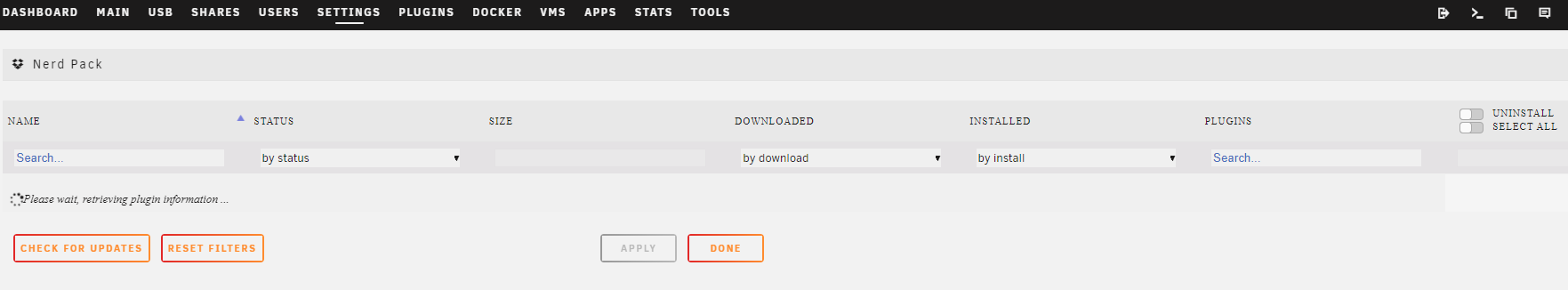

ACHTUNG: Nerd Pack User aufgepasst!
Bin unter Settings/User Preferences/Nerd Pack - da lädt nichts. Ist das die falsche Location? Was muss ich machen, um Python 2 zu installieren? Ein "wget https://raw.githubusercontent.com/UnRAIDES/unRAID-NerdTools/main/plugin/NerdTools.plg" (+Reboot) hat auch nichts gebracht. Edit: So schaut das bei mir aus:
