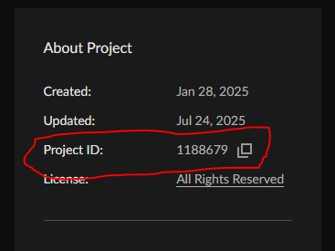

What mod are you trying to install? That mod does not exist. This is the number you have to set in -mods=
