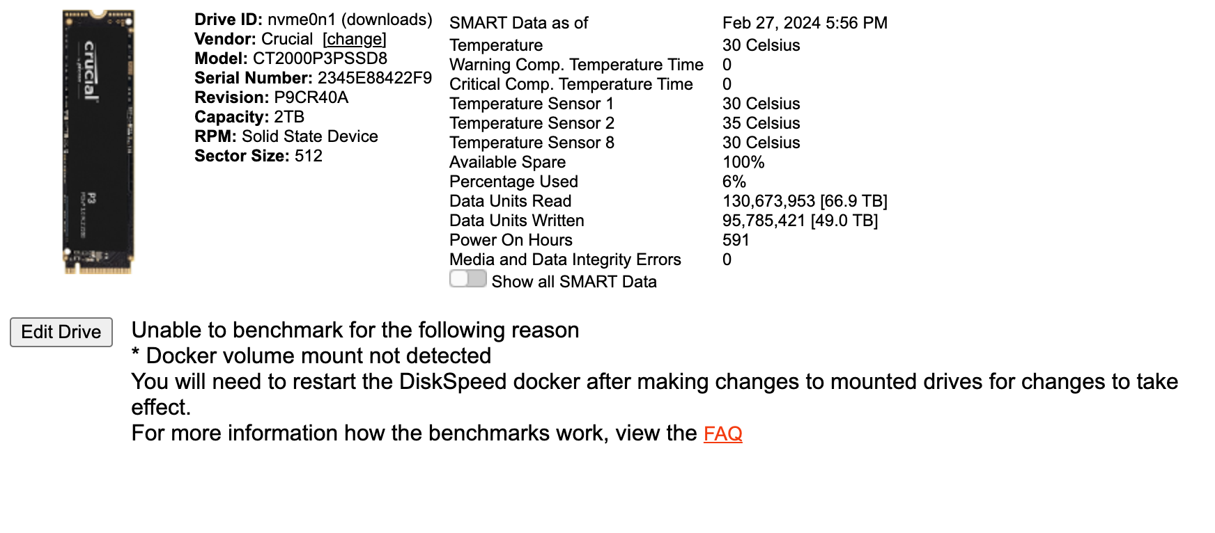

So, I mentioned this in another thread I made but was off-topic from the original question. Basically, I'm having appalling speeds with my dedicated nvme drive for downloads. I used to have both NVMEs as a BTRFS pool but decided to separate them, one for appdata another for downloads literally due to more space. Now I tried ASPM (L0+L1) on my motherboard to attempt to lower energy usage and found out that it was taking 30 minutes to unpack a download. Even SABNZBD's 10GB test took over a minute. Which for my setup isn't normal at all (5800x3d,32GB@3200,Gigabyte B550i). This is what the benchmark showed: And the devices with enabled ASPM: Device: 00:01.1 PCI bridge (AMD Starship/Matisse GPP Bridge) ASPM Level: L1 Enabled Device: 00:03.1 PCI bridge (AMD Starship/Matisse GPP Bridge) ASPM Level: L1 Enabled Device: 01:00.0 Non-Volatile memory controller (Micron/Crucial Technology NVMe PCIe SSD) -> Download NVME ASPM Level: L1 Enabled Device: 07:00.0 VGA compatible controller (NVIDIA GeForce GTX 1660 Ti) ASPM Level: L1 Enabled Device: 07:00.1 Audio device (NVIDIA High Definition Audio Controller) ASPM Level: L0s L1 Enabled Device: 07:00.2 USB controller (NVIDIA USB 3.1 Host Controller) ASPM Level: L1 Enabled Device: 07:00.3 Serial bus controller (NVIDIA USB Type-C UCSI Controller) ASPM Level: L1 Enabled So I decided to head into the bios and noticed that even shutting down took around 5 minutes. It used to take seconds. Went into the BIOS and turned off ASPM and now ASPM is reported as disabled except for Nvidia's Audio Controller apparently... regardless, ASPM is disabled for the drive: So I benchmarked again and got 800-900MB/s in folder speed. That's good news right? So I tried another 10GB test and unpacking took a little long, a few more seconds than I hoped, after that was done I decided to benchmark it again and got this: So... yeah back to square one. It seems to tank soon after boot looks like. And I can see there's no activity on the drive... I'm a bit at a loss here. No idea where to go from here?

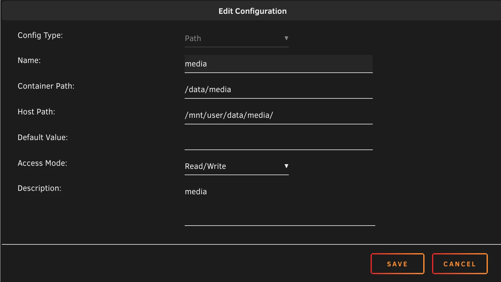

Update: Fixed the hardlinks by changing ownership to "nobody" instead of "root". No idea how that works but it fixed it. But, still having atrocious speeds with the download pool (nvme 1.4 pcie4) is it possible this is related to ASPM? Because I have ASPM L0 and L1 (only options are Disabled, L0, L1 or L0 and L1) in BIOS and this is the only drive from the 2 NVMe's that has it enabled: lspci -vv | awk '/^[0-9a-f]{2}:[0-9a-f]{2}\.[0-9a-f]/{dev=$0} /ASPM.*abled/{print dev; print}' Cleaned up: Device: 00:01.1 PCI bridge (AMD Starship/Matisse GPP Bridge) ASPM Level: L1 Enabled Device: 00:03.1 PCI bridge (AMD Starship/Matisse GPP Bridge) ASPM Level: L1 Enabled Device: 01:00.0 Non-Volatile memory controller (Micron/Crucial Technology NVMe PCIe SSD) ASPM Level: L1 Enabled Device: 07:00.0 VGA compatible controller (NVIDIA GeForce GTX 1660 Ti) ASPM Level: L1 Enabled Device: 07:00.1 Audio device (NVIDIA High Definition Audio Controller) ASPM Level: L0s L1 Enabled Device: 07:00.2 USB controller (NVIDIA USB 3.1 Host Controller) ASPM Level: L1 Enabled Device: 07:00.3 Serial bus controller (NVIDIA USB Type-C UCSI Controller) ASPM Level: L1 Enabled

Similar question here. Have 2 NVMe's and no idea how to mount them properly? How to even name the path variable?

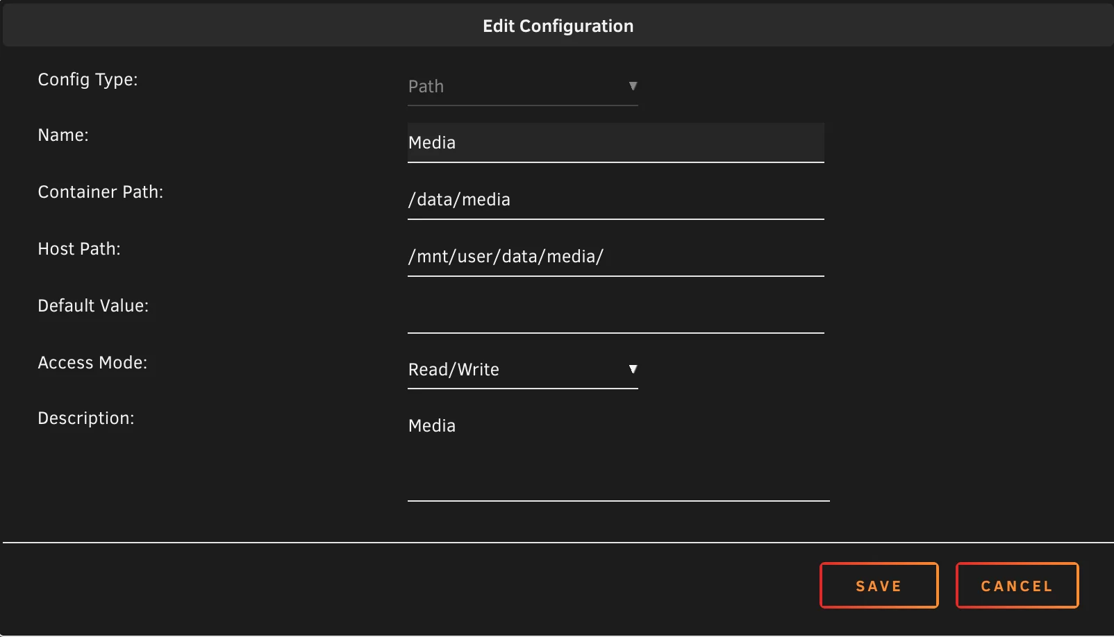

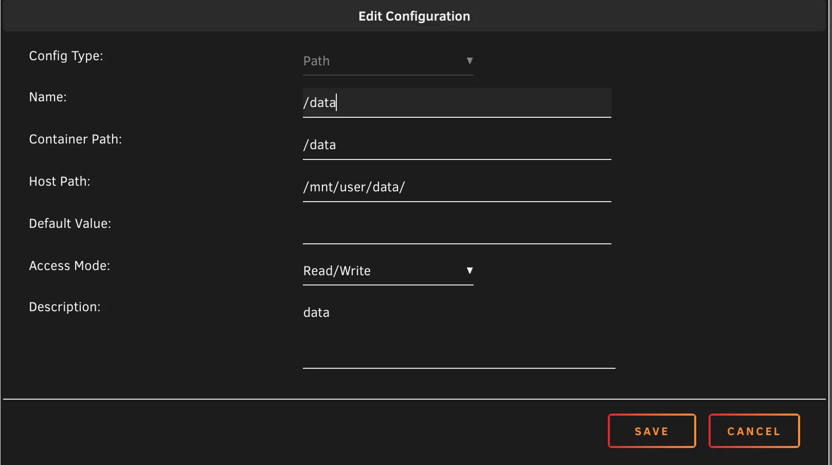

So I followed Trash Guides guide on setting up shares. All is setup correctly but it seems that somehow, radarr/sonarr importing from sabnzbd is taking absolute ages, meaning it's not hardlinking at all, even though the shares on all dockers and hierarchy is absolutely correct. I also confirmed that hardlinks is obviously set to Yes in Global Share Settings as that's unRAIDs default. Example how docker settings are setup, just like Trash Guides: bazarr sonarr plex I had this working before I nuked and rebuilt my unraid server from scratch. So I'm a bit confused on why this isn't working at the moment. Could it be because the usenet / torrents folders owner is root or something? I'm at a loss at the moment!
