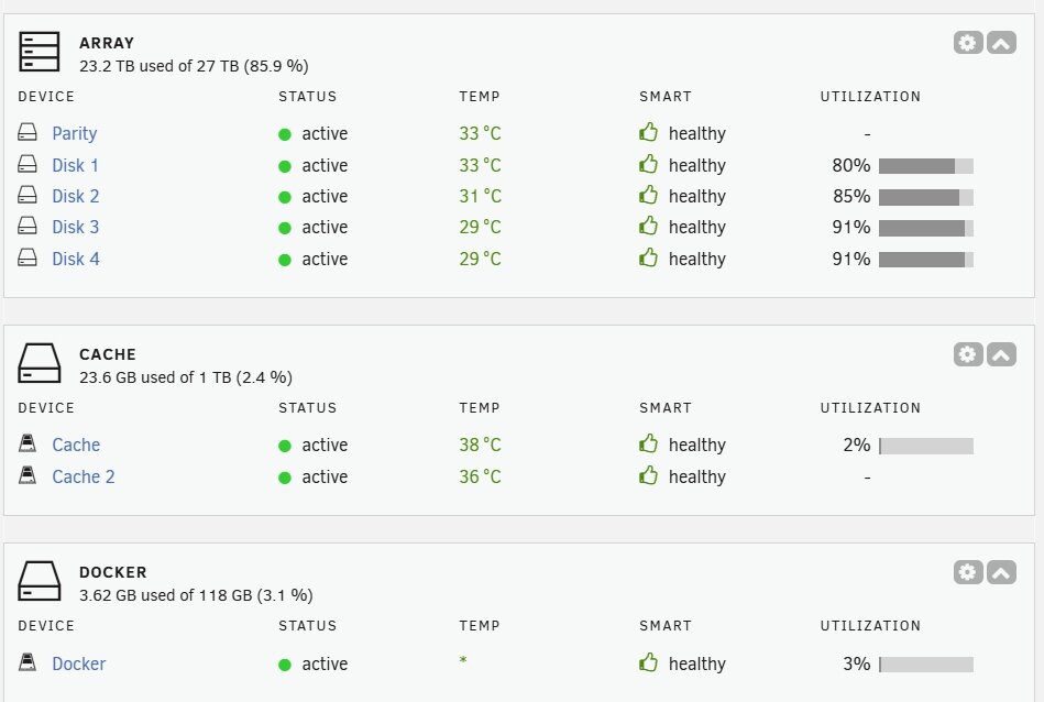

  16. I think I know some of the issues when I added a previously used 1TB Samsung_870 drive to my UnRaid server. Entrees in the picture 9, S6PTNMOT420498V-part2, 1, 13, 321. These are because the drive was not formatted or wiped prior to adding it. I also tried mounting it and it would not. . . . . I thought I could format it when it was installed. I removed it, but I noticed when it was inserted it gave its name as Docker2. I take it that is how Pool's work. Each added drive becomes incremented by number from the first device in that pool. Here is my goal. Add the Samsung 1TB drive and move everything from the Docker drive to it. THEN, shutdown, and remove the smaller OCZ 128GB drive and add my second 1TB used Samsung_870 drive. I was going to work off of this advice, "stop docker service, stop VM service if it's running. move the data from the docker pool to the cache pool, remove the docker pool and replace that disk with the new disk, move the data back to the docker pool." So do I need to format / wipe the 1TB Samsung drives first? Is my plan above the best way to go about doing this, or create a new pool?

  18. I've read a lot and watched some videos. Not finding a clear use case. Basically, I want to use my 1TB cache to speed up the copy process of going from my external usb drive to my new drive in my UnRaid server. Easy enough to setup, but I am missing some detail. A person wrote this below which I thought I understood. I created a share on the cache drive with the same name, as my shared folder TV Shows Volume 3. But it would not take since I realize it is the same name. "If i understand correctly, for shares that are cache-enabled, there is a folder on the cache drive with the same name as the share, and mover then moves from the cache folder (for example 'Movies') to the share ('Movies')?" I thought I could create a cache share, then use the mover to move the files to the array in a specific folder. There appears to be no option to tell the cache which folder I want the files moved to. Just the entire disk. Best I have come up with so far is to create a cache share called Transfer, and then move the files from it to the folder TV Shows Volume 3. I was hoping for something for specific and automatic? Is it not possible to have the cache drive be shared and move those files to a specific folder on the array?

  20. I want to replace a smaller SSD drive which holds my Dockers with a larger SSD drive. Is it as simple as shutting down the dockers, stopping the array, shutting down UnRaid and then switching out the small SSD drive and plugging in the larger one. (Smaller than Parity Drive). Then reboot, turn on the array and the Parity drive would rebuild it? Then turn back on the dockers?
