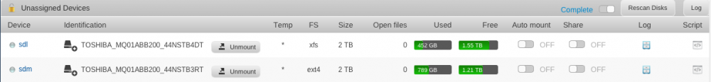

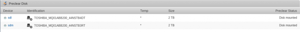

  3. I've been trying to find out why I'm having this problem. There are two error messages that each get added to the /var/log/preclear.disk.log file twice every ten seconds. The first is Line 273 of the Preclear.php file is $state = is_file($state_file) ? @parse_ini_file($state_file, true) : array(); and it looks as though it's failing when it tries to parse the state.ini file. My state.ini file (listed in my original post) appears to be truncated, but since I don't know how that file is created and maintained I can't figure out why. The second error message is and the relevant line of Preclear.php is if (array_key_exists($device, $state) && ! $reload) which is failing because the type of the parameter state returned by the previous line of code is Boolean, where an array is expected. I'm not a PHP coder so I don't really understand enough to be able to work out exactly what's going on, but if I shut down and remove my two unassigned disks the problem goes away because then neither the /var/state/preclear.disk/state.ini file nor the /var/log/preclear.disk.log file is created. If I put them back in again the /var/log/preclear.disk.log file grows steadily and I'll be out of log space in a couple of weeks. If the plugin gave a single error message and then exited gracefully I could live with it for the time being and possibly troubleshoot some more but as it is I'm going to have to uninstall it. Is there a bug in the plugin code or is there something about my two unassigned disks that causes the state.ini file to be truncated? I took the opportunity to update to unRAID 6.2.2 (and I'm using the latest 2016.09.27 version of the plugin) but, as I expected, it has had no effect on this problem. Thanks to anyone who can shed any light. EDIT: I tried uninstalling and reinstalling, after first making sure all my other plugins were up to date, to no avail. EDIT2: I haven't been able to resolve the problem so I've uninstalled the plugin again for now. If anyone has any suggestions or if the plugin is updated I'll reinstall and try again.
  4. Apologies. I've amended my post to include that information. EDIT: I should emphasise that the system is idle. I'm not running any preclears and haven't done for some months. I'm pretty convinced that the state.ini file is the cause of the problem. It looks wrong, with the extra newline at the top and the missing one at the bottom (line 8, as mentioned in the error message). And why is only /dev/sdl included? I would expect /dev/sdm to be there as well. What creates and maintains this file? Presumably the plugin itself does, given its pathname.
  5. I have a problem with one server in that it is running out of log space. My investigation reveals a rapidly growing /var/log/preclear.disk.log file. My other servers don't have this file at all, but they don't have any unassigned devices either. Whenever the Main window of the GUI is open, or when I go to Tools -> Preclear Disks I get four entries added to the aforementioned log file every ten seconds: If I navigate away to some other page, such as the Dashboard, the log file stops growing until I switch back to either the Main page or the Preclear Disk page. I have two (unassigned) disks in the affected server, both mounted using the Unassigned Devices plugin. The problem seems to be associated with the file called /var/state/preclear.disk/state.ini mentioned in the error messages. This file also only exists on the affected server and is absent from my others. root@Lapulapu:~# cat /var/state/preclear.disk/state.ini [/dev/disk/by-id/ata-TOSHIBA_MQ01ABB200_44NSTB4DT] ID_MODEL = "TOSHIBA_MQ01ABB200" ID_SERIAL_SHORT = "44NSTB4DT" FAMILY = "Toshiba 2.5" HDD MQ01ABB..." MODEL = "TOSHIBA MQ01ABB200" FIRMWARE = "AY000U" SIZE = 2000398934016root@Lapulapu:~# This is obviously a reference to my /dev/sdl (see attached screenshots). Does anyone know what the problem is and how to fix it? Should there be a newline at the end of the state.ini file? EDIT: unRAID version 6.2.1, plugin version 2016.09.27 (both latest stable)

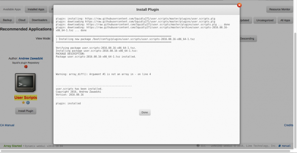

  6. There's nothing mentioned in syslog and I haven't noticed any problems. I just thought I'd mention it. Thanks... Fixed... It was just a spurious error message (now suppressed) that only displayed on 100% clean installs. And it didn't affect anything at all. No update of the plugin is required, as I just changed the .plg to suppress it on clean installs. Cool. Thanks Squid. I confirm that it was indeed a clean install.
  7. I installed the plugin onto unRAID 6.2.1 via Community Apps and noticed the following warning: There's nothing mentioned in syslog and I haven't noticed any problems. I just thought I'd mention it.
