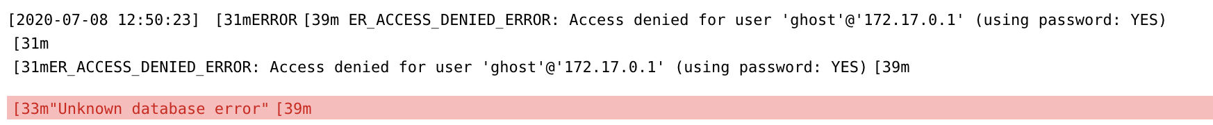

  4. Okay - my appdata folder has all the directories for ghost, but no actual files in there. I deleted everything and reinstalled the docker with version 3.22.1 and the folder reappeared, but no settings file. So seems like something deeper.
  5. So I tried going back a few versions and it still won't pick up the database__connection__host IP address. Not sure if it is unraid problem or what is going on...

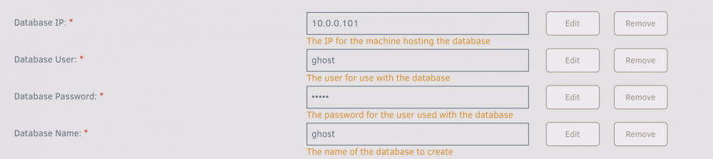

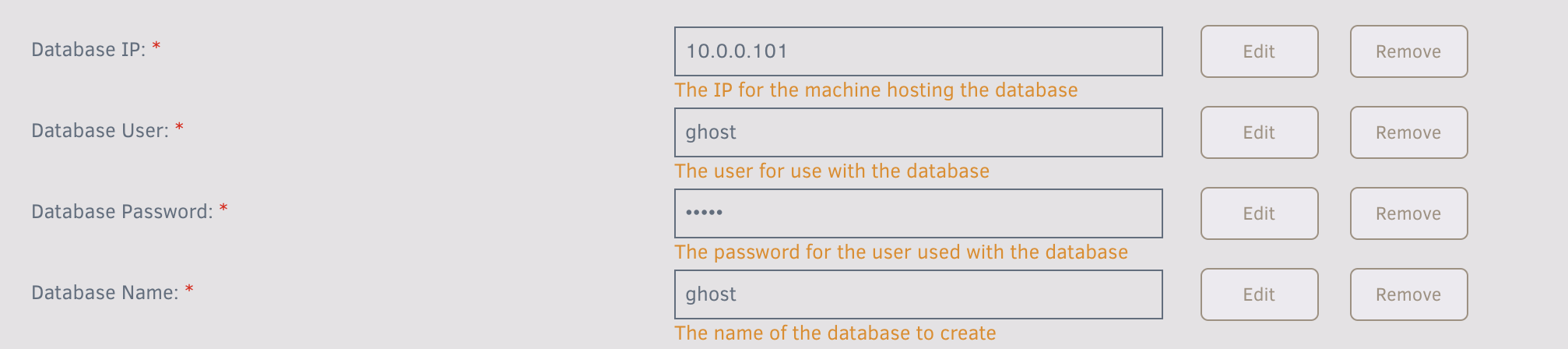

  6. Yeah - just to provide additional color you can see how it isn't taking the database IP address
  7. So Ghost is no longer recognizing the database IP variable you are passing to it. No idea what the correct ones are anymore. It just tries to connect to the IP address that ghost is sitting on instead of the MariaDB IP address that is entered.
